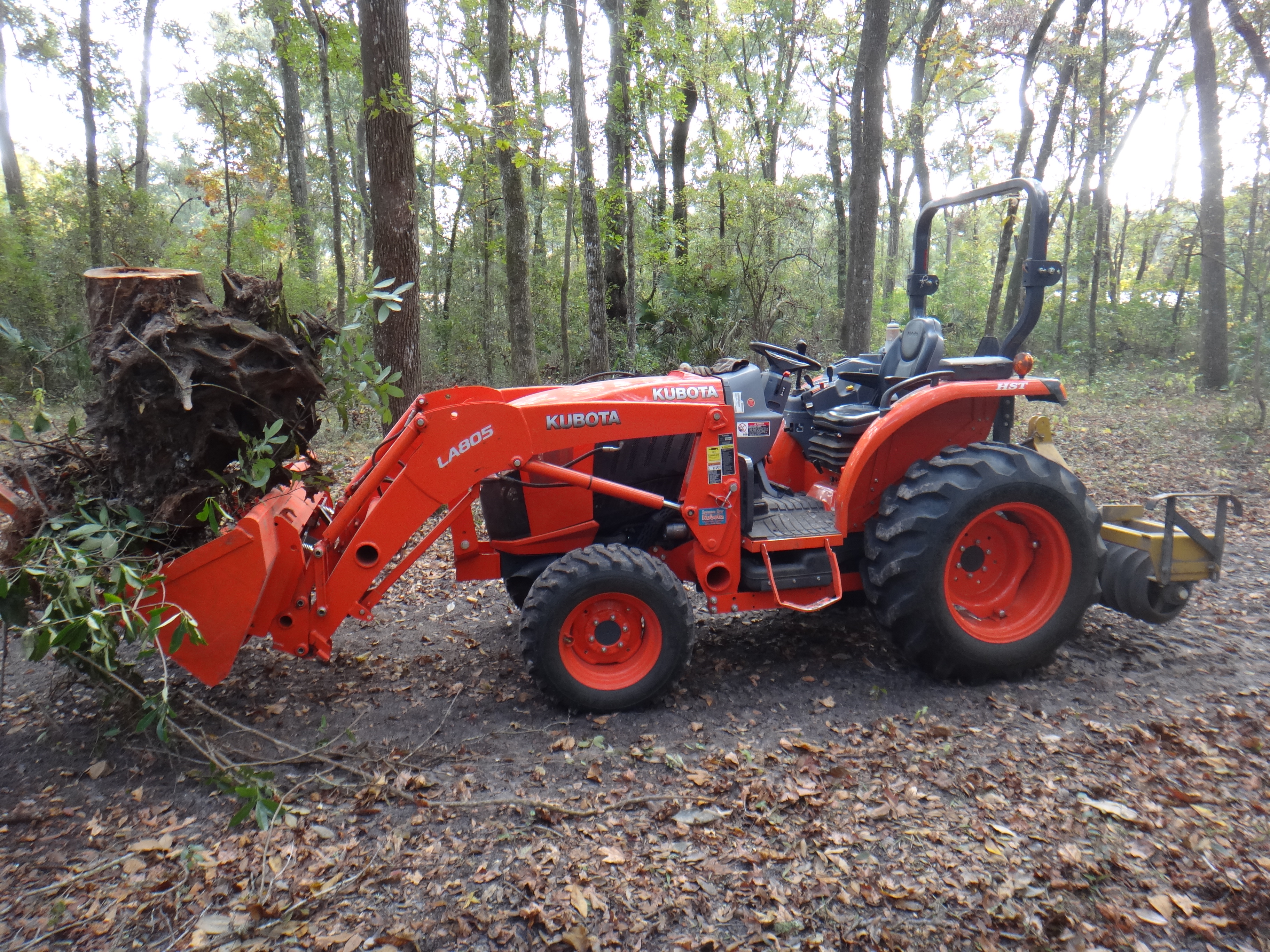

You will want an implement of 600-900 pounds mounted on the Three Point Hitch whenever you carry a heavy load in the FEL bucket, otherwise the rear wheels will lift off the ground. The Three Point Hitch counterbalance offsets weight of the FEL + FEL load, hanging off the front of the tractor.
My R4 tires are filled only with air. I routinely carry a 630 pound/60" ROBB or a 700 pound/60" ETA Cultipacker on the Three Point Hitch as counterbalance to the FEL.
