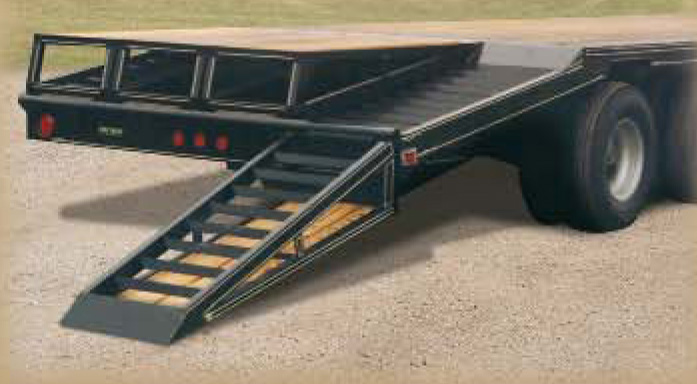

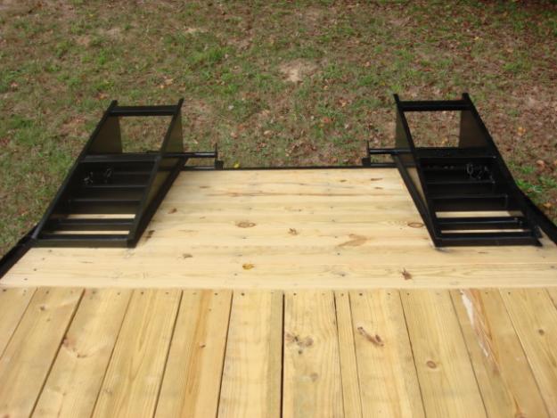

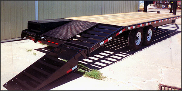

First choice: Tilt bed
Second choice: Stand-up ramps that can fold all the way forward leaving a flat, level bed full length for hauling non-wheeled stuff.
Here's a full width version:
Two smaller ramps:
Almost flat when folded:
Bruce
