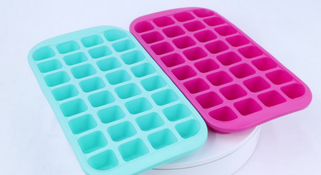

My work place has given up. It's dang expensive and they break from normal use within a year, than more so after the warranty.
What are we doing now? Dollar Tree ice trays. yep, cost less to repair and maintain.
These are silicone, very flexible and the cubes do not stick nor need to be banged out.
