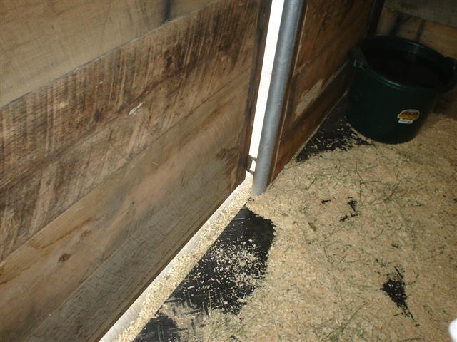

Hmmmmmm, I guess you haven't looked at the Priefert stall fronts or the knockoffs similar to them at TSC. I make custom stalls and I can't begin to compete with those prices. They hardly cover the cost of my materials. Of course I'm making these for customers and some of them have some expensive horses. I can't cut corners because cutting corners means usually corners cutting horses.
Sliders are the only way to go unless your doors can swing out into a paddock. If you're opening into an aisle then open swing doors present a hazard to equine and human traffic.
The biggest hazard that I see in most stall fronts is the guides for the sliding doors are exposed and horses can get a frog damaged in a heart beat.
I build my doors where they're secured in the open and closed positions without presenting a hazard.

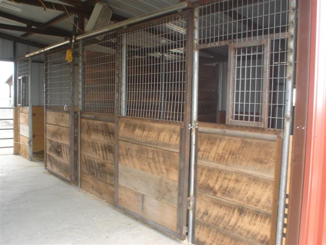

We converted a dairy barn to a horse barn, well still in progress. I ordered some stall kit parts from Woodstar Horse Stalls By Woodstar, Horse Stall Manufacturer, Equine Accessories, Horse Equipment.. I too was turned off by the cost, but then time and materials forced me to rethink building my own. So I did, and have been very, very pleased with the results.
The interesting thing for you would be that you could just order the doors or bars, or whatever piece you may need, to keep your costs inline or in budget.
Good luck.
-Mike Z.
Here is part of my finished project.
Stalls and Offices
