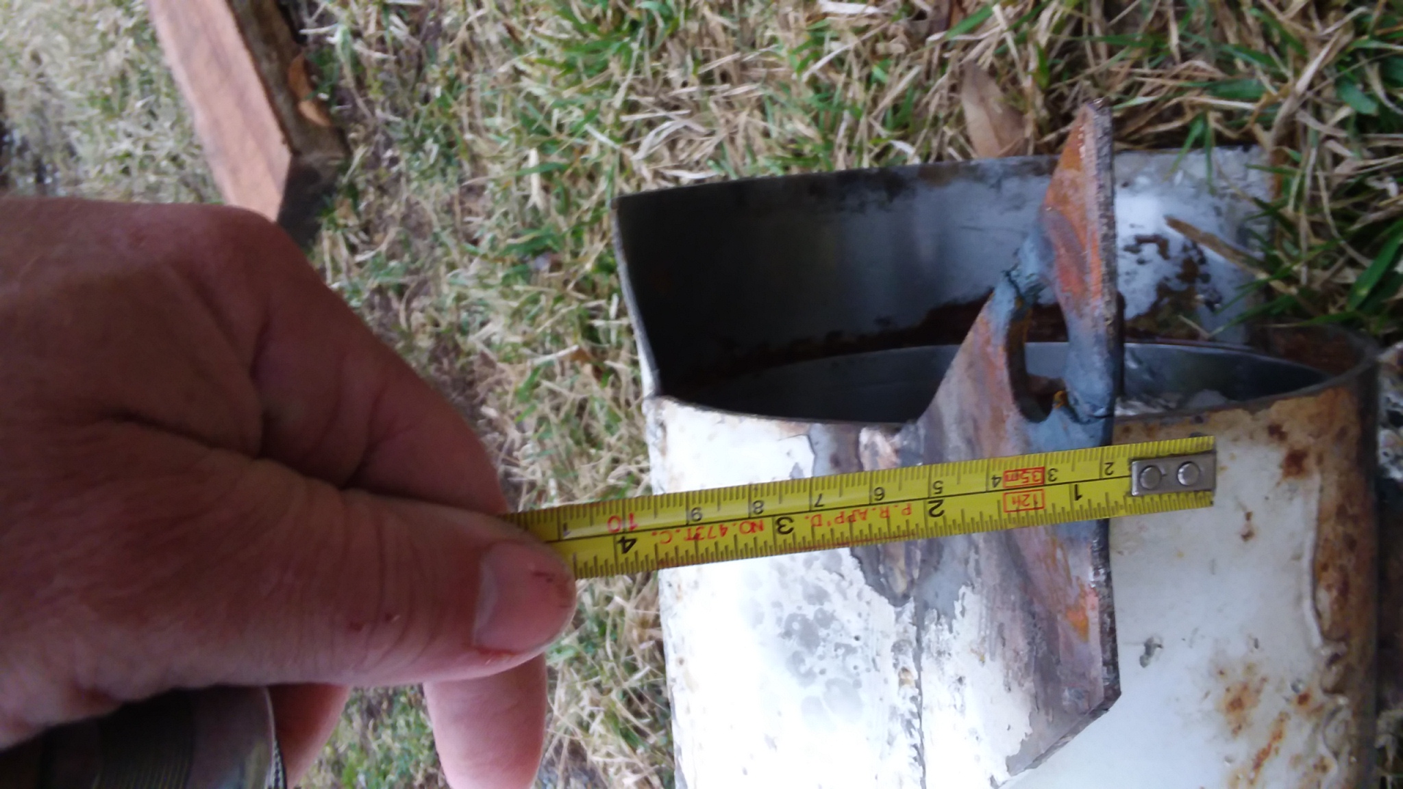

I am repairing some 1/8" stainless. It is an ear that holds the 7/8" pivot pin of a swinging auger on a fertilizer tender (so it will need to be fairly strong). The ear was damaged when the pin fell out while driving down the road and the auger landed on the ear and folded it over. I did my best to straighten it, but it needs some serious reinforcing and the hole is out of round.
My two options/ideas are:
1. Buy an extra thick 7/8" id stainless steel washer and weld it on/over the hole to tie everything together. I will have to order such a specialized part.
2. Buy a regular steel 7/8" id washer (easy to buy locally) and weld it around the hole.
Any advice or better ideas? I have an AC/DC stick welder. Would I use a standard stainless steel repair welding rod for either of the two above options? 20180219_070225.jpg20180219_070208.jpg

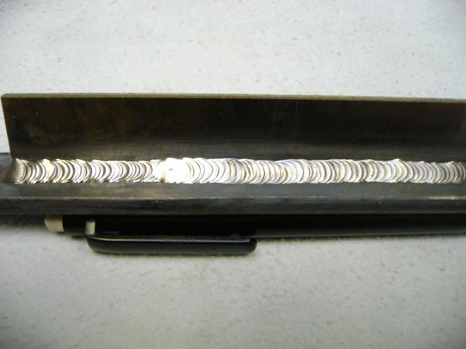

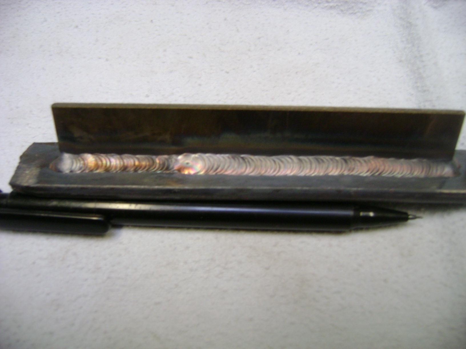

KYErik here is a picture of 309 stainless steel rod on mild steel.
If you are worried about the mild steel to stainless steel? just weld all the way around the mild steel, then paint the mild steel. Mild steel is welded to stainless steel every day.

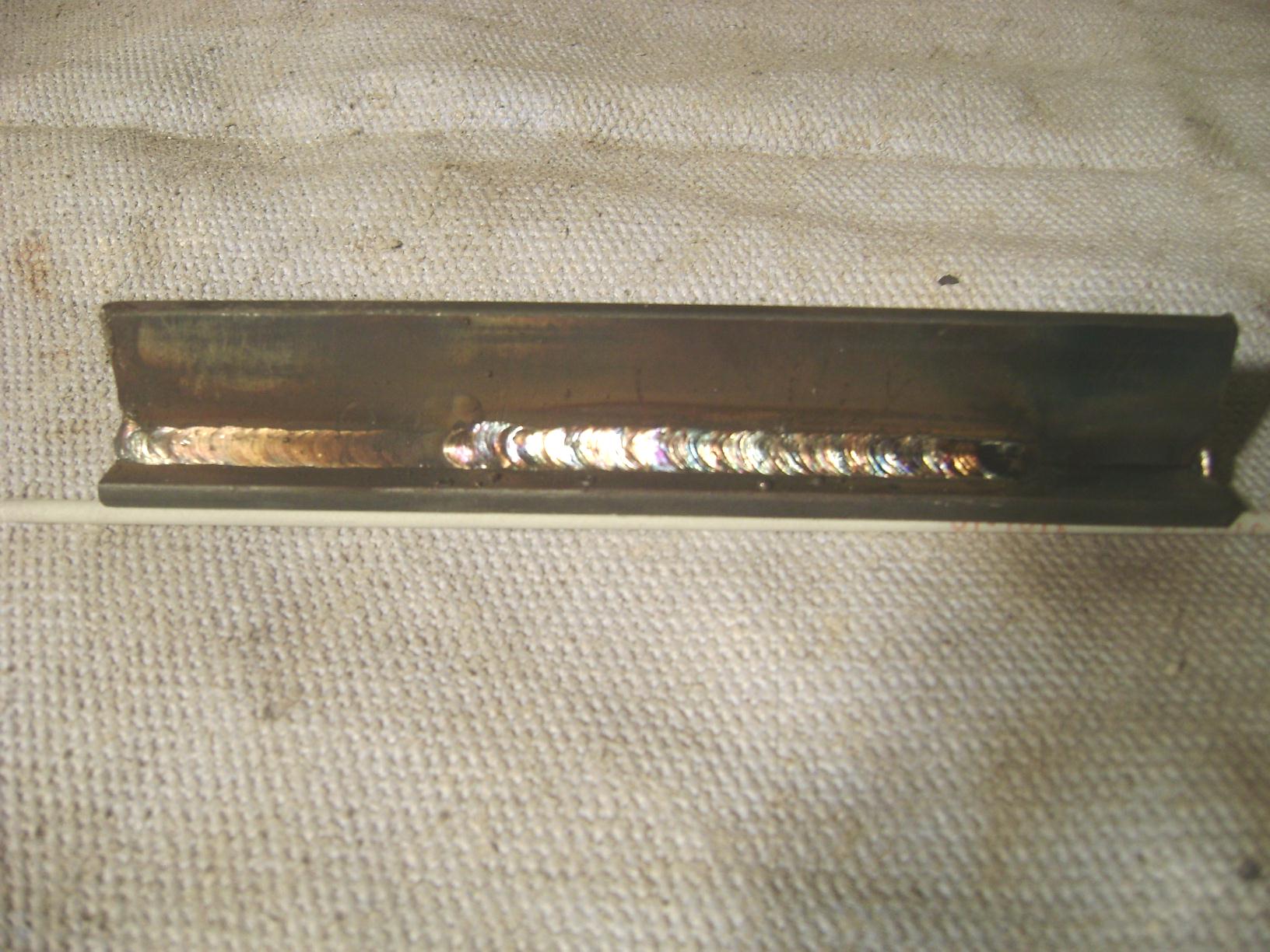

Here is a Tig weld, stainless steel on top, to mild steel on the bottom.
