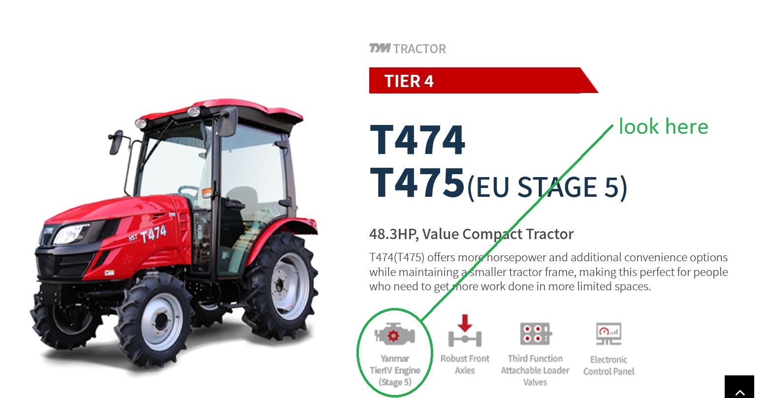

Surfing the Web I found on the Tym corporate website a very interesting information.
If it is confirmed it means that the new stage 5 Tym T475 will not have a Kukje engine but a Yanmar engine.
Look at this screen shot :
You will find this info here :
http://www.tym.co.kr/?skin_code=base-tym_en&PageAccess=main/product-t474

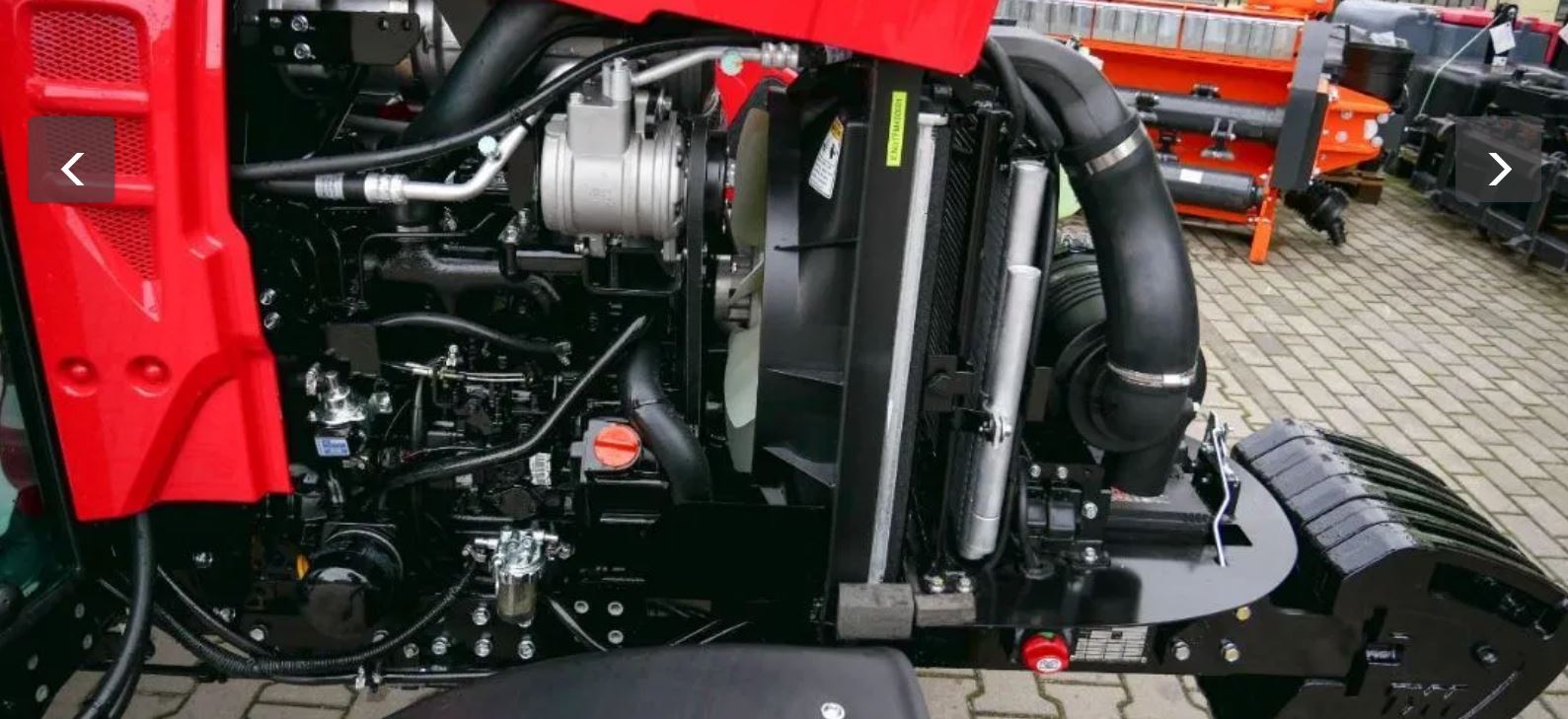

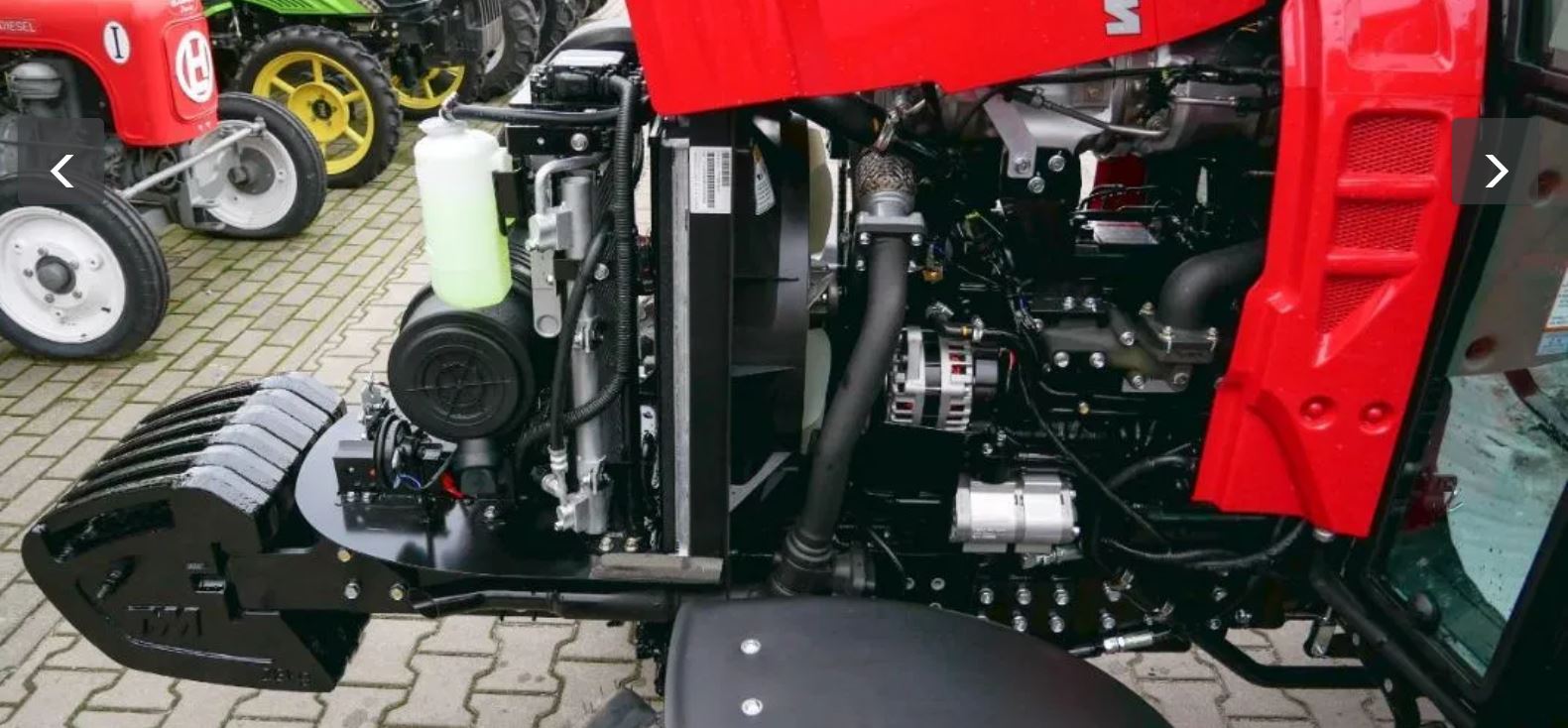

Yanmar and Kukje experts, could you confirm if the engine we see on the following pictures is Yanmar or Kukje ?
TYMNorsky, we need your help ! Is this engine the same you have on your T474 or is it really different ?

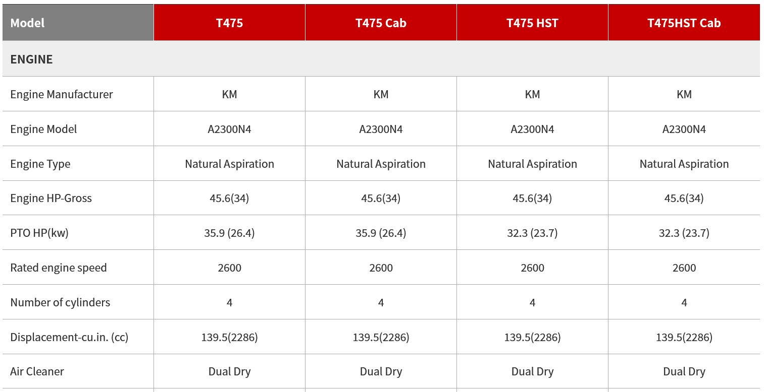

It sounds very strange as, on the same website, we get the specifications for these tractors and it says that the T475 have the Kukje engine A2300N4 :
Obviously, the webdesigner made a mistake .
But where and which one ?

Not exactly an expert, but from the injection pump setup (throttle cable, injection lines, etc) on the pictures, I say it's a Kukje.
But then again, not sure how the equivalent HP Yanmar engine looks like.

I was thinking a bit more about this and the photo is definitely the Kukje engine. Note the butterfly valve on the exhaust to increase the exhaust temps to do the regen process. Almost like an engine brake.
The Yanmar engines are Common rail and use the extra injection at the DPF for the regen process.
The TYM T454 uses the Yanmar 4TNV88-CC engine, which is common rail.

I think you are right.
This is a Kukje engine.
If I read the official powerpoint presentation of Stage 5 Tym T475 in Eastern Europe here :
https://www.agroservisop.cz/userdata/articles/2/prezentace_official_2020_tym.pdf
I realize that Tym T475 does have the AN2300N4 stage 5 Kukje engine.
As a consequence, the mention of Yanmar engine, for this tractor, on TYM corporate website, is a webdesigner's mistake.

Ha Pedro, yes, I see now this buttefly valve.
I did'nt know it was specific of Kukje engines !
