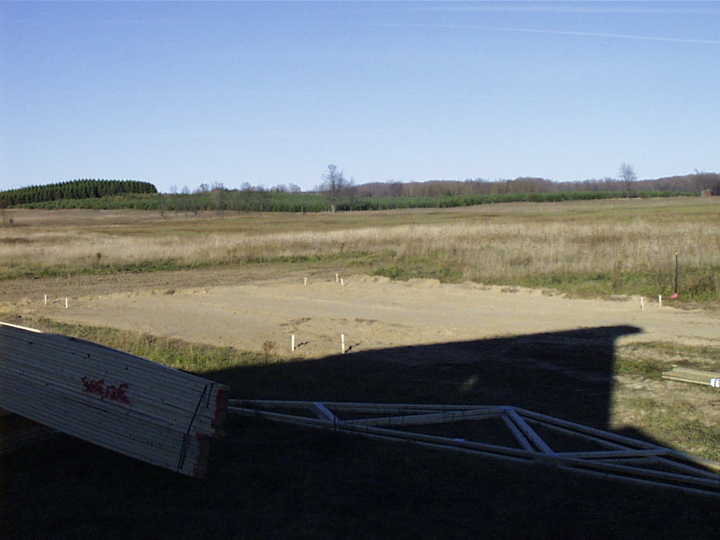

Nov 13, 2001 / Stage 2 #1 S StoneHeartFarm Veteran Member Joined May 24, 2001 Messages 1,307 Location Michigan Tractor Kubota L3650/AC B210 Mysterious diggin in the back yard. Day 1 Attachments 35-82710-house110.JPG 119.4 KB · Views: 150

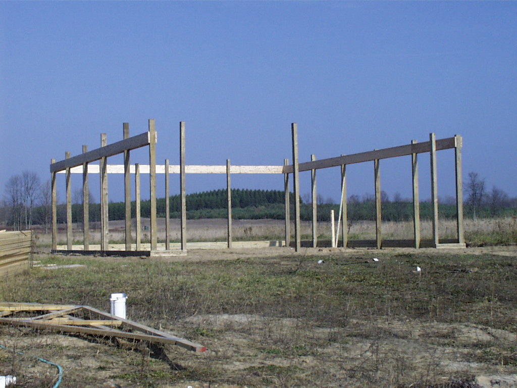

Nov 13, 2001 / Stage 2 Thread Starter #2 OP S StoneHeartFarm Veteran Member Joined May 24, 2001 Messages 1,307 Location Michigan Tractor Kubota L3650/AC B210 Strange trees Day 2 Attachments 35-82712-house112.JPG 160.9 KB · Views: 143
Nov 13, 2001 / Stage 2 #3 M MikePA Super Moderator Joined Apr 25, 2001 Messages 12,302 Location PA Tractor Had TC25D, now JD X310 What's the dimension of the lumber in the picture? Also, how deep are they planted and how were they planted?

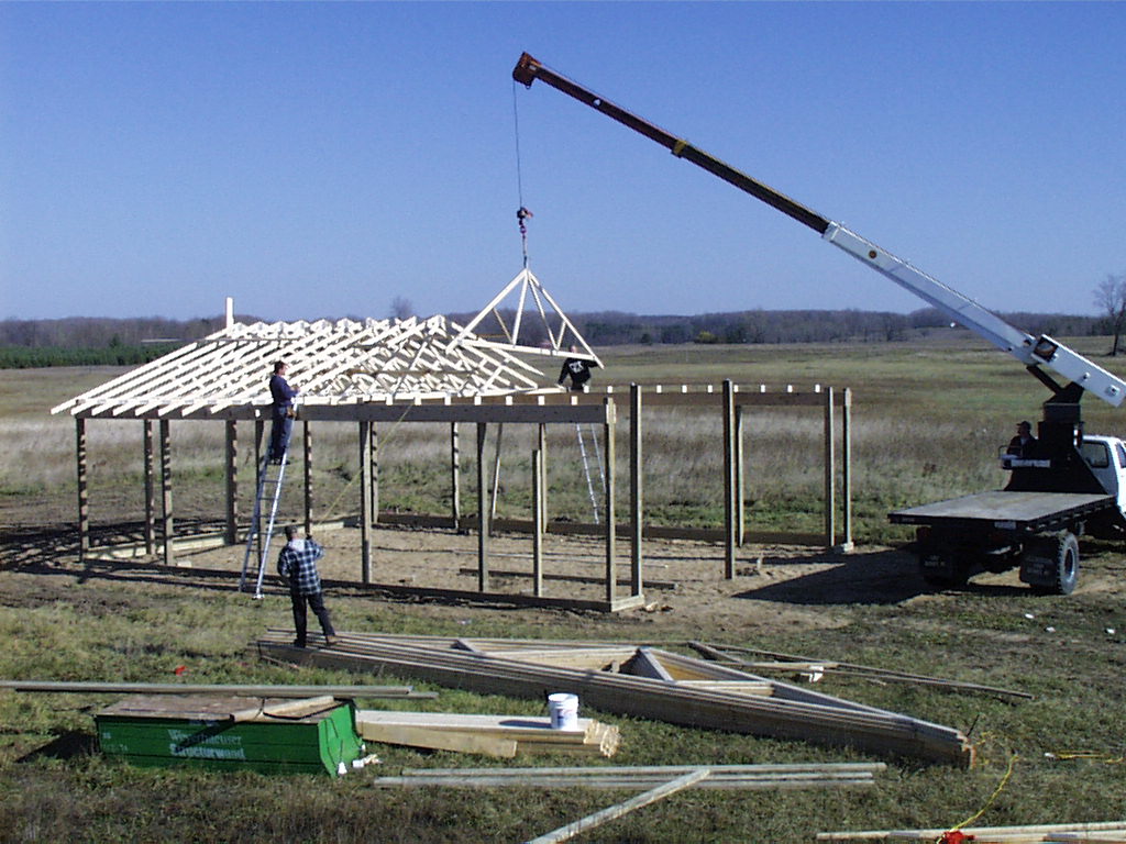

Nov 13, 2001 / Stage 2 Thread Starter #4 OP S StoneHeartFarm Veteran Member Joined May 24, 2001 Messages 1,307 Location Michigan Tractor Kubota L3650/AC B210 Ooops, them r trusses. day 3 Attachments 35-82721-house114.JPG 161 KB · Views: 125

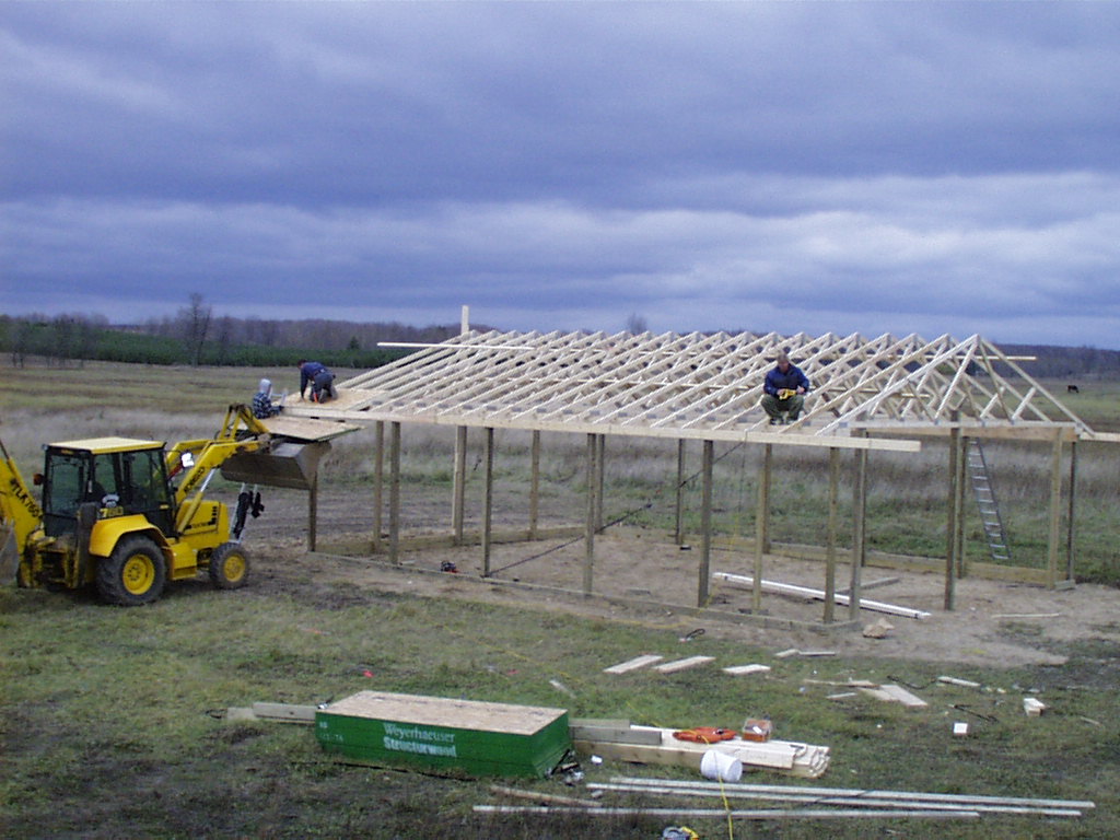

Nov 13, 2001 / Stage 2 Thread Starter #5 OP S StoneHeartFarm Veteran Member Joined May 24, 2001 Messages 1,307 Location Michigan Tractor Kubota L3650/AC B210 midway through day 3 Attachments 35-82722-house116.JPG 169.5 KB · Views: 135

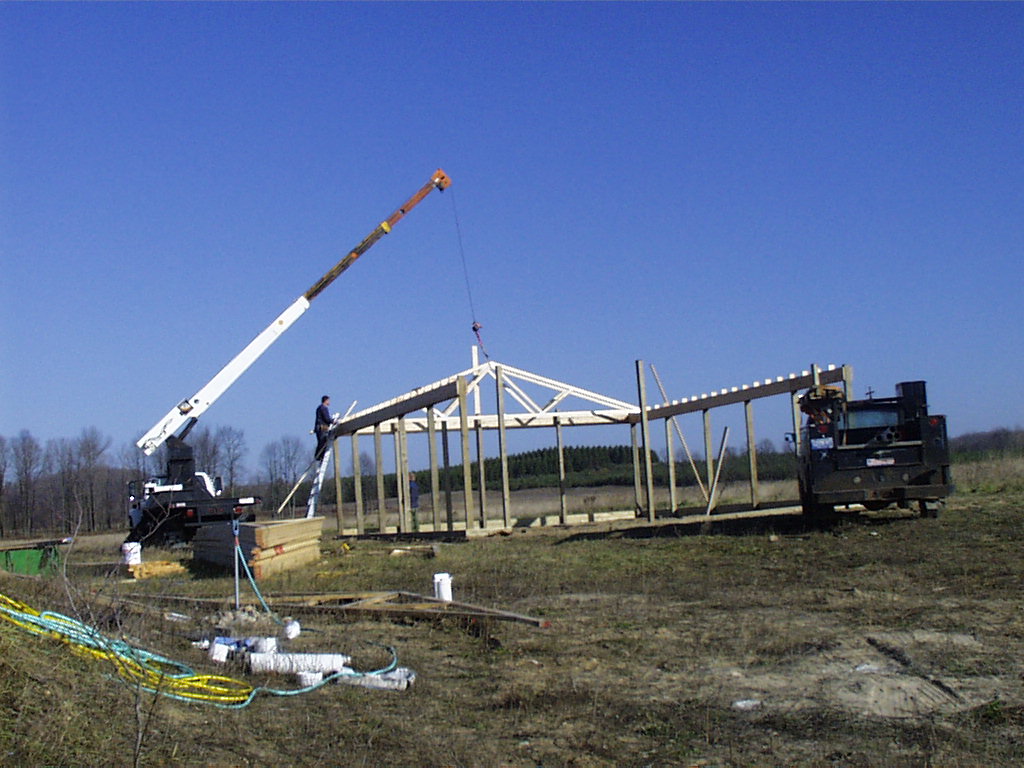

Nov 13, 2001 / Stage 2 Thread Starter #6 OP S StoneHeartFarm Veteran Member Joined May 24, 2001 Messages 1,307 Location Michigan Tractor Kubota L3650/AC B210 start of day 4 Attachments 35-82724-house118.JPG 162.1 KB · Views: 138
Nov 13, 2001 / Stage 2 Thread Starter #7 OP S StoneHeartFarm Veteran Member Joined May 24, 2001 Messages 1,307 Location Michigan Tractor Kubota L3650/AC B210 Mike Uprights are 4x6 w/2x10 top bands. Buried 4' on most. Three had to be cut off, with the longest scrap being about 10". Trusses are 30' which is why the boom truck was employed. Steve
Nov 13, 2001 / Stage 2 #8 M MikePA Super Moderator Joined Apr 25, 2001 Messages 12,302 Location PA Tractor Had TC25D, now JD X310 4" x 6" x ??'
Nov 13, 2001 / Stage 2 Thread Starter #9 OP S StoneHeartFarm Veteran Member Joined May 24, 2001 Messages 1,307 Location Michigan Tractor Kubota L3650/AC B210 Ooops! 4x6x14'. SHF
Nov 13, 2001 / Stage 2 #10 M MikePA Super Moderator Joined Apr 25, 2001 Messages 12,302 Location PA Tractor Had TC25D, now JD X310 At 14', I guess they used a PHD, placed a concrete cookie in the bottom and tamped?
