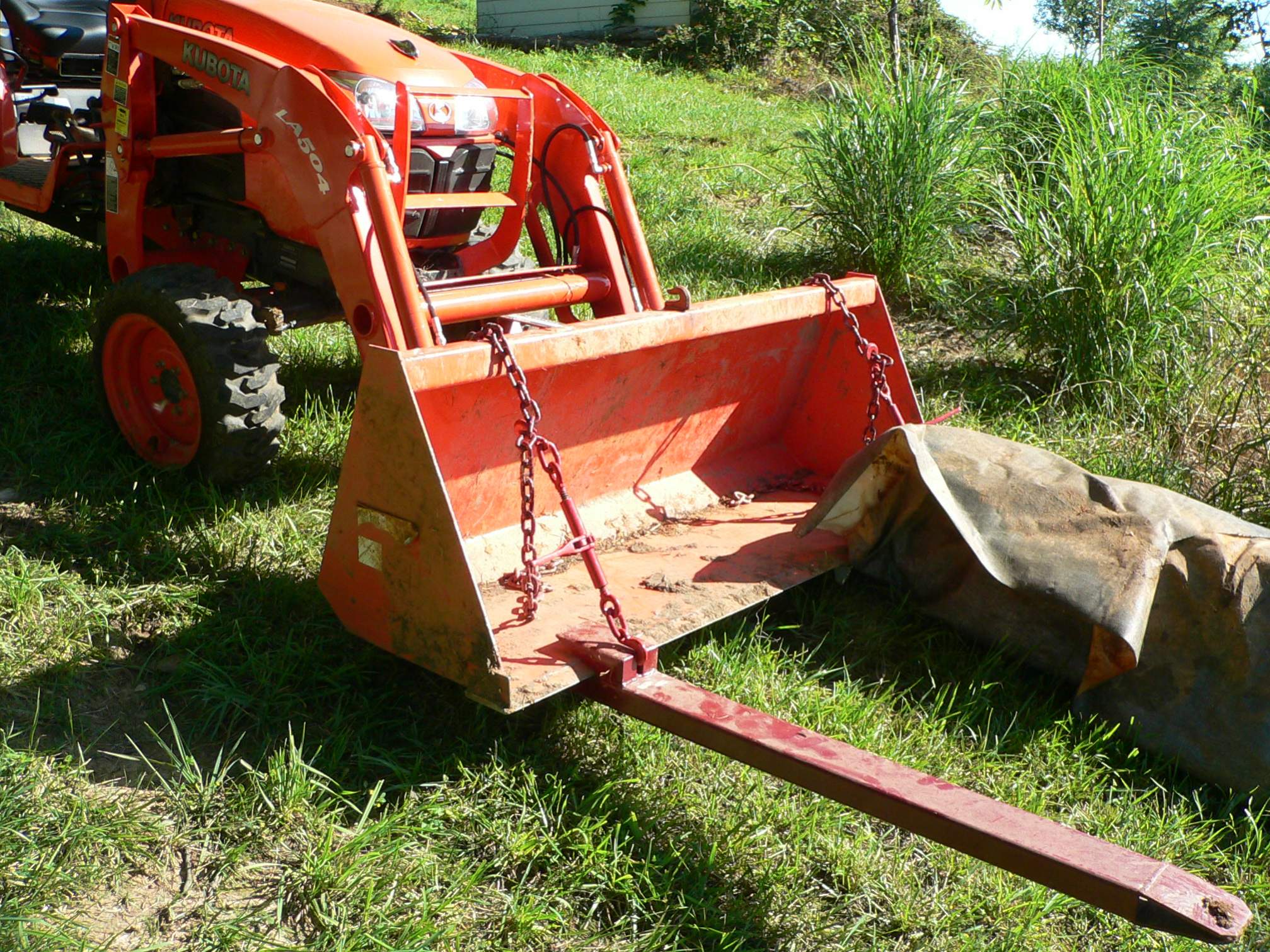

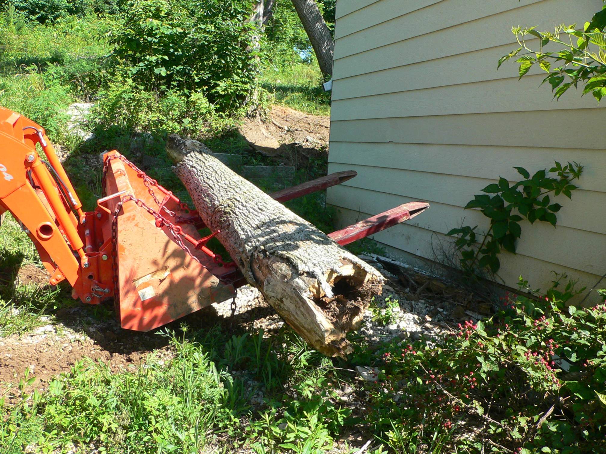

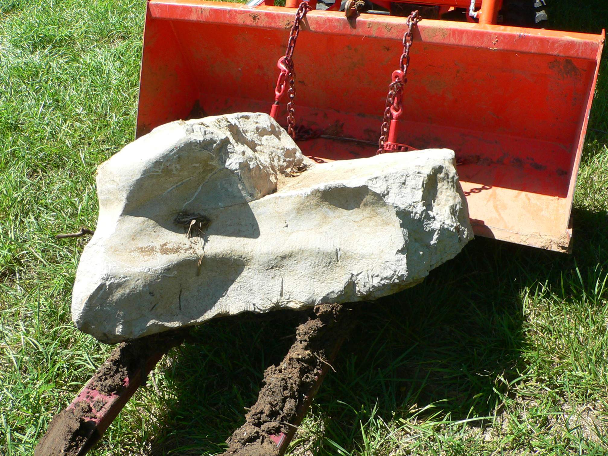

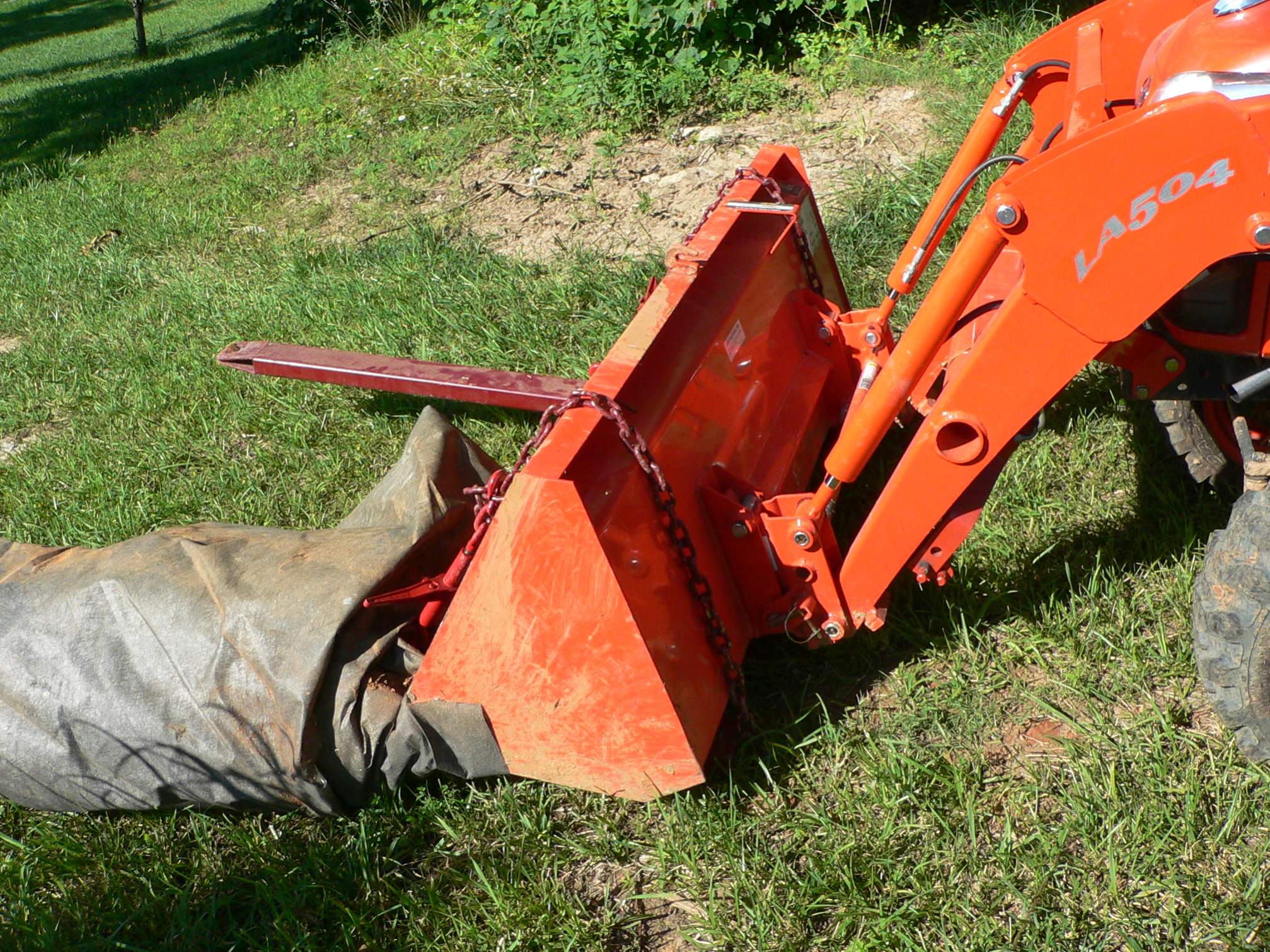

I bought these from Barlows. Your local dealers should have them or access to them. These apply the stress around the bucket instead of in a smaller area per my Machinist brother in law, like the clamp on ones. I like the concept and installing idea of the clamp on ones but after considering his input I'm sticking with what I have. I believe these were also less money than the clamp on ones.
PS To me the Forks are a have to have item. Don't use alot but when they are needed they are irreplaceable.
