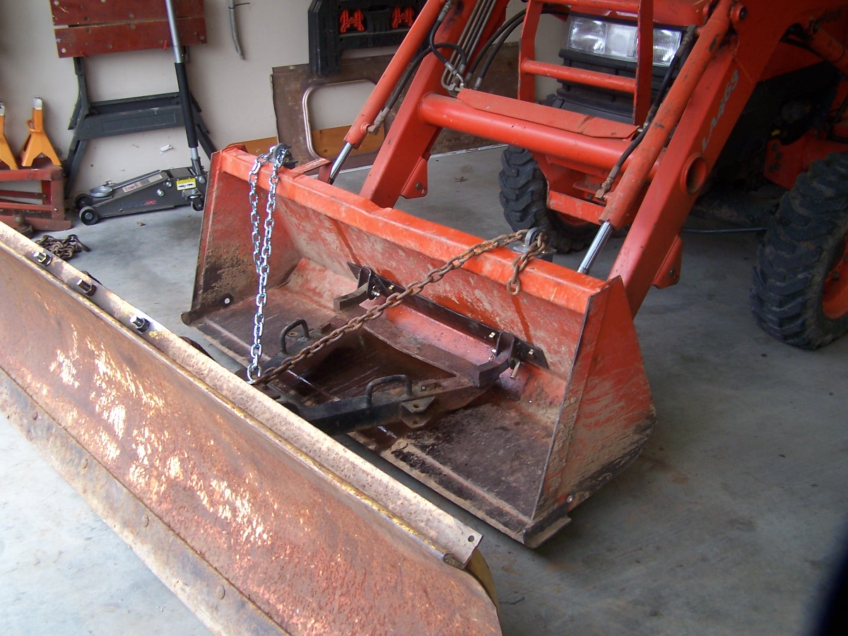

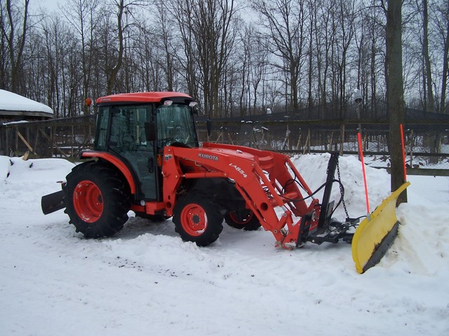

Here is my setup, if I put my loader in float, the bucket, along with the plow, would both be on the ground. If the chain(s) were replaced with a solid link of some sort, I think the plow would be the only thing to touch the ground. The length of the link would be important.
The plow arms would stay parallel to the ground, any pivoting would have to take place within the plow frame.

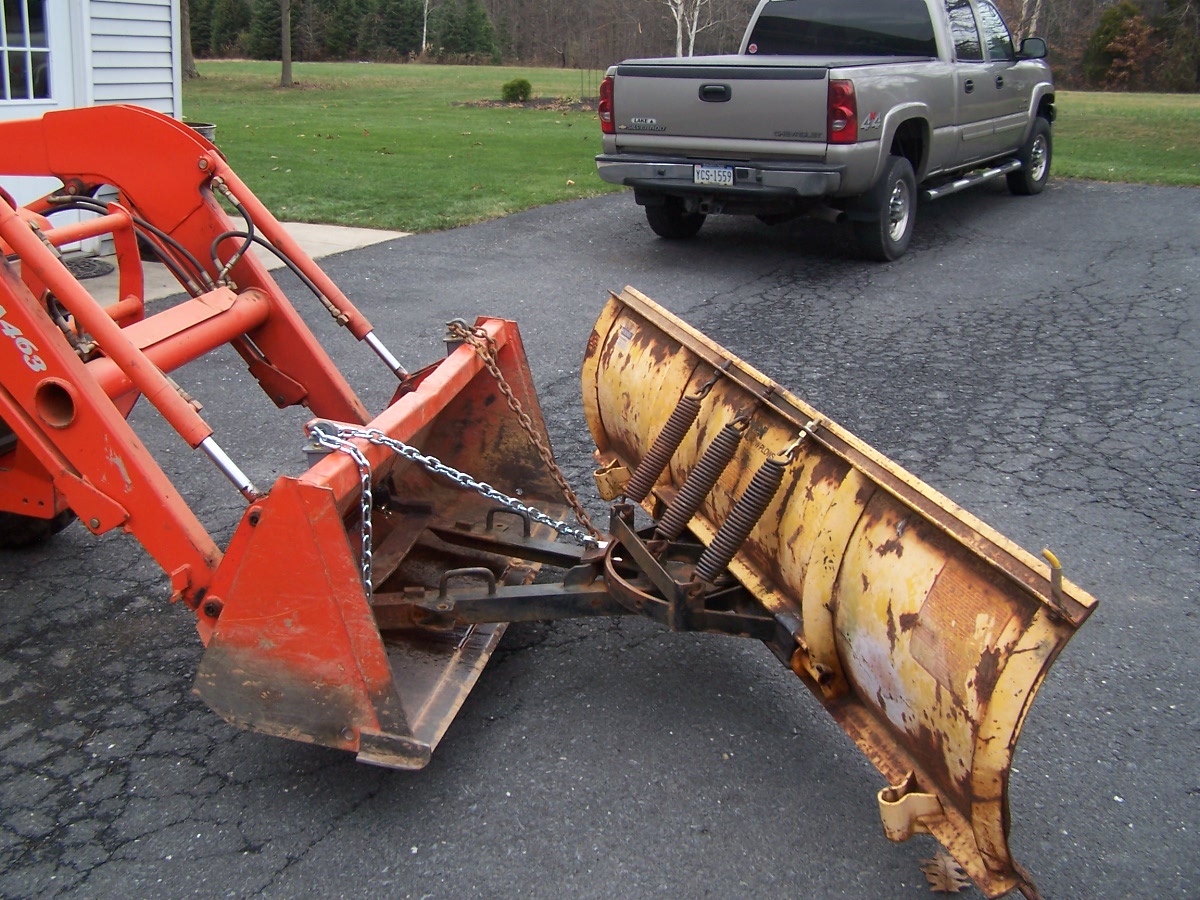

You have it right;float the plow not the FEL.Chain of course limits the down but not the "up".Lower the FEL until the plow contacts the surface and it will follow the contours of the ground with out the weight of the FEL.
I have used mine for five years on mostly gravel and it works fine.
Note:You may want to consider a "cross-over relief" valve also.I am adding one to mine as soon as my fittings arrive.I blew a line on the tractor the last time I plowed.Funny I went three years with this set-up without a problem;things happen.
