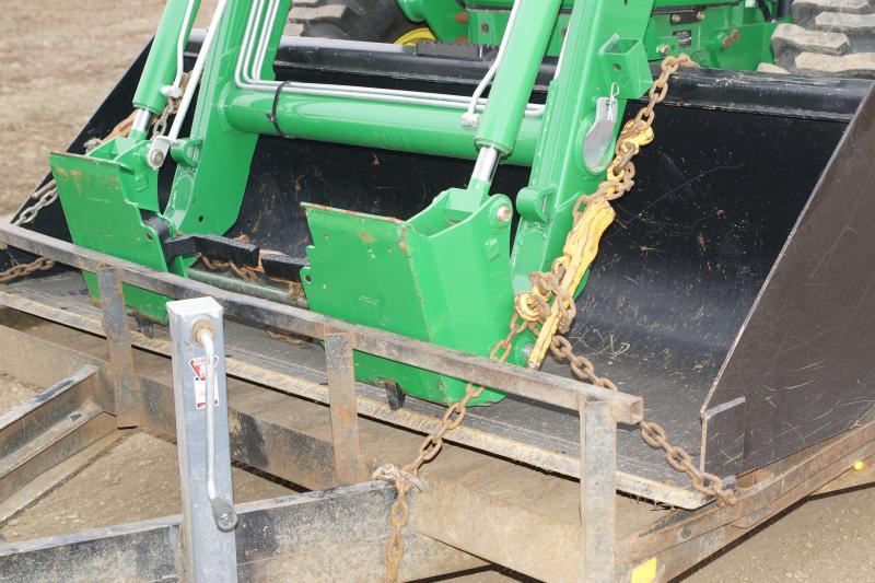

Is this a factory JD ssqa? All the JD ones I've seen have a small diameter timing bar, between the two pads to keep them in sync, the bar is held in place by bolts or pins. Did you buy yours used, if so maybe the PO broke, bent, or lost the bar? Here is a pic of a small JD loader you can see the silver bar between the two plates.

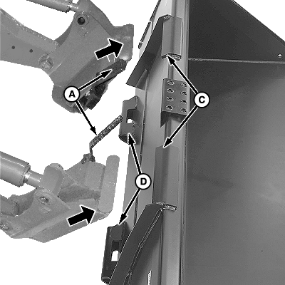

The timing bar at the bottom is a common axis the top of the pads are free to rotate as they want.
This is from the manual and doesn't even have the timing bar in this one.

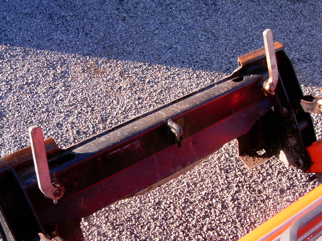

Heres mine on a 35 HP tractor.
Mine is heavy enough between the latch arms I welded in a hook and use it for lifting.

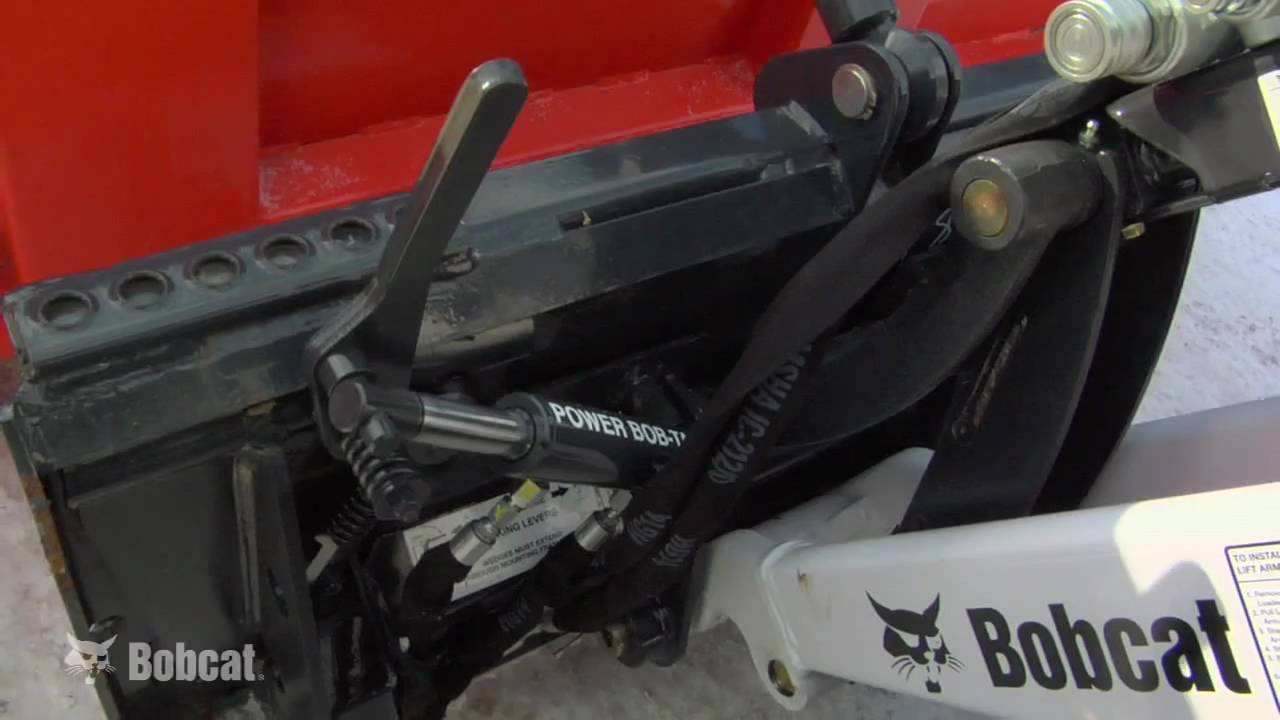

This is how Bobcat did it on the Toolcat, two cylinders with very little slop because they can't move out of line, like your handles.

Bobcat had to use two because one wouldn't clear the center linkage, I was just showing how it attached to the handle.
