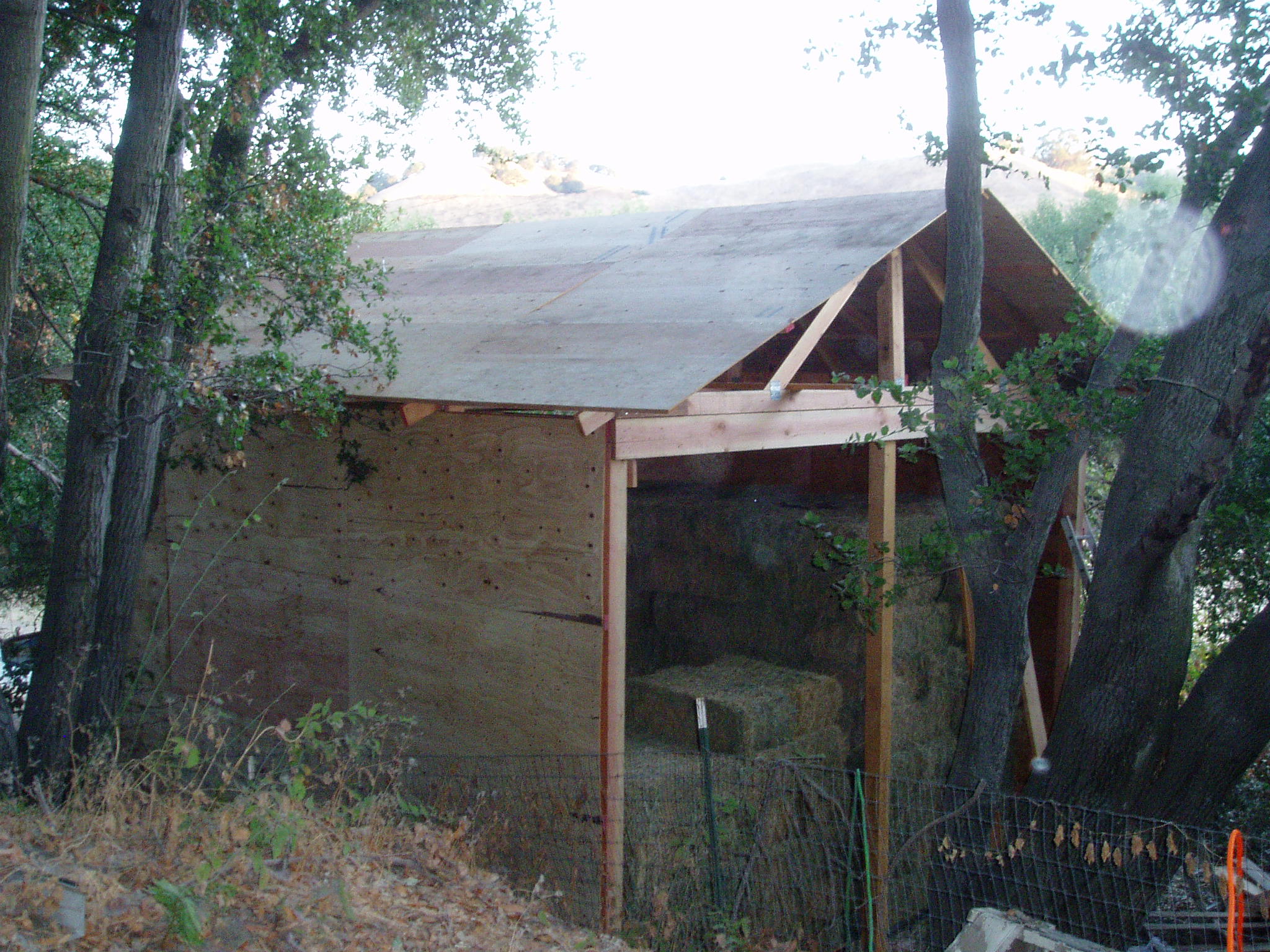

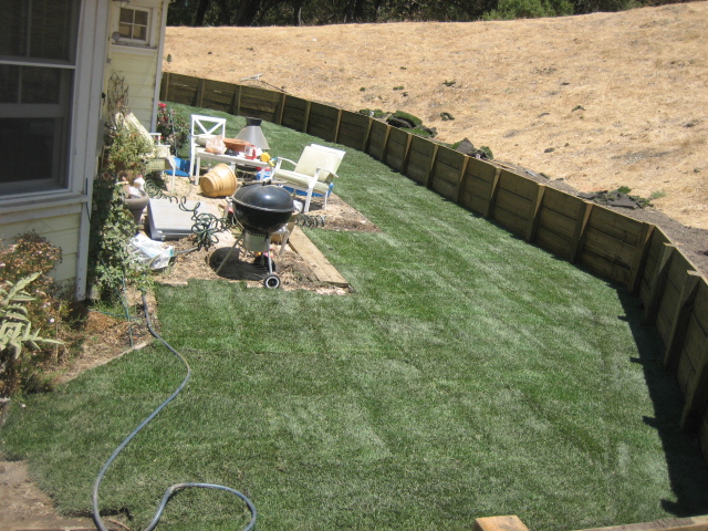

Boy, thanks for the warm welcome. My wife and I have thirteen acres in California in the East Bay area. I keep a few horses there and only have a sub compact kubota so tractor project are relatively small. This summer was a 20 by 20 pole barn for hay storage which is how I found this site and I have really enjoyed reading about everyones projects. The barn is getting there and not half as nice as some of the other on this site but it will keep the hay dry. The other picture is the extended back yard retaining wall for my wifes lawn(even though our well hasn't pumped a thing for the last year or so. The top of the wall is filled with some decent soil for planting. We are plagued with clay soil that won't grow anything. The place is a hillside so all project need some grading. I'm blessed to have a neighbor with a D6. He is line for my next project of clearing out the under brush (coyote brush and poison oak) and cutting a winding road to the top of the hill so I can keep the clreaing project going and maybe put in a round pen in the woods some day. I have a 15 month old daughter so projects go slowly around here. I cowboy for fun and work for the electric company during the week as a mechanical engineer. Keep on posting I'm learning a lot from reading about everyones projects.
