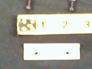

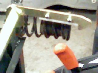

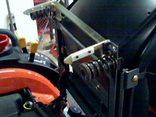

I had a problem with my seat latch squeaking it was quite annoying. I tried greasing it and this would quiet it down for about 20 to 40 minutes. So then I tried an industrial Teflon tape this would last a couple of days and then wear through. I needed a permanent fix and this is what I came up with. I took a peace flat Delren and machined it to L shape, then bolted it to the latch with 2, 4mm bolts and lock nuts. This took care of the problem now I can mow in peace while listening to my favorite musical trio. Here is some pics of the latch.

Can you repost the picture?
Nevermind. On my phone the pictures are not there but on my computer they are.
