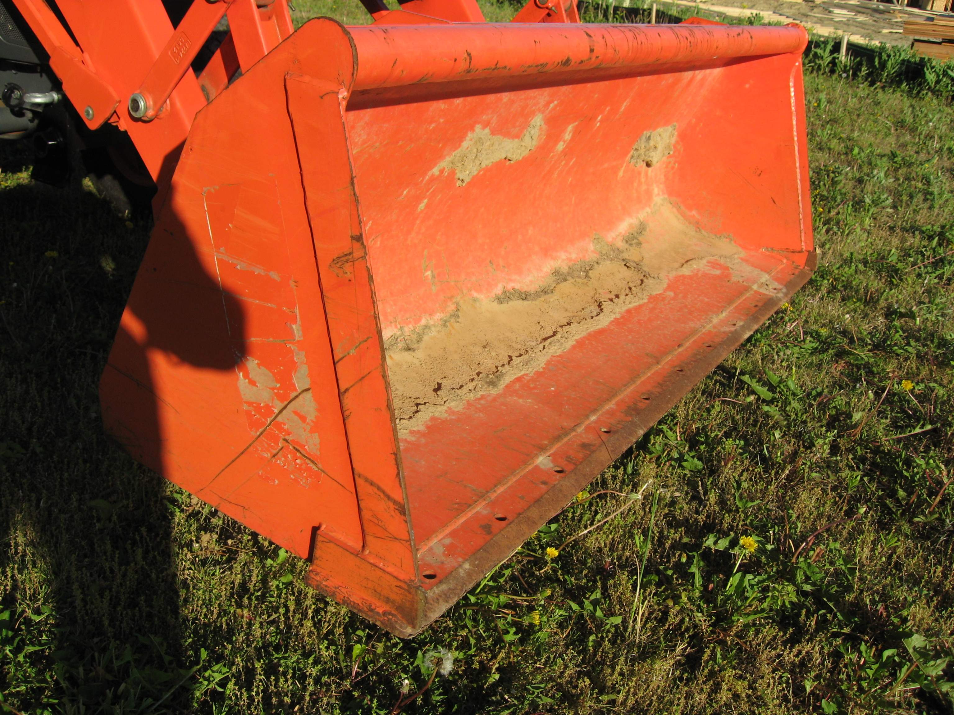

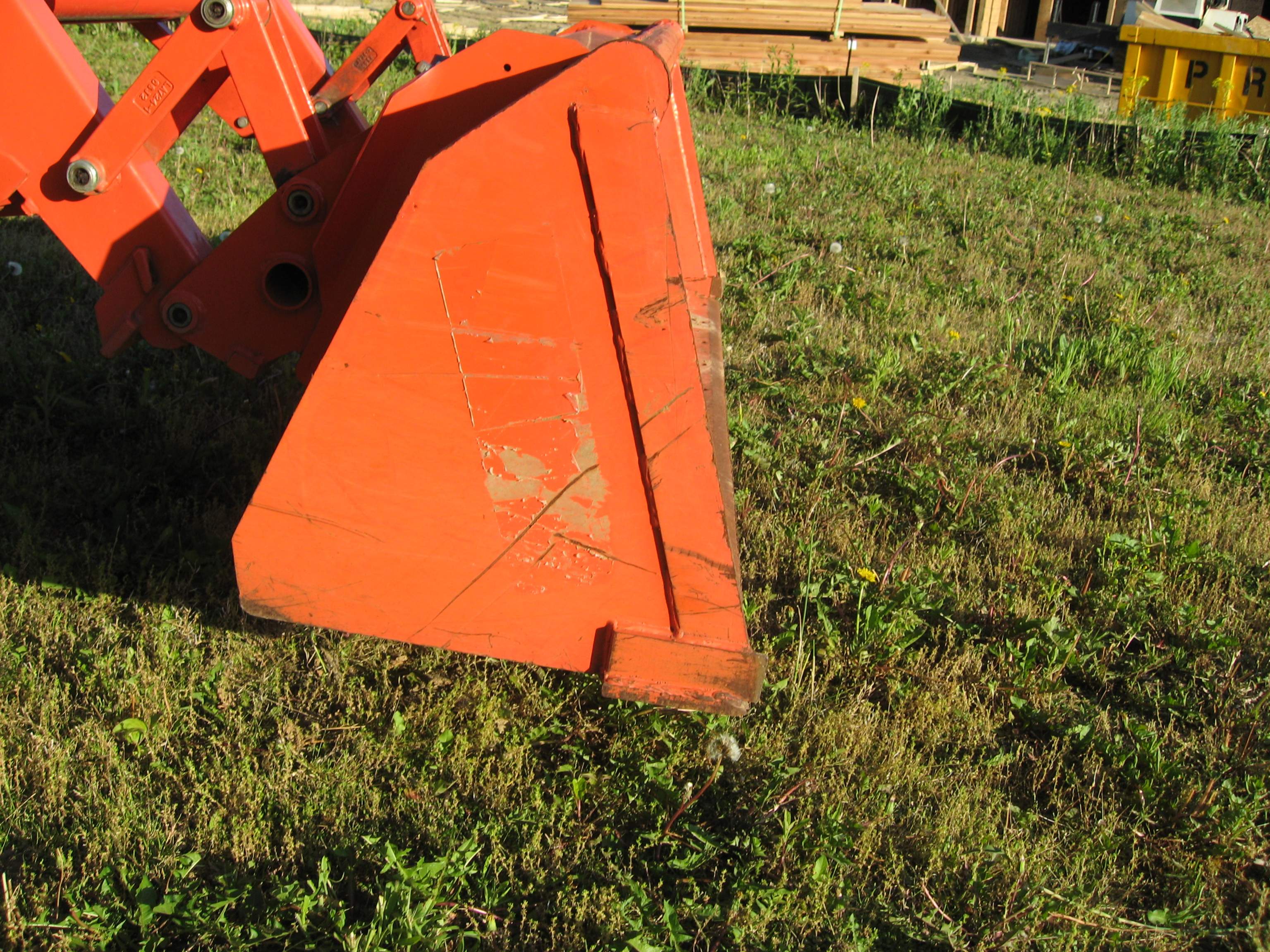

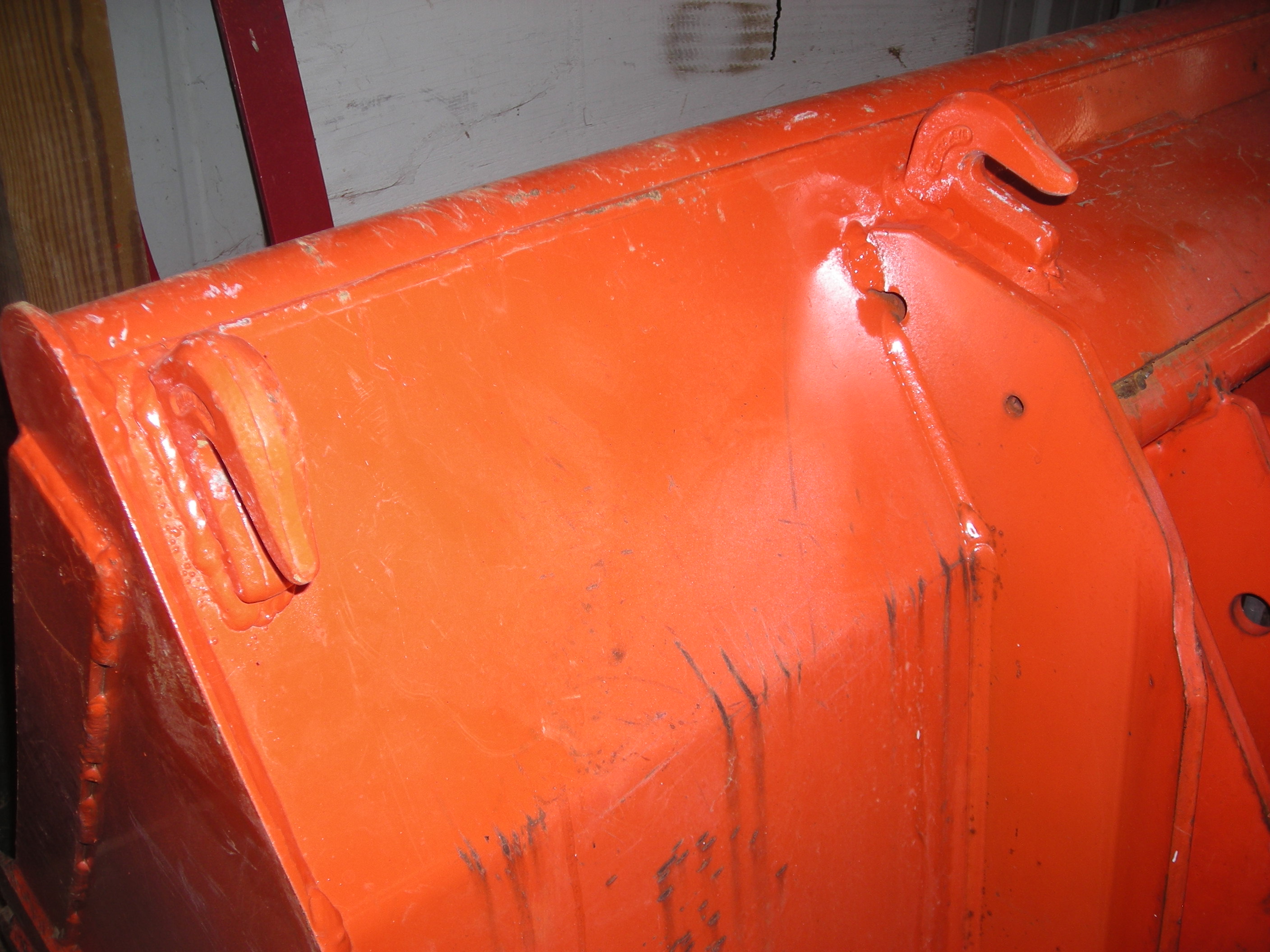

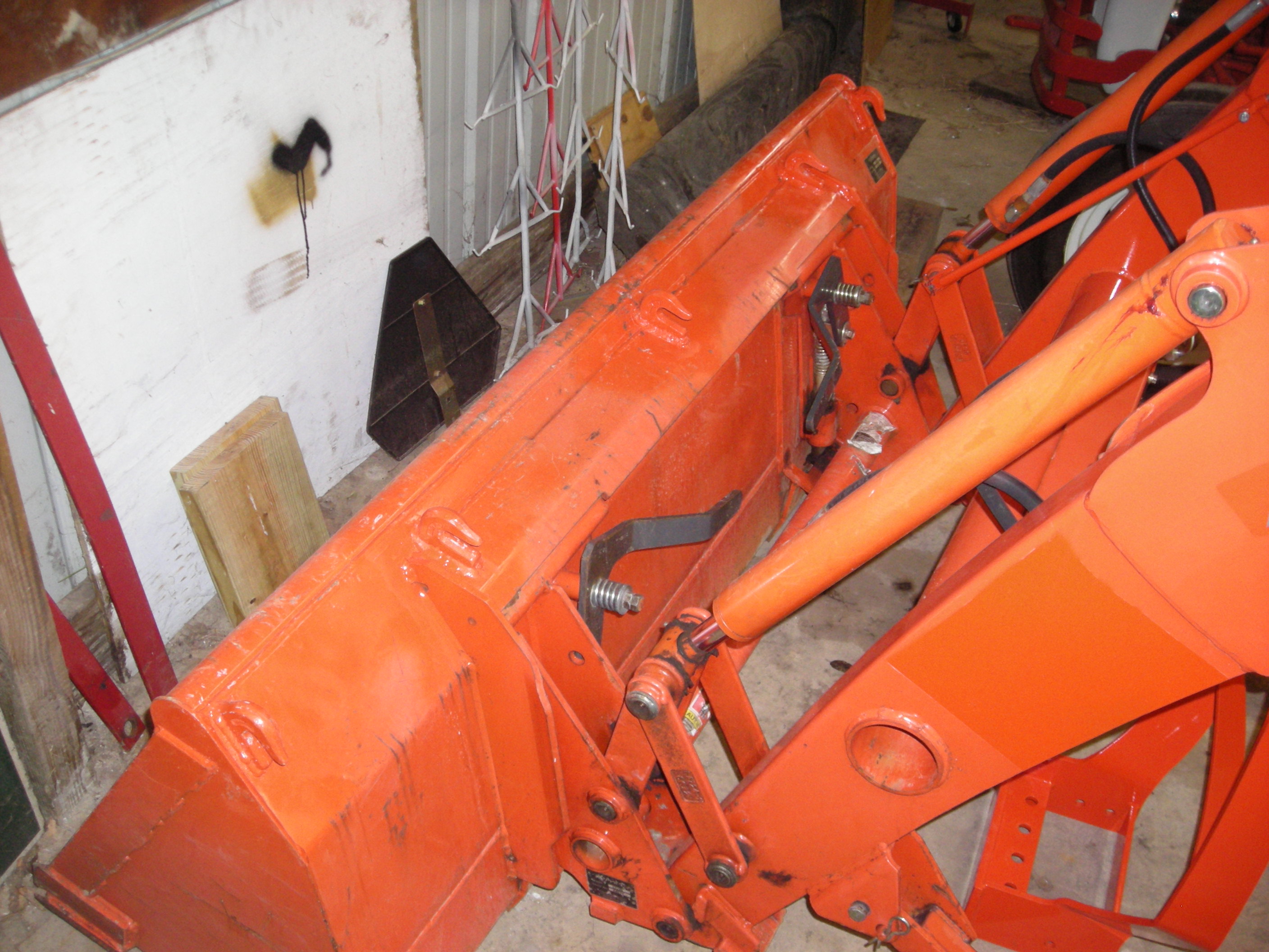

The HD round back bucket came with my loader, so I cannot compare. Attached are some pics of the HD bucket. Note the round pipe at the top of bucket. Philip.
