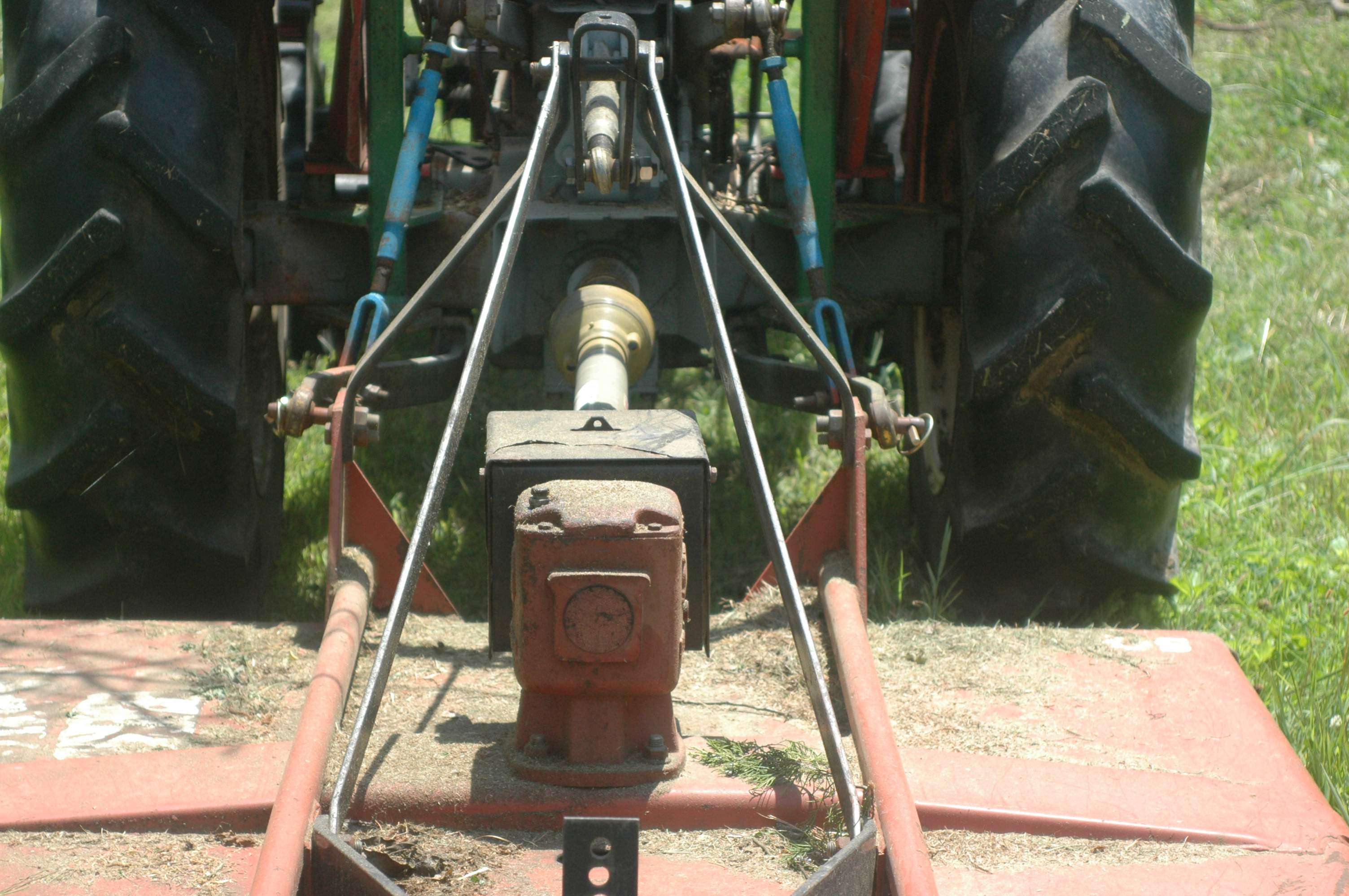

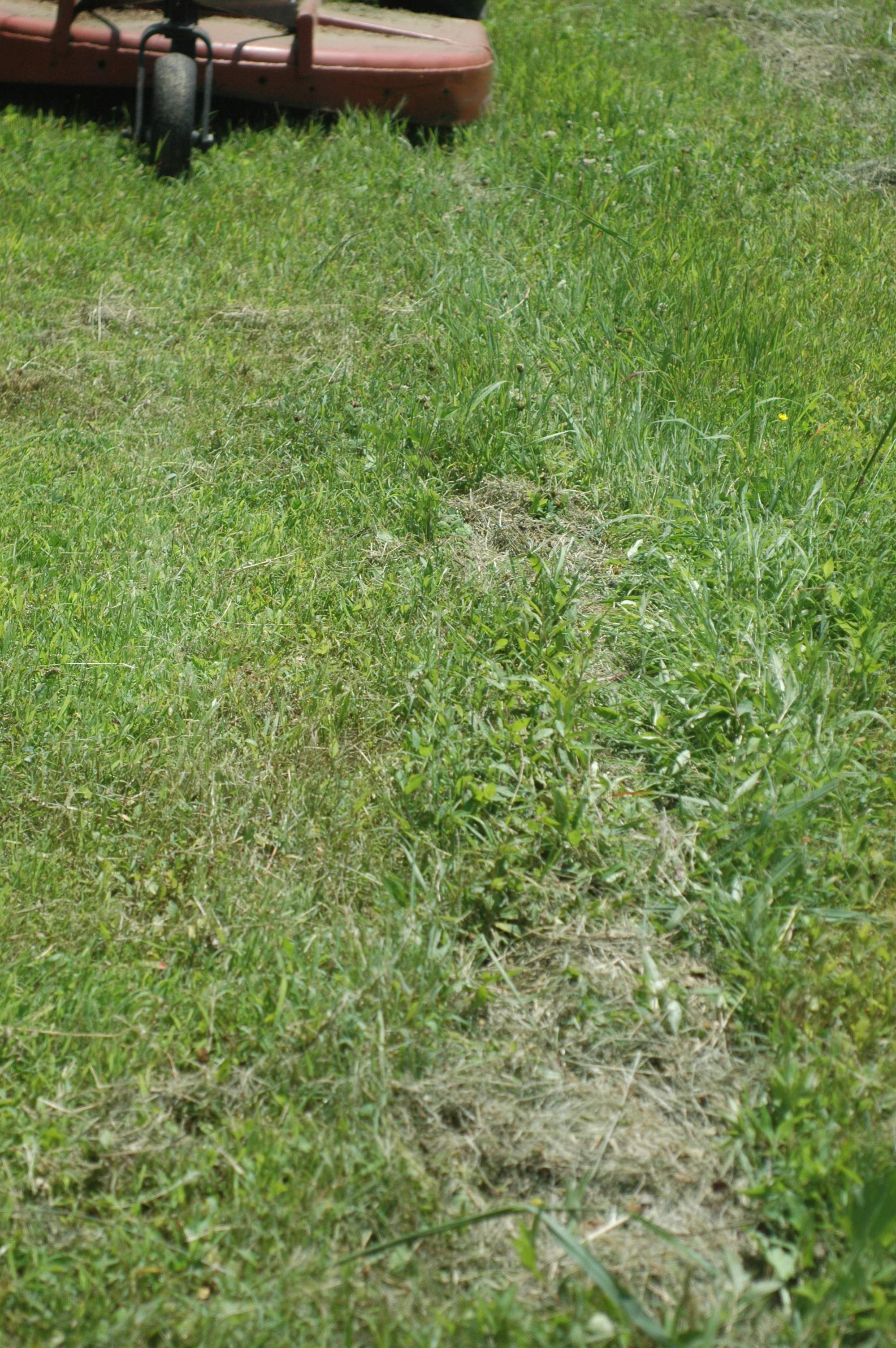

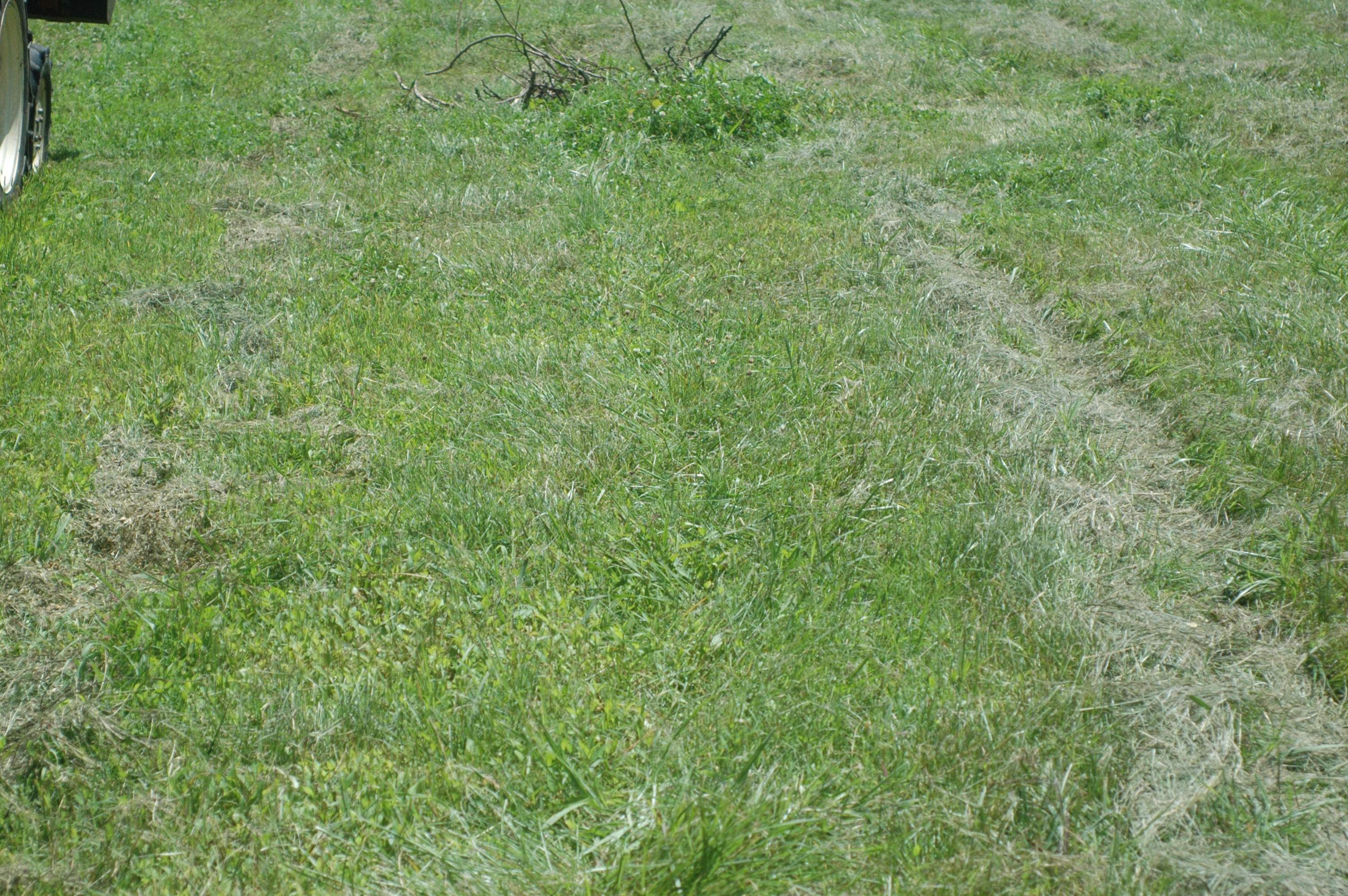

What am I doing wrong?
My squaler is not chopping grass for about 6 inches on the right side. It cuts the grass on that side but lays it down like a hay cutter would do.
The squaler is used on a Yanmar and the rear tires stick out about 6 inches on each side. The BH chops the grass on one side but hot the other.
I have the BH set up with a 1" slope to the front. The BH is equally straight between the rear wheels and straight back-not leaning to one side.
Any suggestions?

DSC_0620.jpgDSC_0621.jpgDSC_0619.jpgDSC_0620.jpgDSC_0621.jpgDSC_0619.jpgHi:
Here is a picture.
There is no picture
FEON
