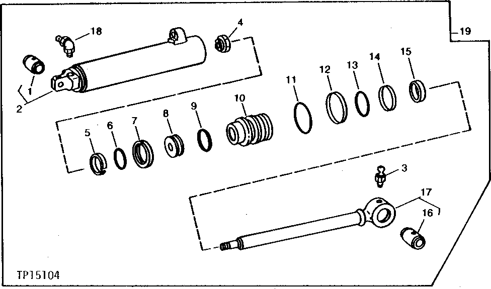

I have a Deere 310C backhoe. There are several sleeve bearings (steering, bucket and swing) that have spun, blocking the grease fitting port. The bearing sleeve material is very hard. A High speed drill bit won't scratch it. I'd like to drill a new grease hole through the bearing to the internal grease channel.
Anybody have a suggestion or experience on how to accomplish this??

Any advice on the type of carbide bit? I've found a spade bit designed for glass and a solid flute type. I'll have to use a hand drill through the grease fitting hole. If I break the drill bit in the bearing... I'll really be hosed. I'm leaning toward the spade bit for this reason...
   / Spun rod end bearings #5
Most bushings like that will have a groove around the circumference of the bushings so the hole in the bushing does not have to line up with the hole in the rod ends. I would look at a new bushing from JD and see if that is the case or not. You might just have hardened grease, rust, dirt, etc. that you need to get freed up. I don't think you will have much luck drilling with a carbide bit in a hand drill. Solid carbide isn't very forgiving. You'll likely break the bit, and they are expensive. If it comes down to trying to drill, I'd just get some cheap masonry bits. You want the kind for a conventional drill, not the chisel point type that a hammer drill uses. If you need to sharpen them, you'll need a silicon carbide or diamond wheel.

Typically the pins are hardned as well. NOT just mild steel. So that would also be $$$ to have them made. And they usually dont make the pins on a backhoe greasable due to strength. They want a SOLID pin, not one that has had holes drilled for grease.
HOSSPULLER: exactally what pins/bushing are you talking about and maybe we can look up a parts diagram:thumbsup: Most BH's have several different sizes and styles of bushings in the different locations.

Here's an example: It's the steering cylinder rod end. Part #16

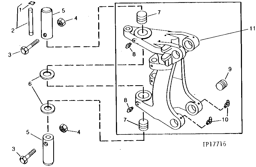

The most troubling bearing is the lower pivot of the swing frame. part #7

It appears in the diagram that the lower swing arm bushing IS grooved. so grease should get to where it needs to be regardless.
The PS cylinder busing does appear to need to be lined up thougt.
Have you tried drilling that one?? Because most of the time a bushing is used iin a cylinder rod, it is a bronze bushing, which should be no problem to drill.

The PS cylinder is the bushing I tried to drill.I was able to remove the pin and clean eveything up. I greased the pin before reassembling but it sure makes it a chore to keep it lubed.
The swing arm is definitely clogged up with dried grease. I tried heating it but maybe I was too timid about the amount of heat. I'm considering removing the lower pin to see if that might help clear the crud.
