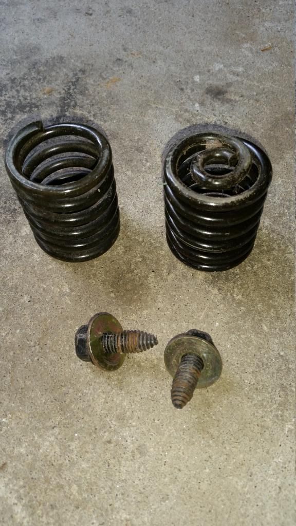

I bought these springs that are the exact size as the rubber "cushions" that are on the seat bracket to help cushion my ride. Well, I cannot for the life of
me see a way that is relatively easy to swap these in. If anyone wants them they can have them for the cost of shipping to your door.

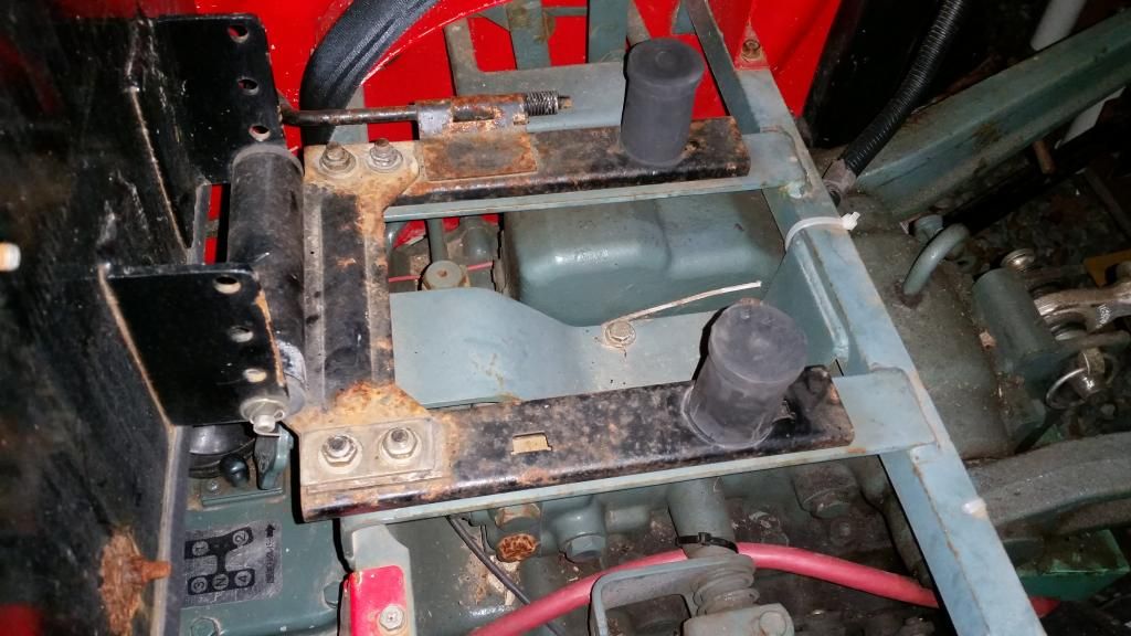

There is no way to get to the rubber stopper bolts. They are 1. Pressed on and 2. I would have to take the sliding rail apart for the seat assembly and knock the bolts out. And that does not look like it's an easy task. So I decided that my ride wasn't that bad with the rubber bumper stops.

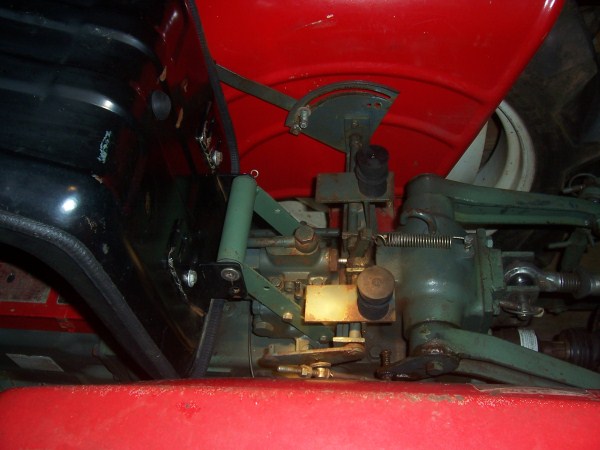

I didn't follow any of the but can't believe it could be all that hard. I just removed the bumpers on my YM2000B and replaced with springs, same as many guys have done for many years on all models of Yanmars.

My cushion stops are part of the seat slide. The bolt for the rubber cushion which is pressed in is also unaccessable because the slide mechanism is two pieces and there doesn't seem a easy was to disassemble without damaging it. Clearly my 2020 is set up different than other YM's
   / Springs for under the seat #9
If the bolt is pressed in the seat slide then surely the rubber piece should screw off the bolt or how was it assembled to start with? :confused3:

That looks just like the seat on my previously owned Yanmar 4220D. You have to remove the whole blue/green frame from the tractor to remove the seat rail. I did that to replace the original seat on the 4220 with a suspension seat from Agri-supply for less than $100. It required some additional holes to be located and a piece of sheet metal at the rear to be removed so I could slide the new seat further back but when I finished, it was much more comfortable. If I had know about the springs, I may have just put them on rather than a new seat.
