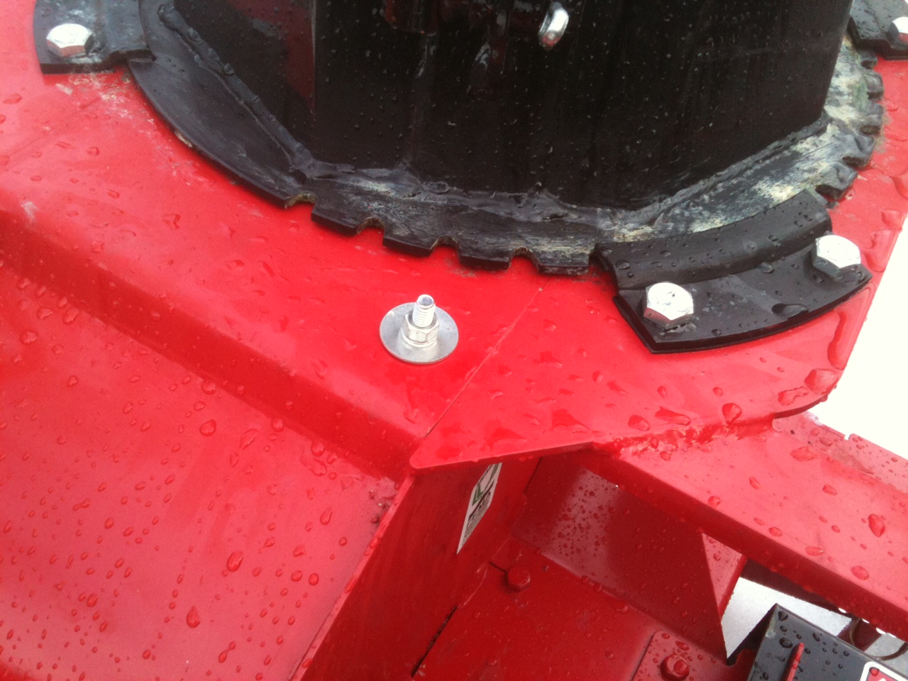

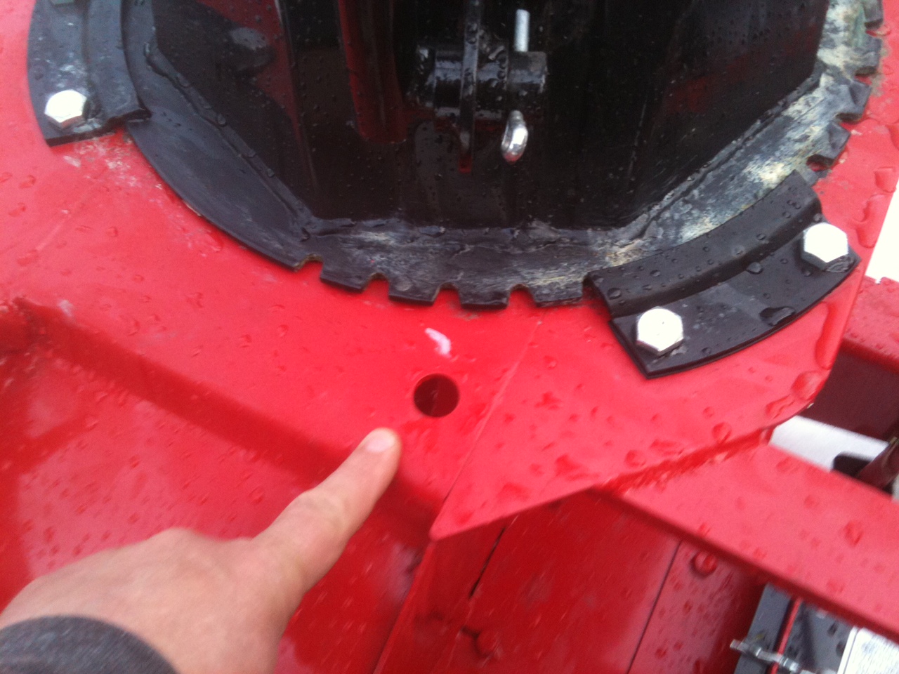

One thing I noticed today was that there is a large hole where the optional hydraulic chute rotator pivots. The problem is I don't have the hyd rotator and this hole penetrates into the impeller housing. So, when the blower is running snow pumps out of this hole like a nozzle onto the back of the blower, tractor, and me.:mad: Near the end of the vid you can see what I'm talking about.
A bolt and a couple of fender washers fixed it. Why the dealer didn't take care of this I don't know.
