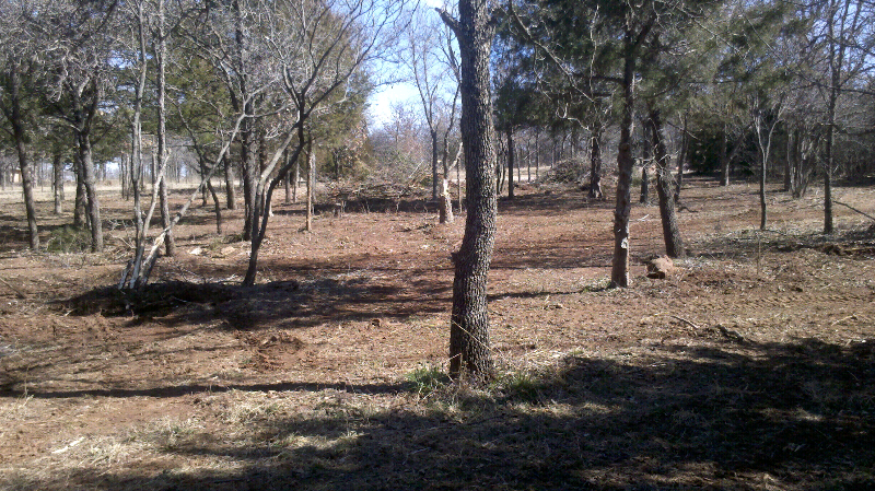

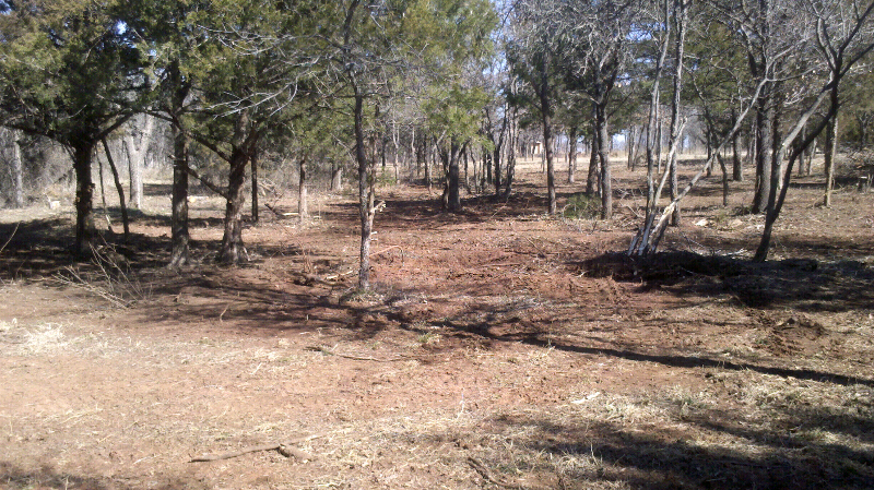

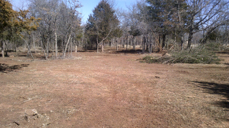

Ive been clearing some brush out over the past few weeks. Its the last acre or so of my property yet to be cleared. Mainly scrub brush, small saplings, and the occasional eastern red cedar. Typically i use hand tools (ie hatchets, loppers, machete, axe) so as not to disturb too much topsoil. Then i go back with loader and box blade and pile it up to burn. Here are some photos of the area.

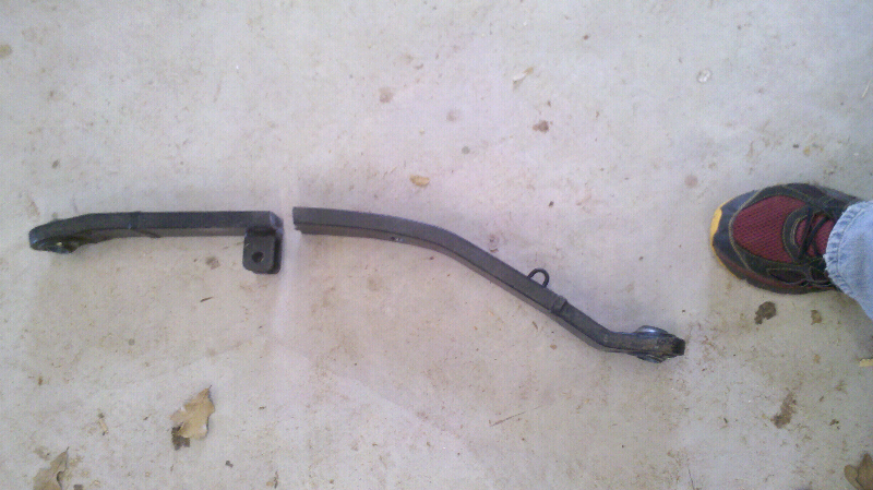

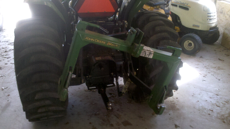

Thanks for the kind words. Actually, today was a NOT SO GOOD DAY. I noticed on sunday that i bent my right lower draft link of my 3 pt while boxblading backwards (lesson 1). I tried to bend it back with a chain and a tree today and it snapped (lesson 2). Now ive got to replace it, $270

Tractor has allot of strength in reverse, I bet you will think "$270" next time your using the BB and hit the "R" gear:D Actually you had a good day! you'll live to tractor again, you know the "glass is half full" thing:thumbsup:
BTW, you may be able to find a used link if you have time to look around.

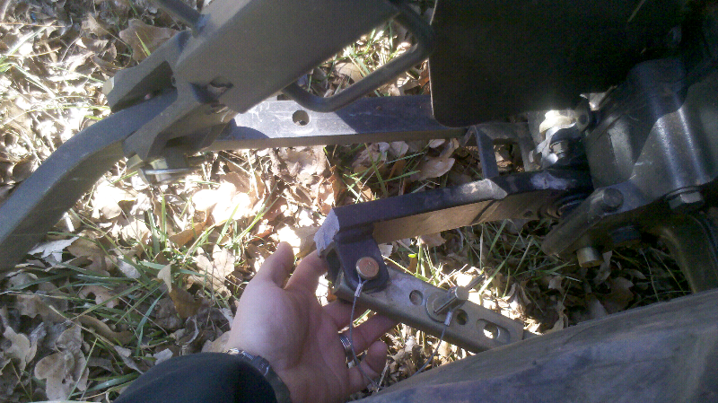

Heres a few shots of the damage..

Might could weld it or have it welded. Looks like cast iron so will need nickle rod or whatever is available these days. Worth a try

That cant be cast iron as it is too weak and brittle for the application. Might be cast steel but I would think it would be just regular mild steel. If you can get it straightened out, then double V bevel both pieces and weld up with 7018 rod and it should hold. It looks like some bad steel was used or bad heat treatment that causes a brittle spot in the metal. $270 seems high for that simple piece of steel, but that JD green paint is very high dollar stuff so I can understand why.
