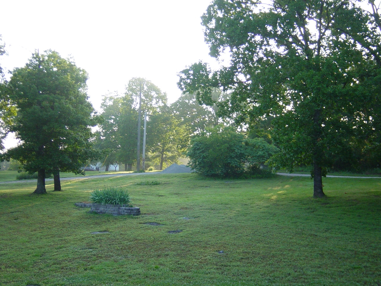

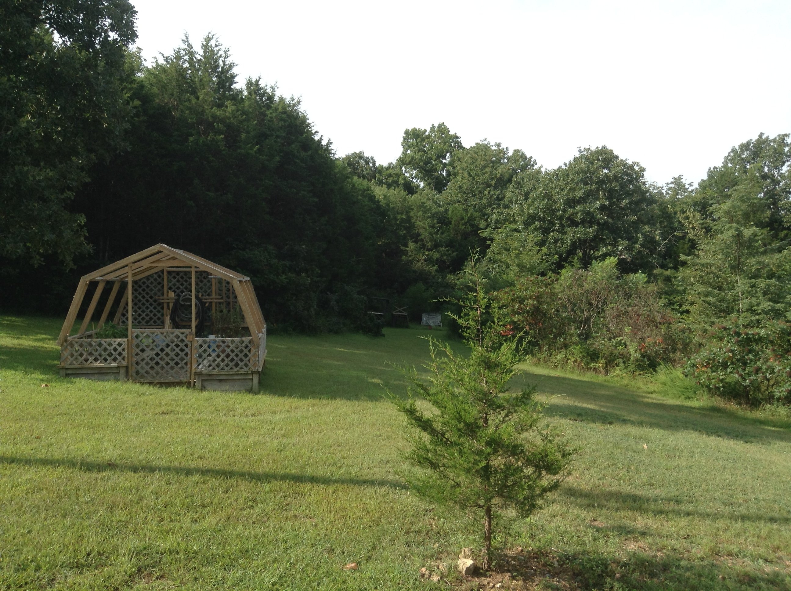

I live in the Ozarks and my "yard" has a lot of ledge rock that has slowly appeared in my lawn over the last few years.
Last year we had a sever drought and that killed off much of the grass that had been planted in the topsoil spread over the rock.

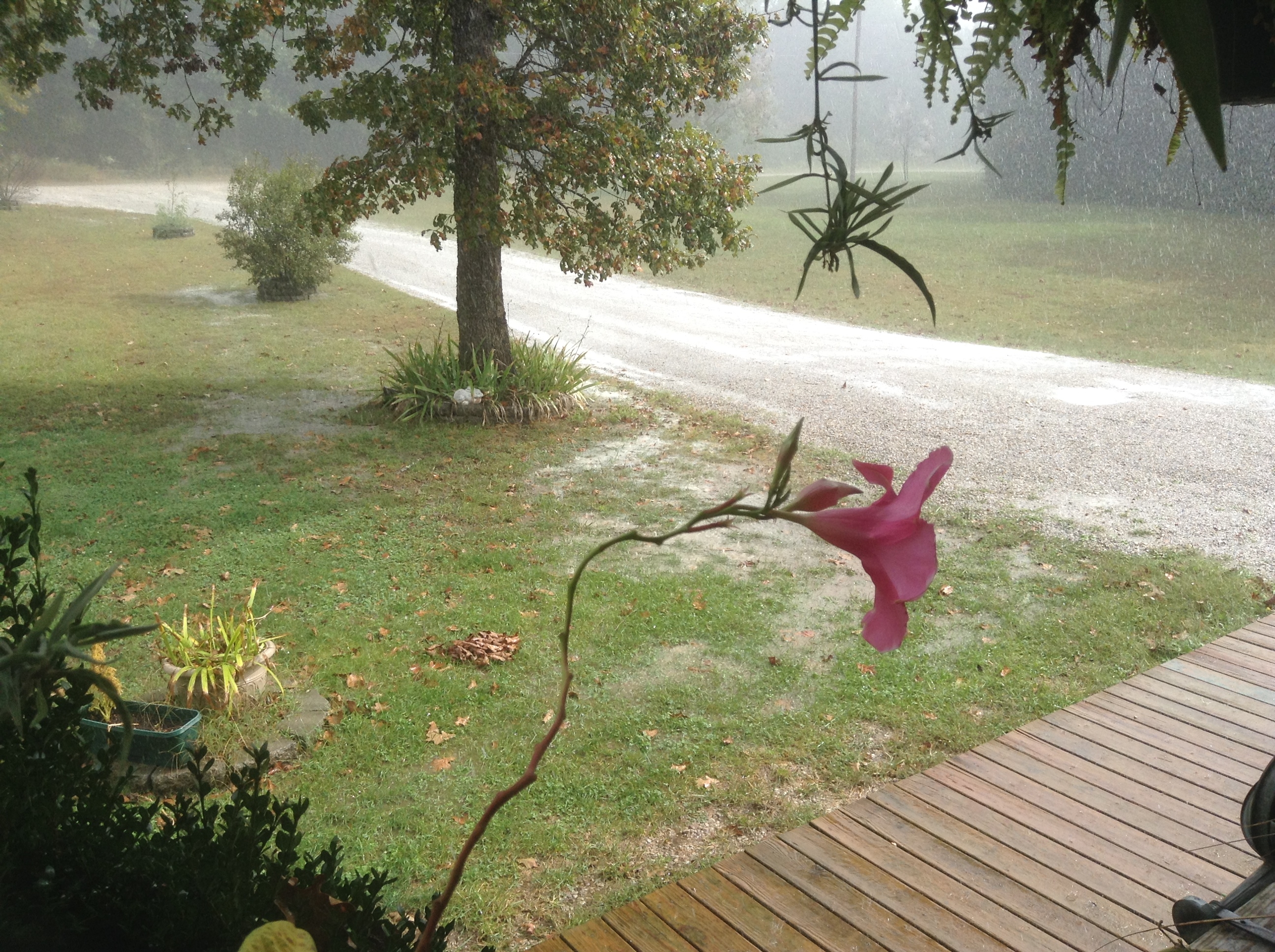

That took away anything that bound the dirt together and the spring rains has washed a lot of the soil away leaving a lot of bare spots of rock and gravel.
(Prior to my home being built, the ground was used as a catch all for builders and a lot of the surface has gravel 1-2 inches below the top soil.
So I want to re-create the yard that I bought by bringing in top soil and spreading it over the areas that need it for seeding a new lawn.
I have about 1 1/2 to 2 acres of a lawn that I want to repair.
Now for the question.....what implement(s) would you use to make this project more easily accomplished?
I do have a bucket for my tractor and a box blade, but other than that I'm wondering what will give the best results to work the yard.
I'm not looking for a showplace, just grass that will sustain the heat, the rains and resist the run offs that occur during heavy rains.
I can probably top dress some of the yard.
This is what it looked like a few years ago....
The last photo shows the type of damage the rain has done by washing away the top soil.
Any suggestions would be greatly appreciated.

Seems to me you should also think about prepping for the next rain's that are coming. If you build it up it could possibly wash away again. Things like:
Running a subsoiler through it so water soaks rather than runs.
Creating drains appropriate for your terrain deflecting large run off rivers.
Stone filters to catch some of the earth run off.
If the areas in question are trafficky areas, you want to include grass that will allow for some higher traffic.
Also its a good idea to get a soil sample, you may be lacking some nutrients/PH etc that restricts good vegetation growth.
