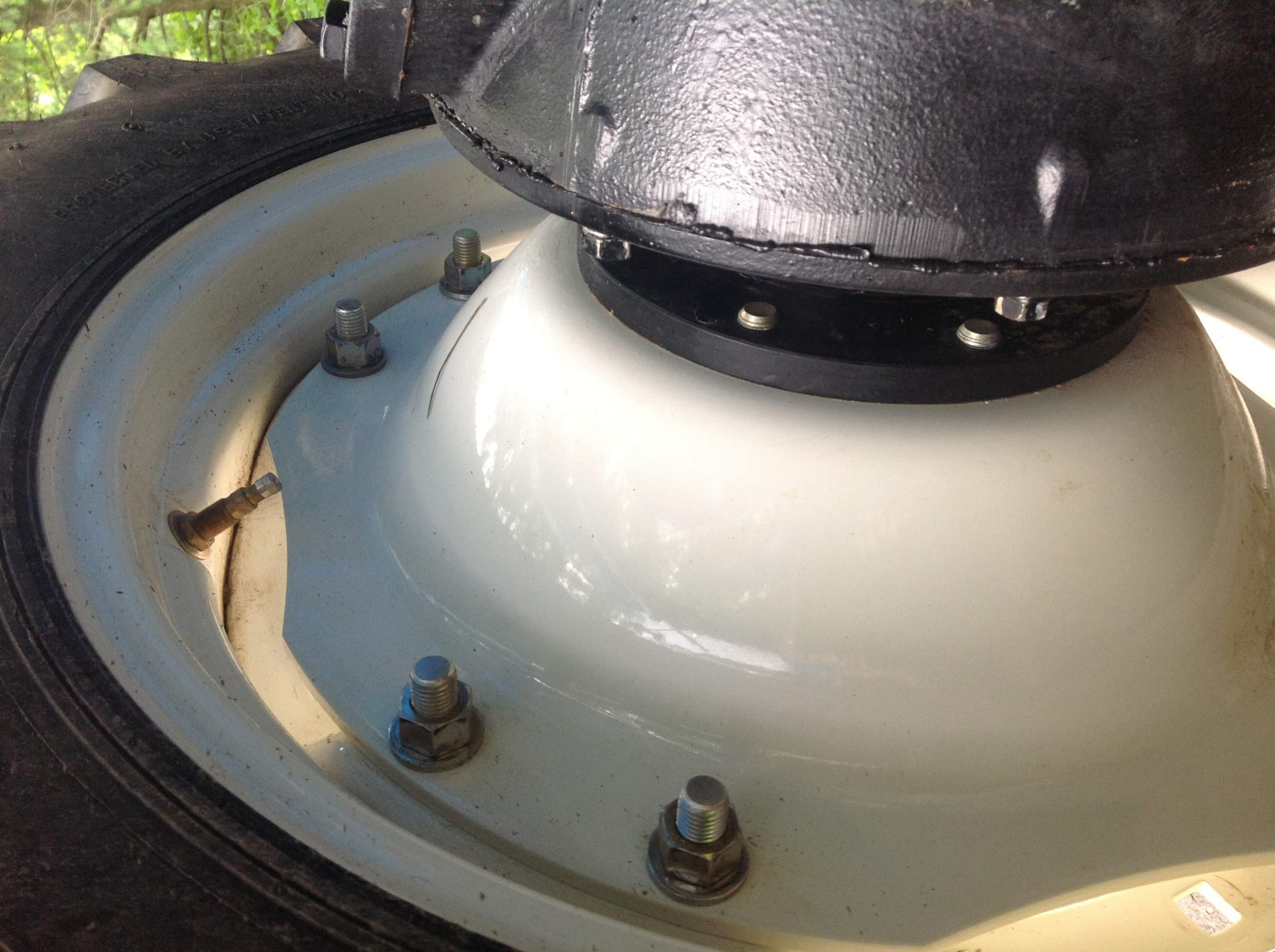

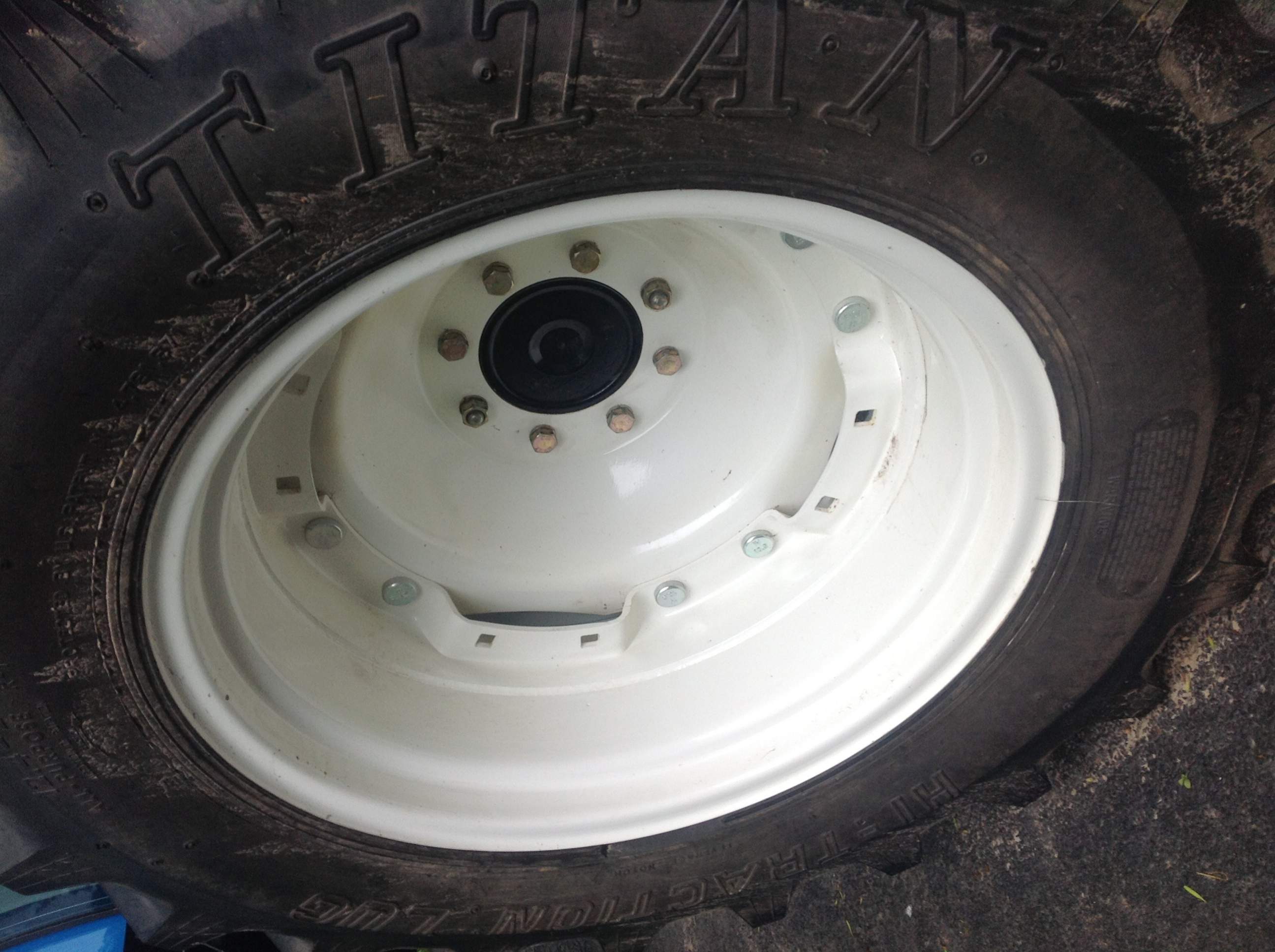

Will swapping the left wheel for the right wheel gain you anything in width, without having to remove and re-instal tires ?
Could you post a pick of your rims ?
Here's a couple of photos showing the front rims at their widest. I believe you could get some gains by switching the wheels side to side but can't remember how much.
   / Spreading tires further apart for more stability #8
Thanks for the pics. Looks like the wheels are already mounted so you get the most width available.
