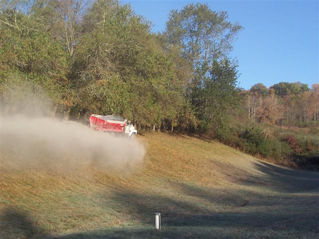

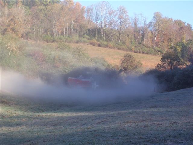

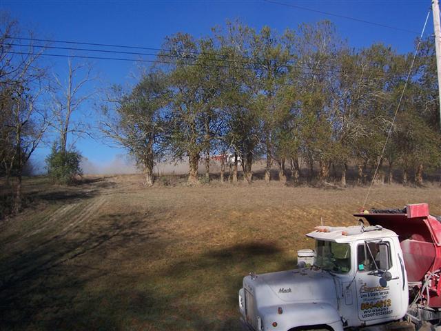

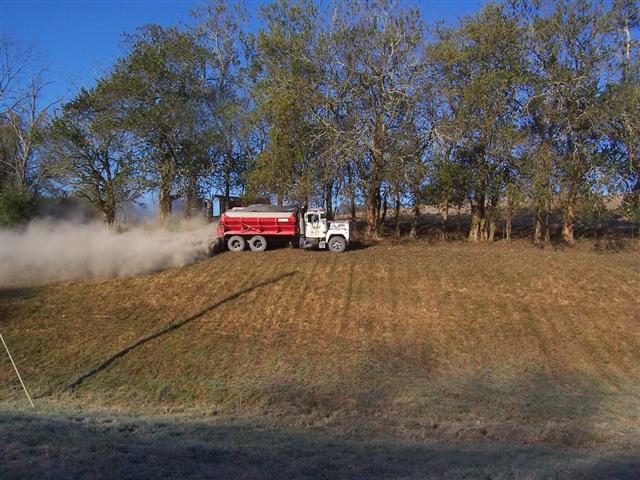

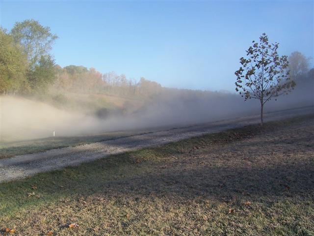

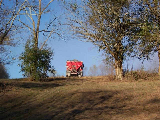

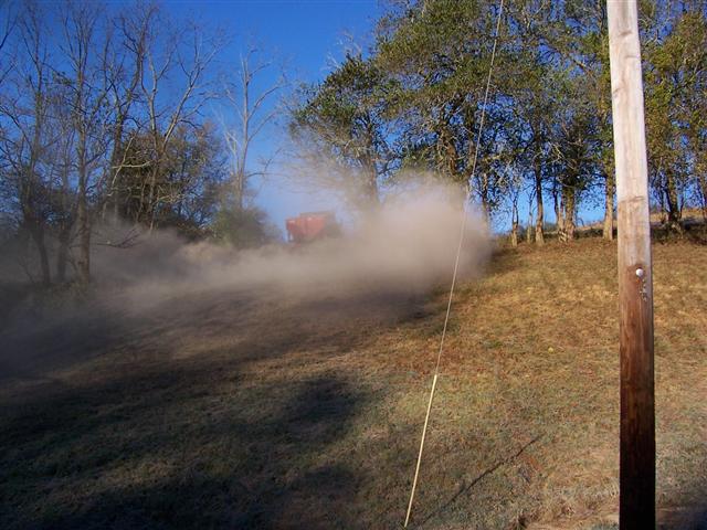

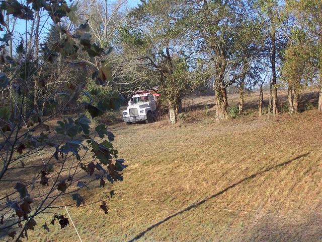

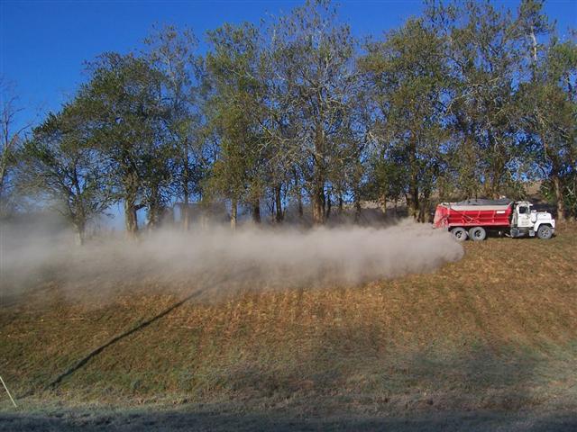

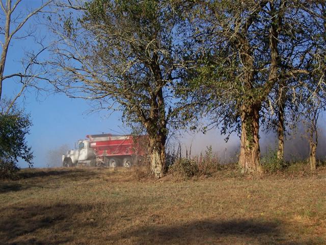

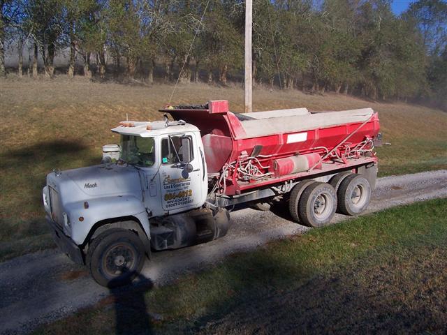

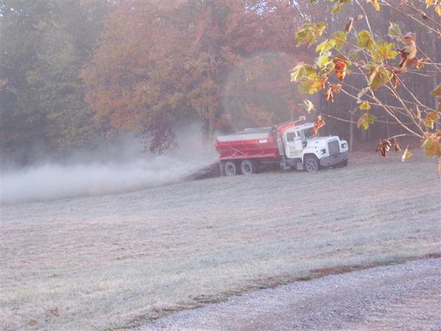

Today I had our fields limed.

Looks like you are in a skate board tube! How does anything stay up on those hills, looks like it would all run off.
I'm hoping for a light soaking rain.
The guy that did said he has been on worse. Ours is relatively flat compared to some others I've seen and been on.

Wow - you are lucky to be able to just call 'em up and have 'em bring a truck - The best our Coop can do is rent you a Wagon for $100 a day.

You do not have any other applicators in your area? I know of two companies that will deliver or spread lime on site and my friend loans his spreaders if you buy the lime thru him. This is only in the 20 miles I drive frequently. I am sure there are others the other direction that I do not know about yet.
