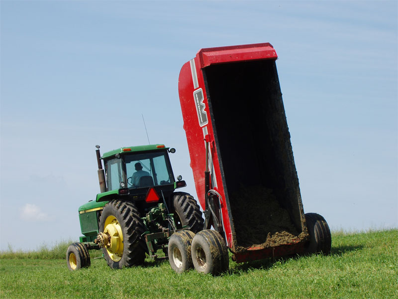

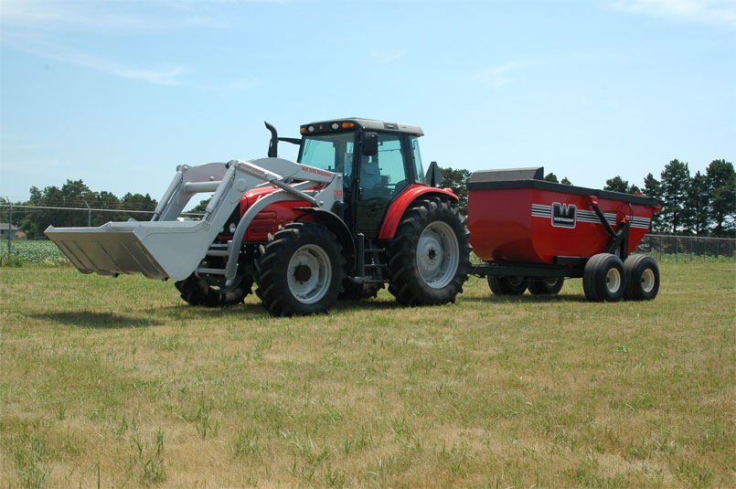

New Option is now available. No Chains, No aprons, No seals, No tracks, No leading and No freezing up. This is a new ALL hydraulic dump spreader. You didn't indicate a size, this is available in a 2000 gallon or 270 cu. ft. capacity. It looks smaller than it is because there are no internal components to fill up the space. It has an industrial grade Rhino Liner inside and you control the spinners and dump with a flow control dial and adjust for hills etc with your 3 point. Works best with liquid to semi-liquid materials or smaller fines that will slide to the back of the box when lifted. It's dump motion is patented, not like a dump truck, but with a high over center pivot point that keeps the weight centered over the tires. Front-End Loaders by Westendorf: loader for tractor, shade canopy, wagons, manure & landscaping equipment.
