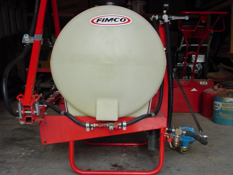

Mike,we have a Sprayer that is made by Fimco.You can buy one at about any Farm Supply Store.It has a 55 gal. tank,foldable 10' boom,total spray width is 140". Flow control valve and hoses.
I had to buy the Pump and P.T.O. adapter,and other fittings to hook up a hand held wand.
I use this thing a lot,spray weed control on the lawn,apply bug control on the lawn,treat weeds along the drive with Roundup.I use the wand to spray trees and shrubs,around foundation and shop.I teed a valve into the main feed line that I hook up a garden hose to,I mix up liquid fertilizer in the tank and let it gravity feed onto trees and plants.
Very handy to have around....

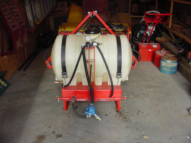

Heres a shot of the side,I teed into the pressure line to feed a hand held wand.I used 3/8" Gas Fitting shut offs and 3/8" quick couplers,seems to work fine,plenty of pressure...
