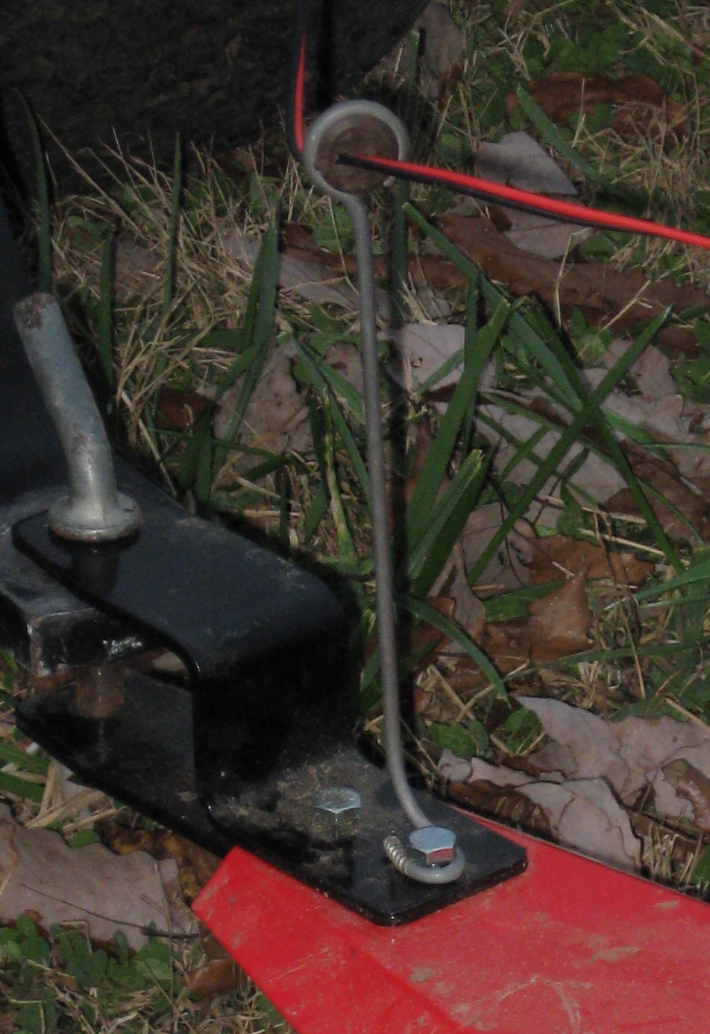

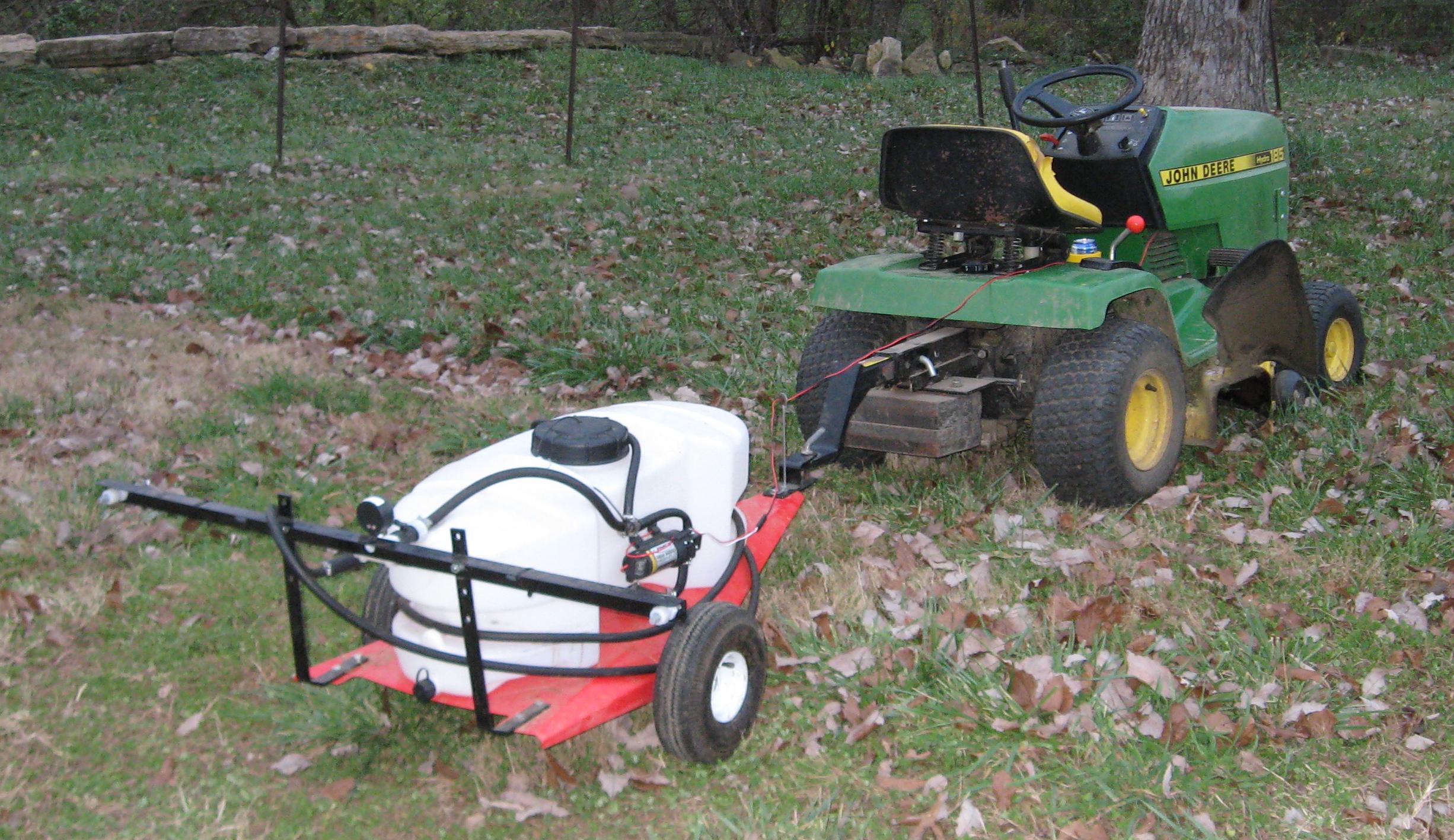

Bought a 15 gallon tow-behind sprayer last summer and had problems with the power wire hanging loose and getting caught under the wheel. Then it gets unplugged or yanks the wires out of the switch.
After fighting this for one spray session, I decided on a fix. Bought a one foot long 2-wire extension at the local ORielly's auto parts store for some extra length.
Then, I took a TV antenna wire standoff and bent the end in a loop to attach under the bolt that holds the hitch to the sprayer tongue.
Keeps the wire right where I want it and no more problems.
