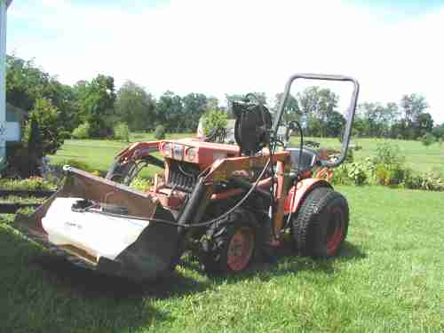

I bought a FIMCO 15 gallon spot sprayer to use for spraying my fence line and other spot spraying. I load it in the bucket of my FEL and I've run a flat two connector under the hood to the battery so it's easy to connect the electrics.
I found that the 15 foot hose that the sprayer came with didn't give me enough "walking around" range so I bought an extra 20 feet. This gave me plenty of range but managing all that hose while moving from place-to-place was a big problem.
I solved that by getting an inexpensive auto-retract air/water hose reel and mounting it on my FEL arm with U-bolts and wingnuts. There's a short hose from the tank/pump to a quick-disconnect at the hose reel to make it easy to mount/dismount the whole rig. (See attached picture).
I have a piece of 2 1/2" PVC attached to the FEL upright with hose-clamps. I use this as a "holster" for the spray wand.
For the fence lines, I just drive along and spray from the seat. For spot spraying other areas, the 30' of hose gives me room to hit several areas without moving the tractor.
I first tried using the air/water hose that came with the reel but for some reason I couldn't get enough flow/pressure. I just cut it off and replaced it with ag sprayer hose and it works fine.
