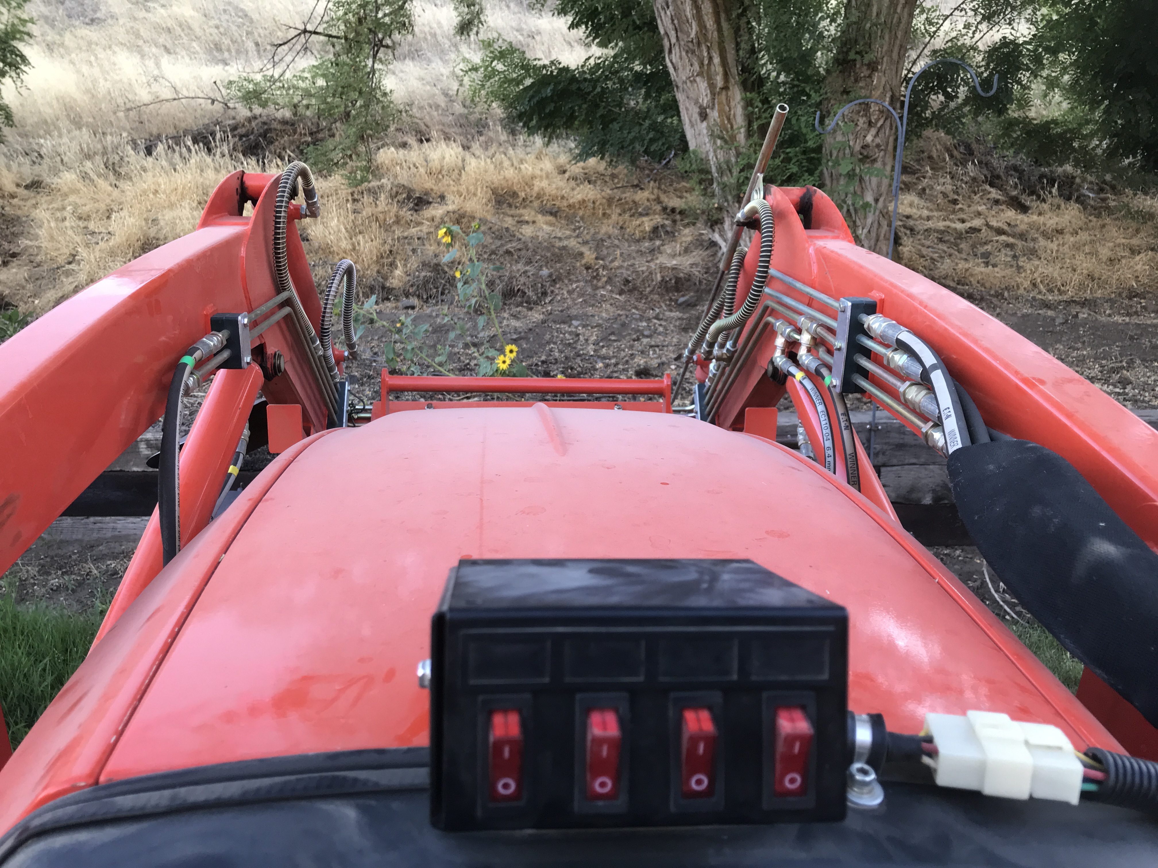

I am wanting to use my sprayer on my new ck3510se hc.
Sprayer pump is electric and takes 10 amps.
I was hoping to find an existing circuit at the back of the tractor that could be used.
I found an open plug at the back of the cab up by the work lights and assumed it was for a beacon.
Wires appear kind of light (small) for running a pump.
Anyone have any suggestions?
   / sprayer on a CK3510se Chris #2
I wired in a switchbox that is attached to the dash on my 3510. I ran a wire forward and to the rear for my sprayer. I usually strap in in the bucket so I'm not looking backward all the time. Plus I can see to adjust the spray height depending on conditions.I go directly to the battery and fused the switchbox and each individual switch. If your pump is over 3 GPM I'd go directly to the battery with # 12 wire. Starve one of those pumps for current and they don't live long. Also I'd hook up a bypass system so the pump runs constantly while the switch is on. Those pump motors are sealed and constant starting & stopping of a demand switch builds up heat and they don't like that. I've sold a bunch of pumps to folks who didn't use a bypass.
