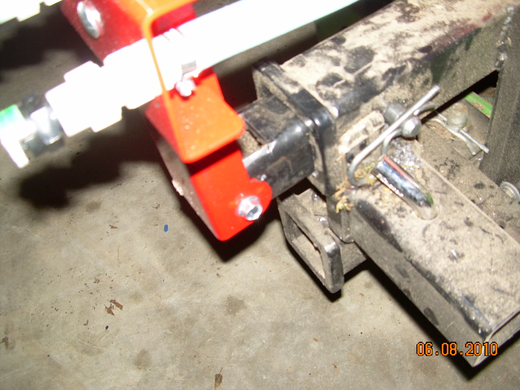

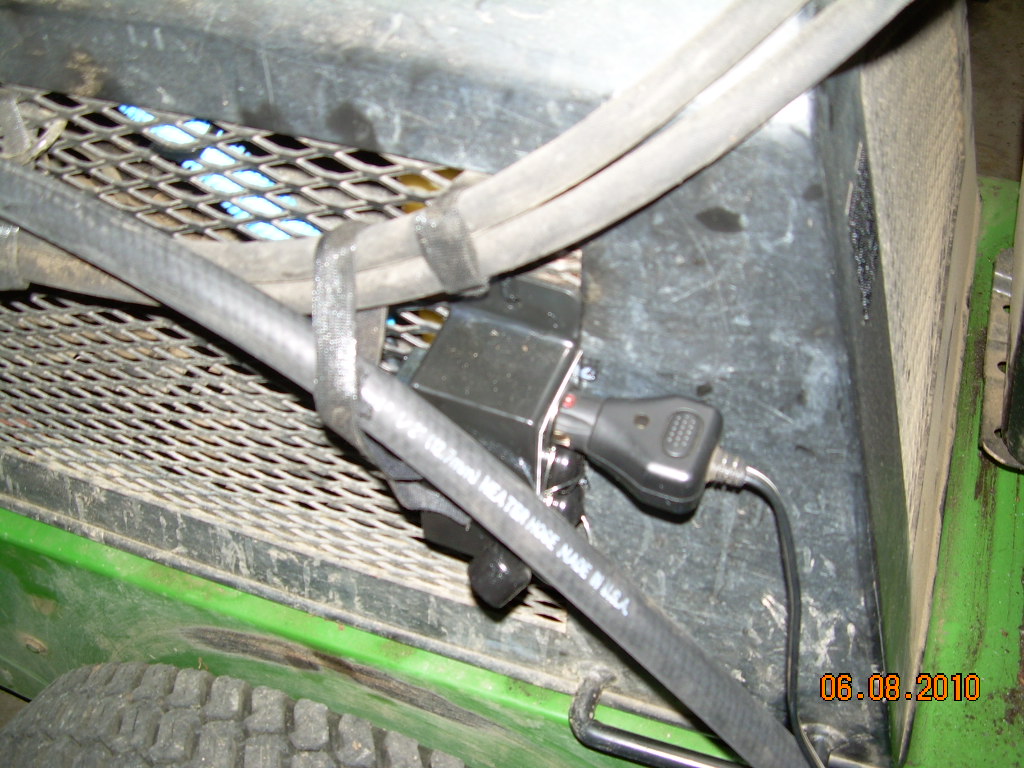

We have had a lot of ticks this year. I talked to a friend and they are using nemotodes to kill ticks and fleas. They are a microscopic worm which eat the insects from the inside out. I decided to get a sprayer and mount it on the PT422 to feed this material

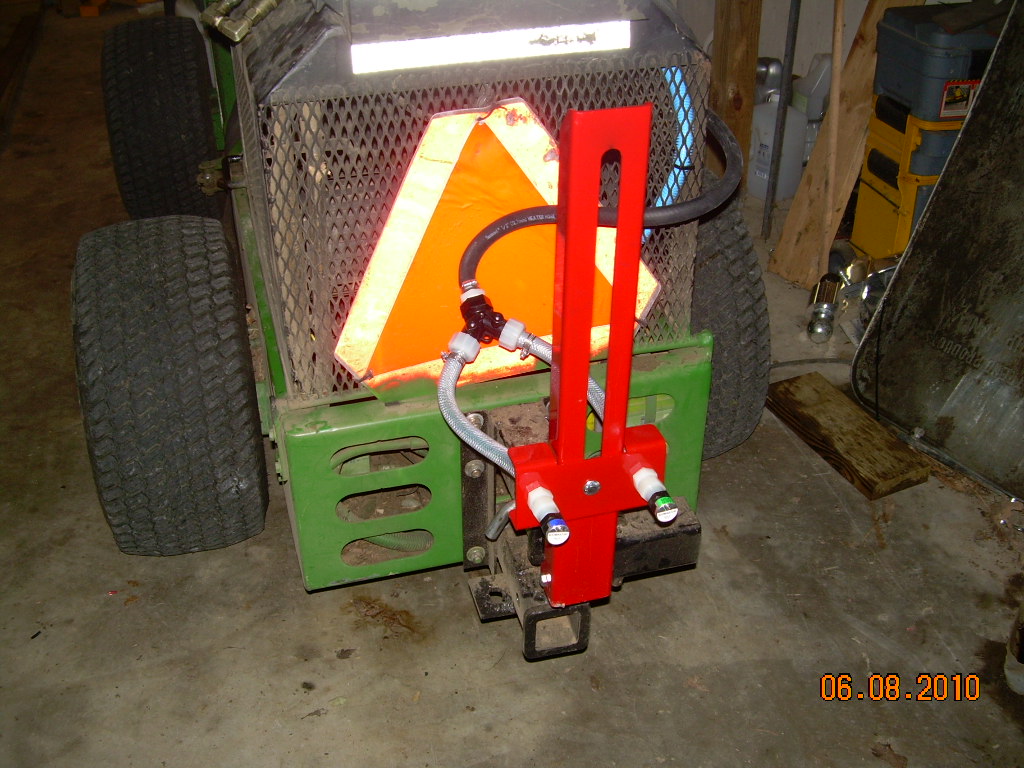

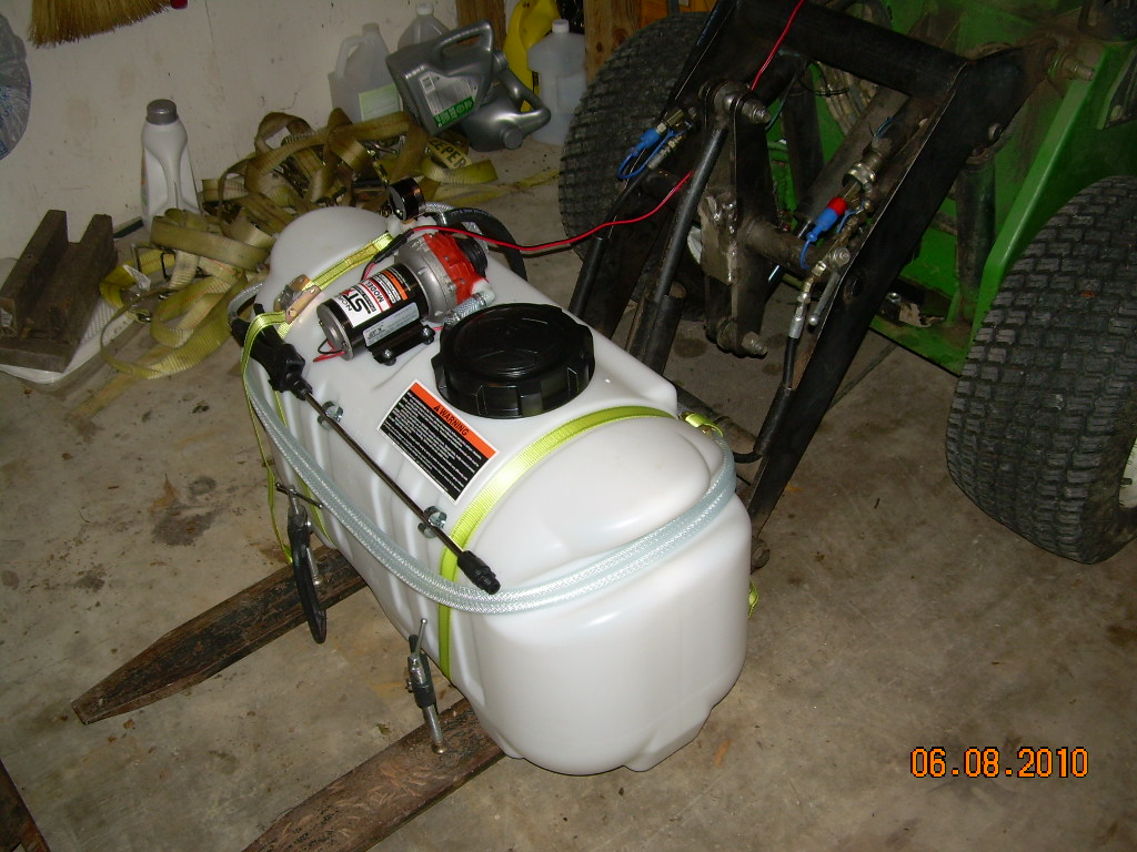

I found a 26 gallon one at Northern. I at first mounted it on the back with the tank sitting on a carry all mounted on the 2 inch receiver. I realized this was a pain to get on and off the tractor. Also I had to keep looking back to see if it was still spraying.

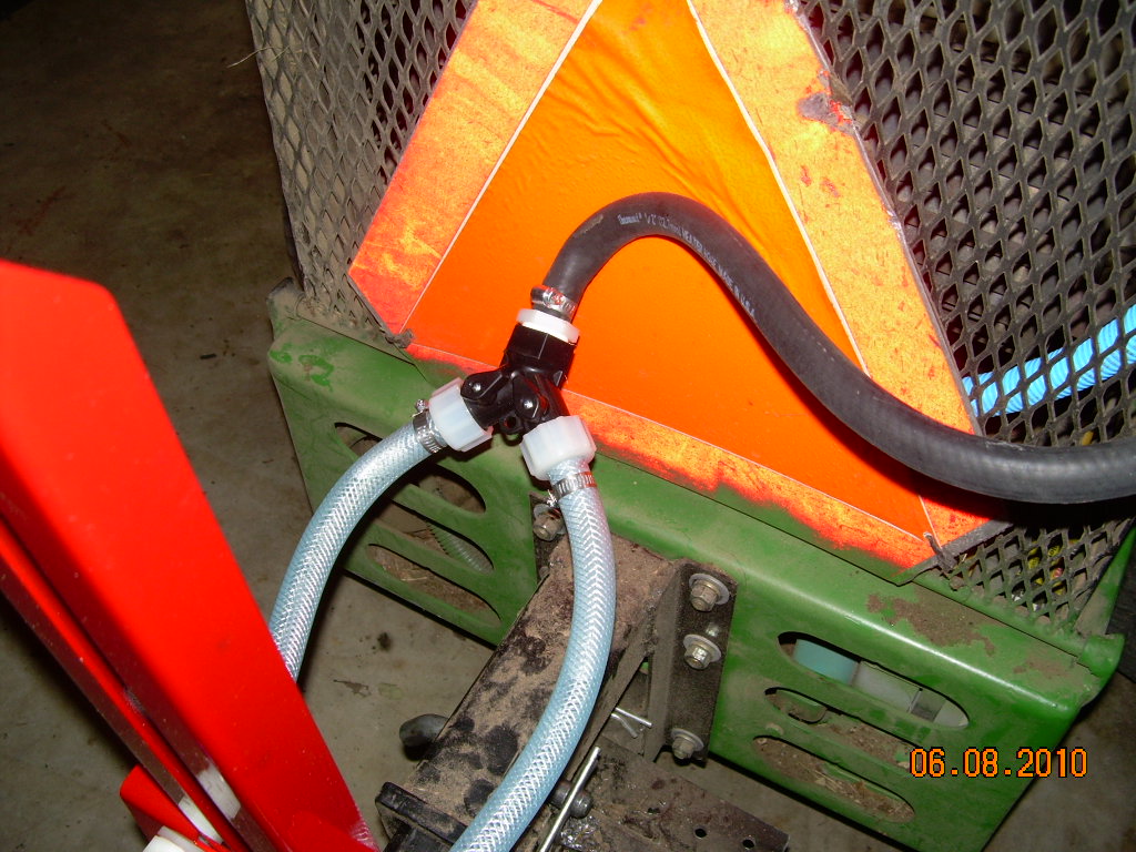

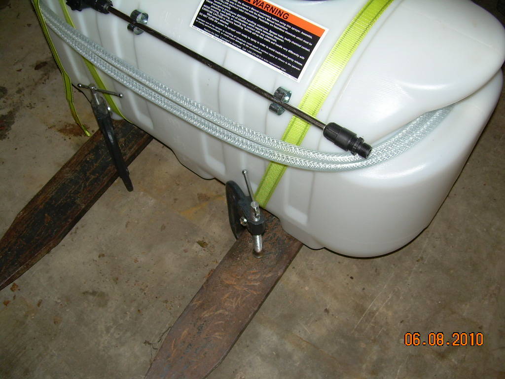

I decided to leave the nozzle in the back and put the tank on the forks. I got some 1/2 inch automotive heater hose (about 12 feet) and ran it between the pump at the front and the sprayer nozzles at the back.

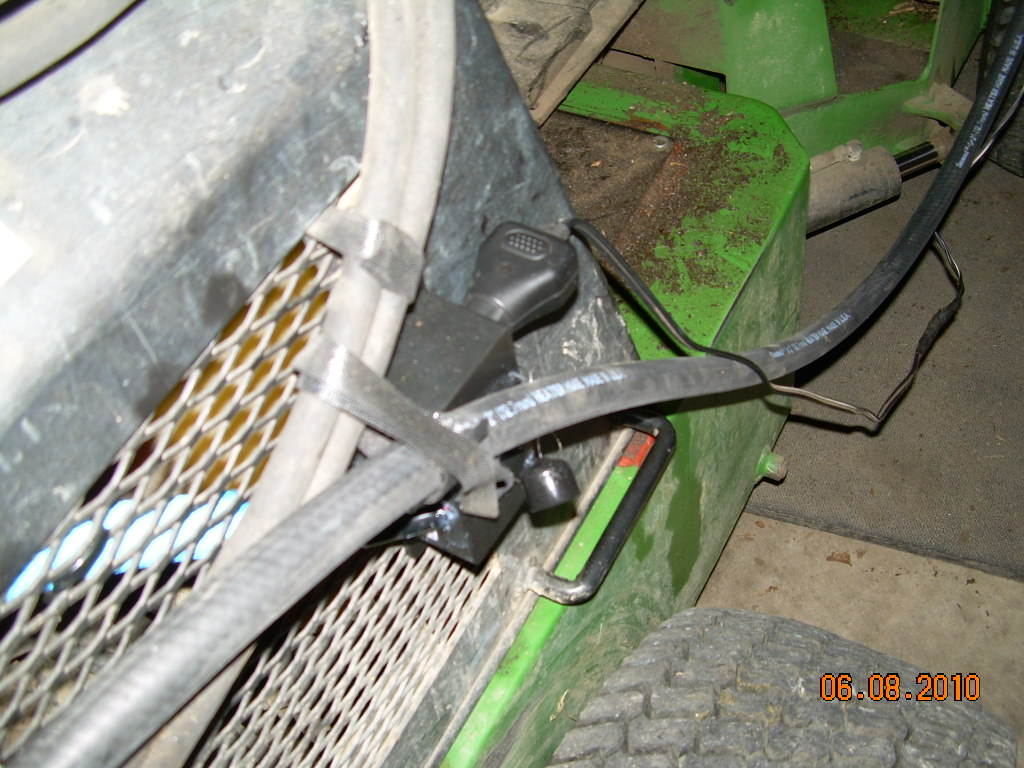

I originally supplied power to the motor through my cigarette lighter outlet. I found the outlet wires got hot. I then got a heavy duty triplet outlet from NAPA and mounted it on the side of the engine cover and ran the wires along the inside of the cover over to the battery cables where they connect to the engine and the starter. I installed the wiring in a flexible blue conduit. I put a 20 amp fuse where I take power off of the big wire on the starter. The pump pulls about 8 amps while running with both nozzles open. It is rated at 17 amps. The plug is only rated at 10 amps.
With this setup I can easily remove the tank and nozzles, and I can see the tank level and pressure guage while looking forward. Since the pump is rated at 5.5 GPM is does not take long to empty the tank.

The connector had 14 gauge wire coming out of it and it was sealed so I cut those short and ran 10 gauge (I was out of 12). Voltage drop on 12 volts can be a big problem. I did not want to drill a large hole, so the 3 outlet unit was a good choice for easy mounting. I used double sided tape and tyewraps.

I just had the unit blow the 10 amp fuse mounted in the cigarette lighter plug. I now have two plugs paralleled. Hopefully this will make a difference.
