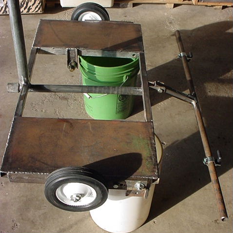

Dual purpose sprayer caddy for three point or tow behind application. I plan to attach a FIMCO LG 14-SS 15 Gal. Tank to this platform next week.

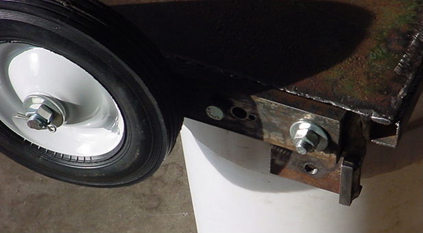

I fixed a set of wheels that can be positioned up for three point or down for a "trailer" effect.

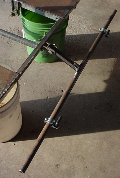

On the rear I fashioned an adjustable boom for sprayer tips. The tips can be adjusted to accomodate the position of the boom.

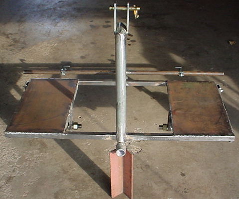

I have yet to fabricate a trailer tongue. It will screw in (and out) of the coupling at the front of the platform.
Once it's finished and painted, I'll send more photos.
