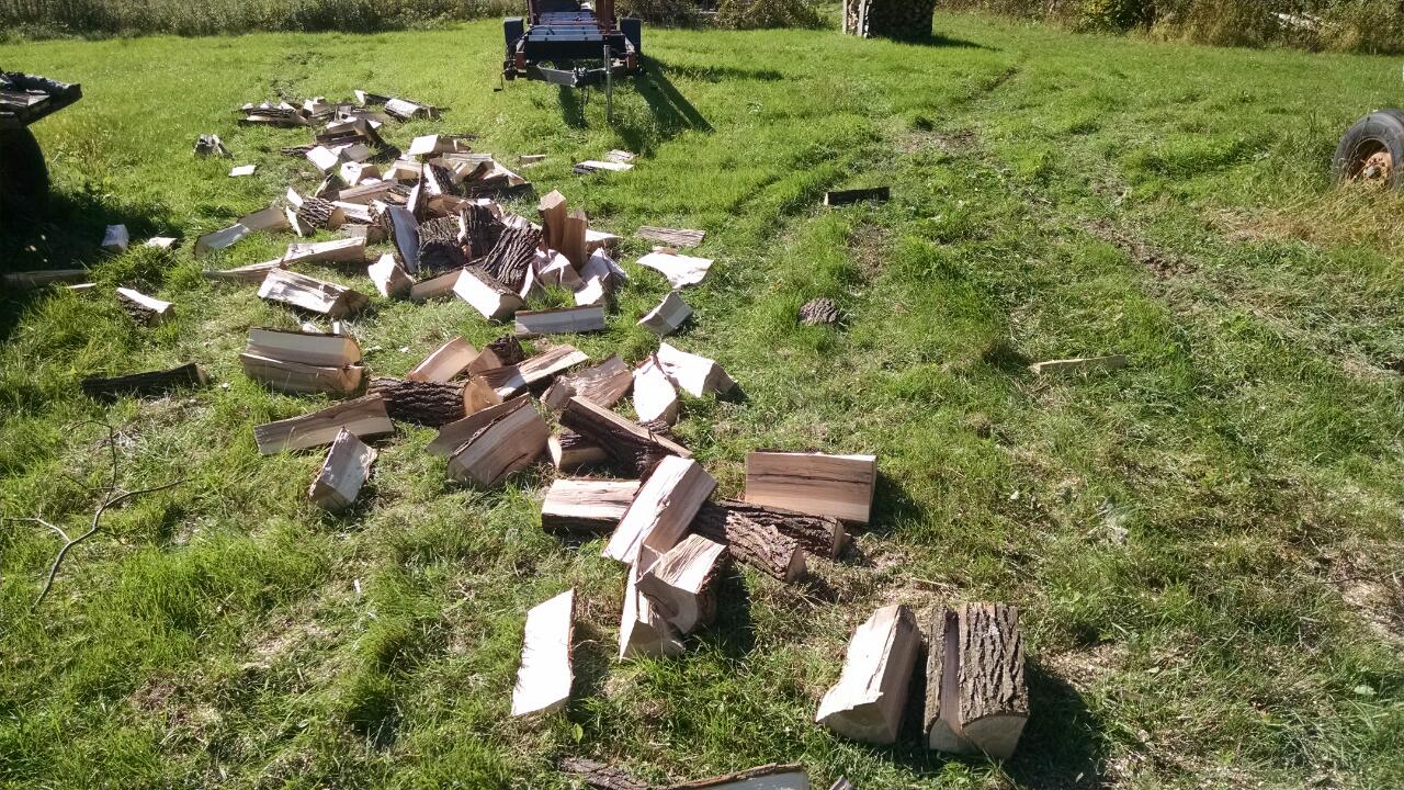

Here's a couple pics of some Ash I split last fall. Ash is pretty easy splitting wood, which makes the job more fun. I generally spilt right on the ground, but in most cases I don't even stand the rounds up. I swing the maul kind of like a golf club and rely on hitting it with a sharp edge moving fast enough to split the round rather than send it flying. It's fun for me and very fast.
Before: rps20160307_022305_474.jpg
These rounds (with a few exceptions) have not been handled. I skidded the log here with the tractor, picked it up with the forks, bucked it into rounds and spilt them where they lay. I basically didn't bend over more that six or eight times to do this. I was working quickly, but the reason I took the photos was so I could see the time stamps on them. From rounds to splits (and I split them small) took (drumroll please.....) 18 minutes. This was with my Gransfors Bruks, but I could do the same thing with the X27.
