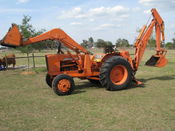

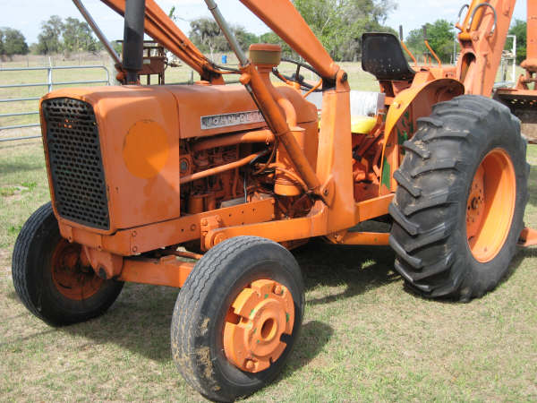

gettin ready to do the clutch on this 2010 this summer. im sure its gonna be quite a project since i dont have any way to ahndle this big loader att or the backhoe.
everything is a rusty mess to take apart. tons of things are gonna break and strip[ and need to drilled out im sure..to say nuthin of hoses and unobtainium parts i detroy taking it apart
wheres a good rescource for maybe a plan or a good parts locator. im handy enuff to do the job but i know its gonna be a real chellenge. im gonna leave the backhoe off once i remove it so i can bushhog
any help or someone who wants to do the job for me...???

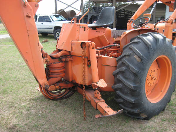

another shot of the industrial 2010

I'd like to help, but FL is too hot for me. :)
Deere should have parts for a 2010. With the FEL off, I think you will be surprised how easy splitting the tractor will be.
Send off for some RustReaper at Rust Reaper the Multi-Purpose Lubricant
Soak the threads a few hours or a day before trying to remove them, and if they are anything like the ones on my JD 110 1964 lawn tractor, they will turn off no problem. This stuff works like a charm. Little known, but sure glad I found it a couple years ago.

What year is your 2010? I might have a manual I could copy some pages out of for you.
   / splitting the 2010 for a clutch
not positve..i know it is he low serial number early version tho. the fuel filter and the oil filter go on from the top. later serial numbers the filters go on from the btm.
id appreciate the manual for sure

That's quite a beast you have there, Gary. Does it still have power?
If so, that will make a HUGE difference on removing your FEL and hoe. I
have done this without power, and I do NOT recommend it.
Since your FEL is not QA, you can remove it without special equipment
if you can drive the bucket under an immovable object and use the
rollback force to lift the boom out of the towers.
