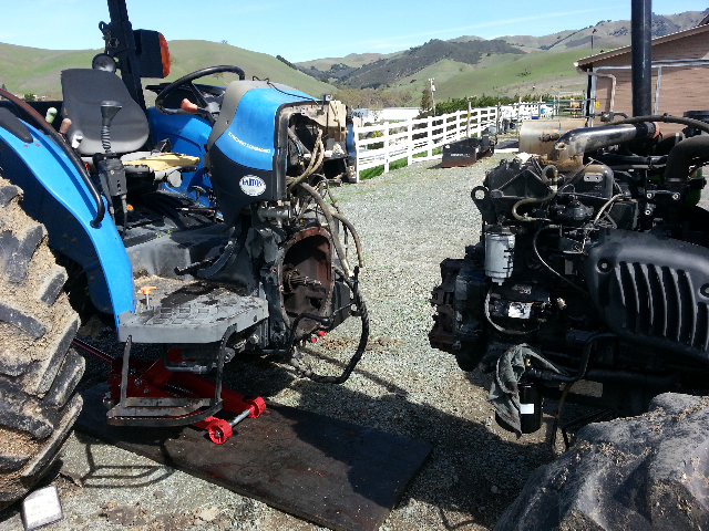

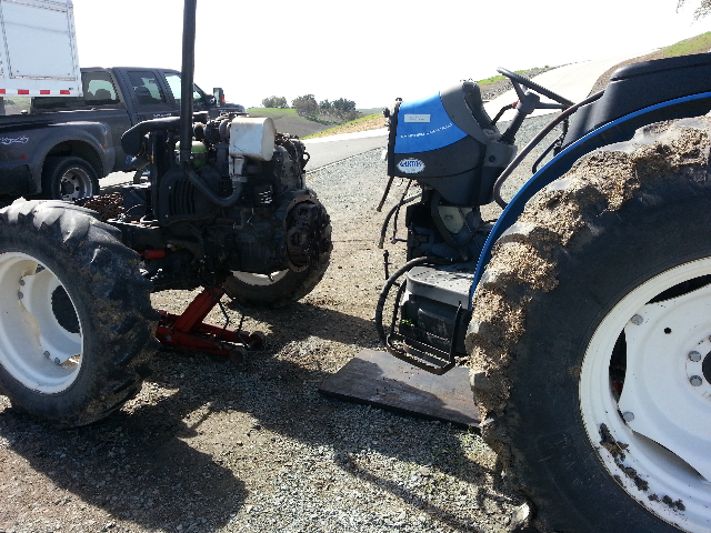

Just another day as a mobile equipment mechanic. Customer called needing a clutch in her TN75. Turns out the clutch fork had somehow come disengaged from the release bearing holder, the holder rotated so the fork wasn't contacting it at all. I put the holder back in place and re-attached the clips. Apart and back together the same day, and I look like a hero.
