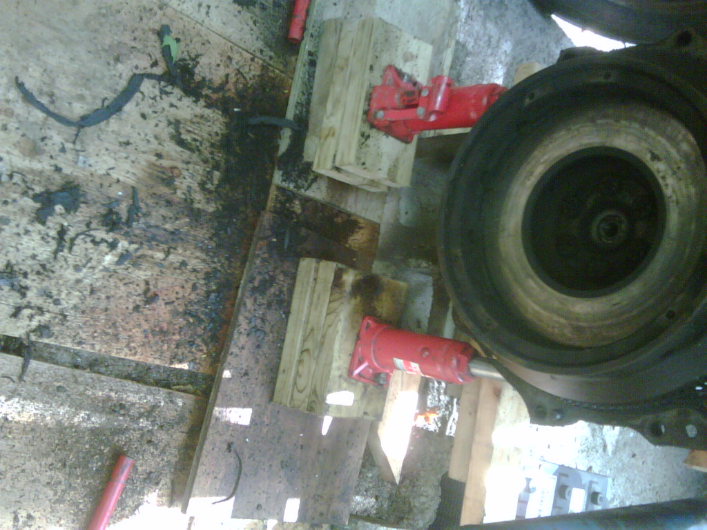

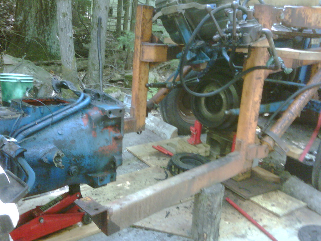

Well I finally split this tractor and I have received a new clutch package. Now before I install it. Some guys who are pretty good do it yourself mechanics with cars were telling me to check the fly wheel for warp since my clutch was so badly worn. They sat that the heat from the worn out clutch may have warped the flywheel. Just wondering if anybody has run into this problem with a tractor flywheel. I will attach pictures of the clutch and the flywheel although the one of the flywheel isn't very good. When I looked at it I didnt see any scoring and all the teeth were still on it. Pressure Plate.jpgWorn Clutch.jpgFlywheel.jpgFlywheel Close.jpgt
   / Splitting A Ford 3000 #2
Don't worry about your flywheel. I've seen dozens of clutch plates come out looking like yours, and have yet to see a warped flywheel. A few rivet scratches on the face won't hurt anything either. Put in the new clutch assembly with new bearings and put it together.
