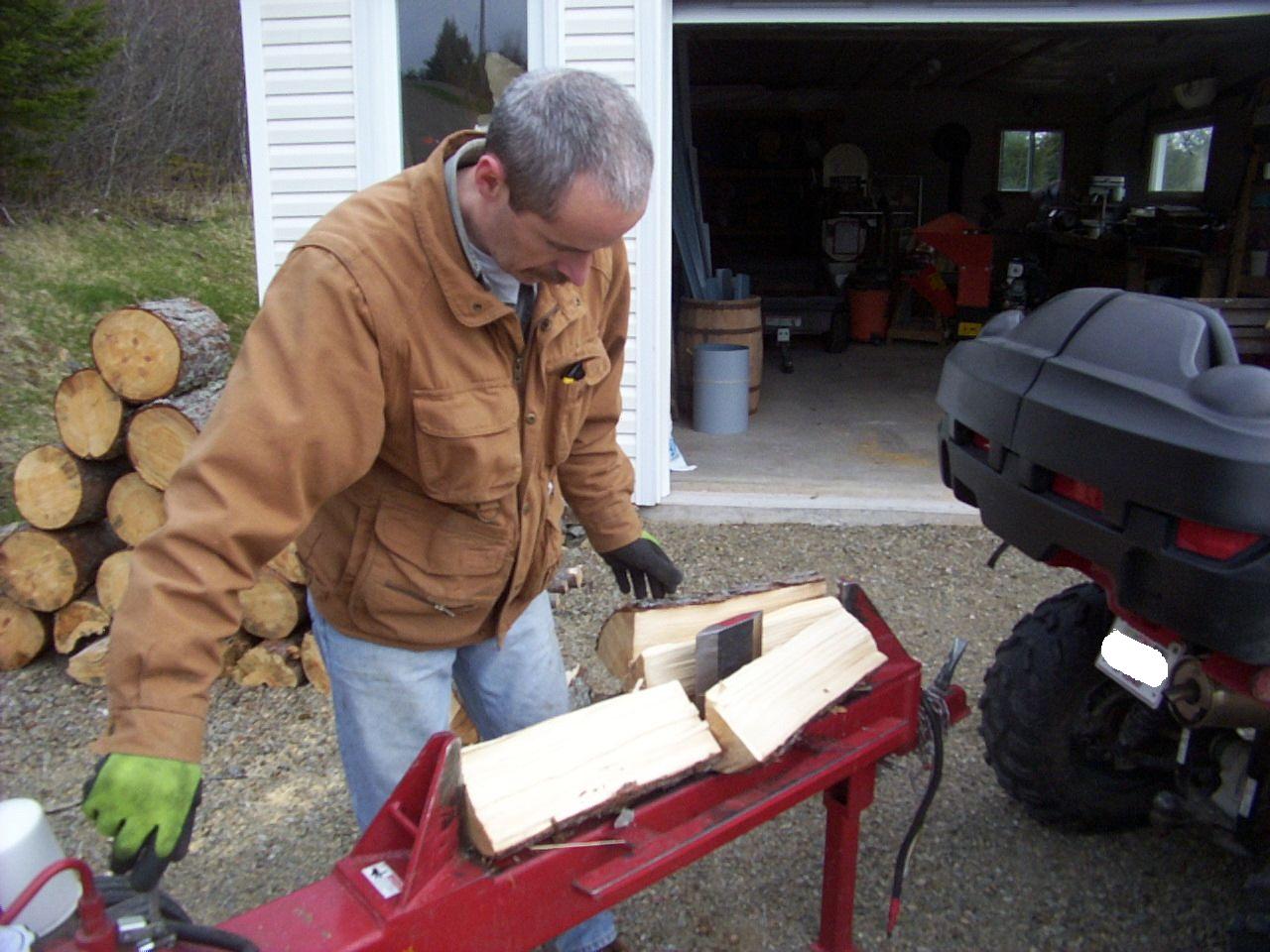

Hi I am buiding a 2 way internal cylinder logsplitter and could use some advise about the type of cylinder I need

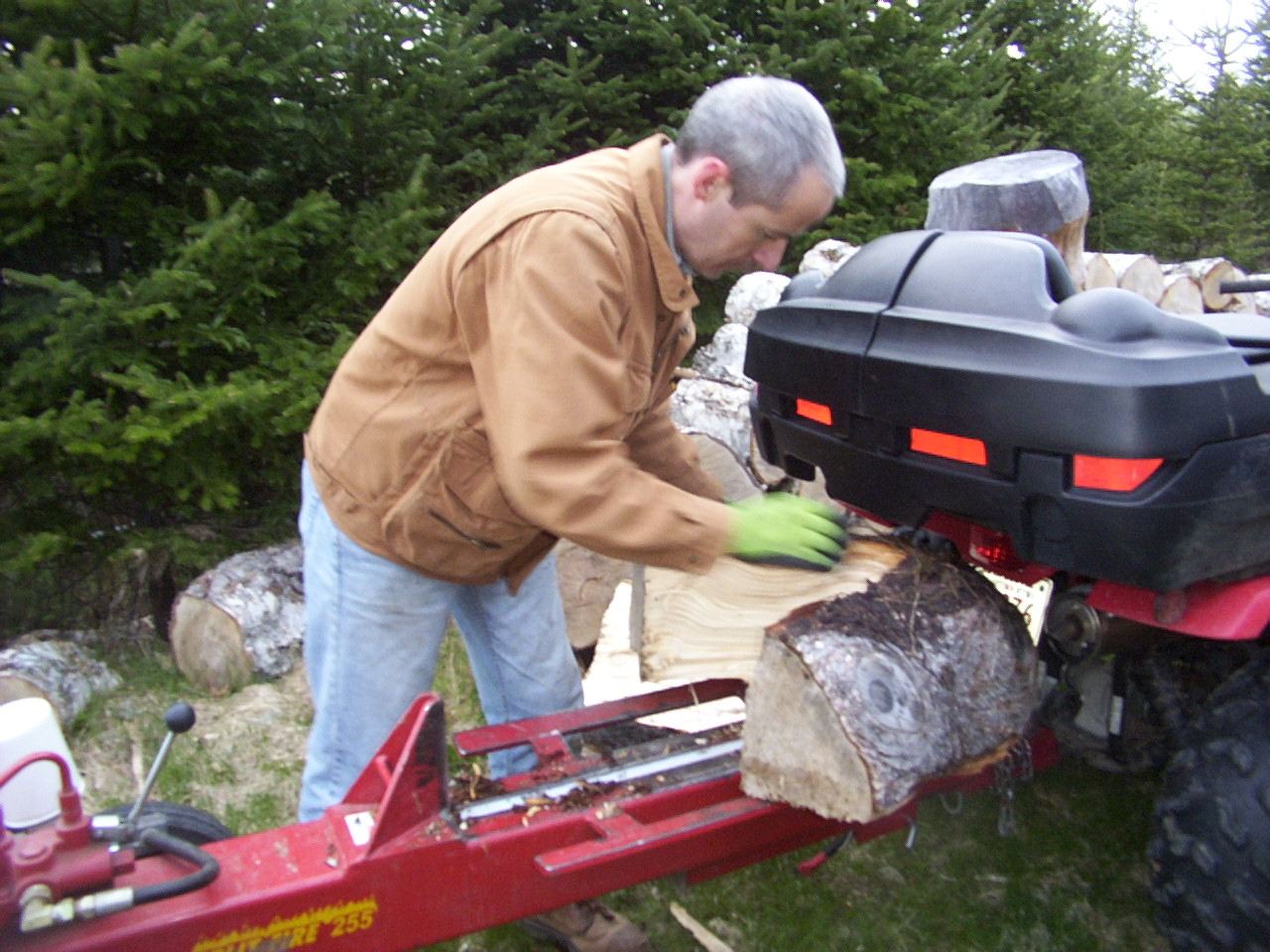

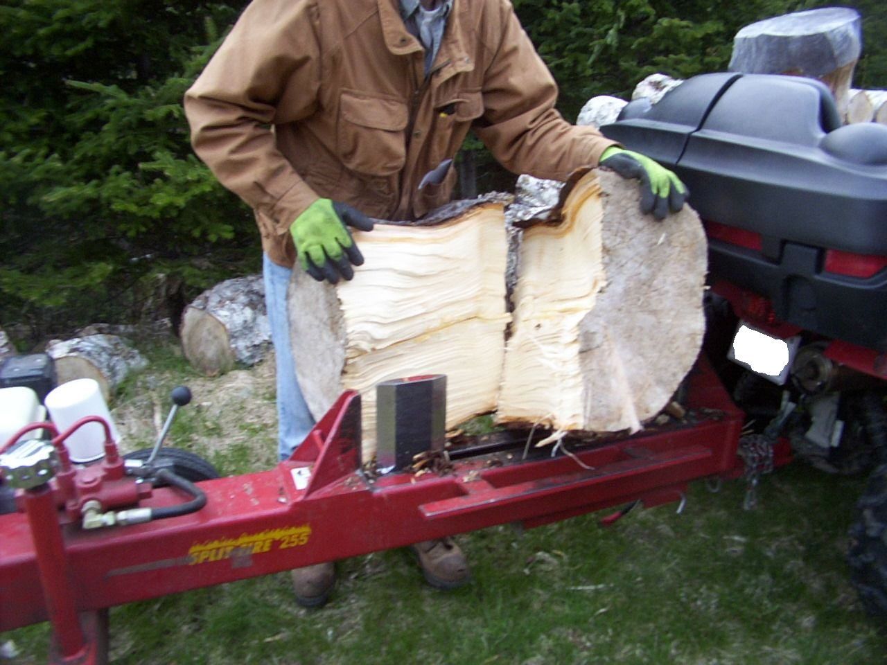

I think the conventional 4"x2" 24' should be ok,,it's about 21 tons on the pull and 13 in the retract,,plenty for maplw which is what I will be burning
The premise of this splitter is the cylinder is mounted inside a length of 6"x6" 1/4" wall H.S.S tube,,the ram is conected to 7" length of 5"x 5" HSS covered with 1/4" UHMW and guides down the cycle with very little play ,,the actual axel mount is the tank,,the log stop nearest the valve is fixed ( welded) and the one at the front is bolted down,,this splitter is unbelievably fast

There's some truth to that however I believe with the Splitfire design, that's not an issue. The distance between the ram and that lowest contact point of the wood is only a bit more than the thickness of the square tubing that the ram sits in. The one I have will split no problem, no matter the wood.
