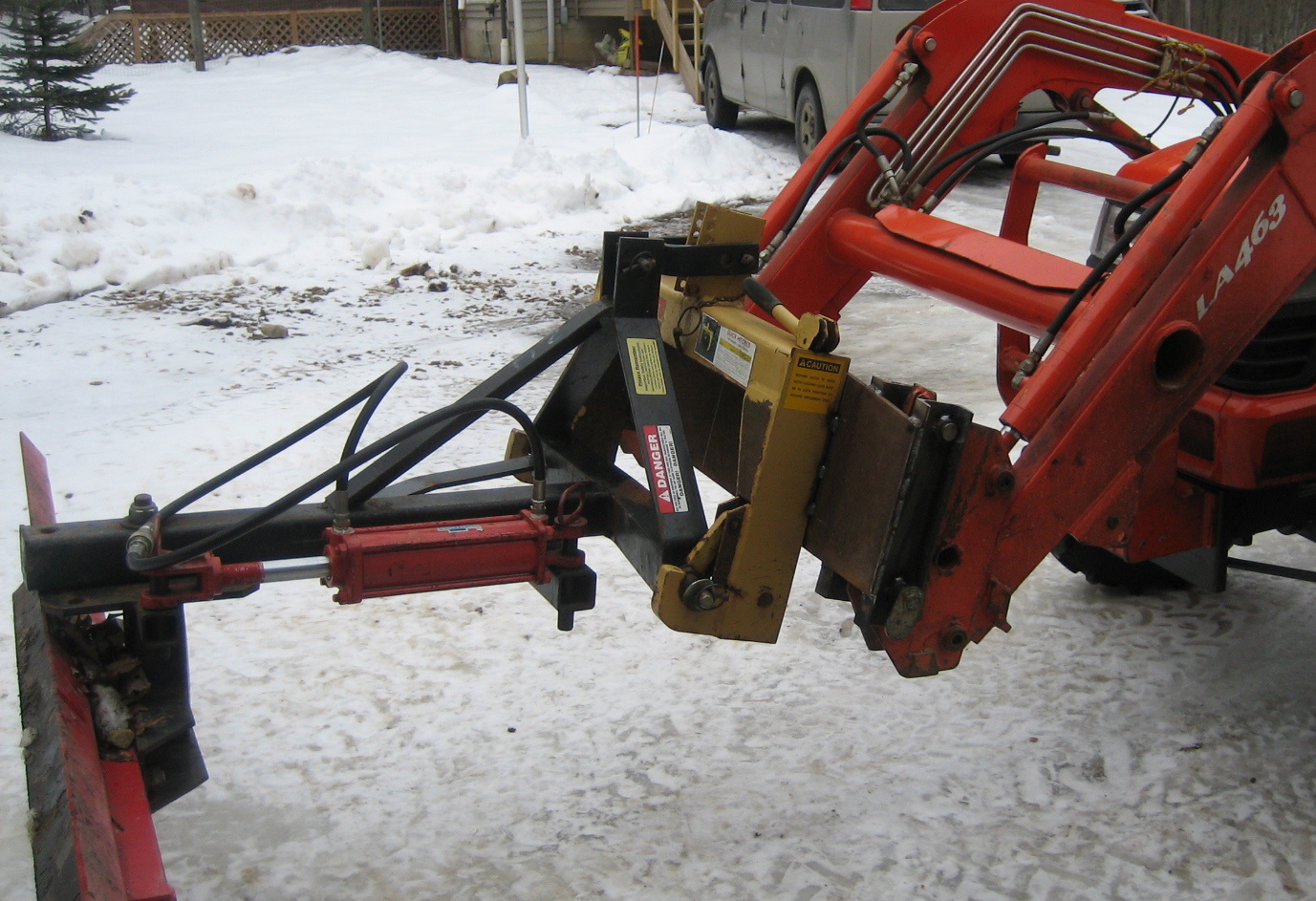

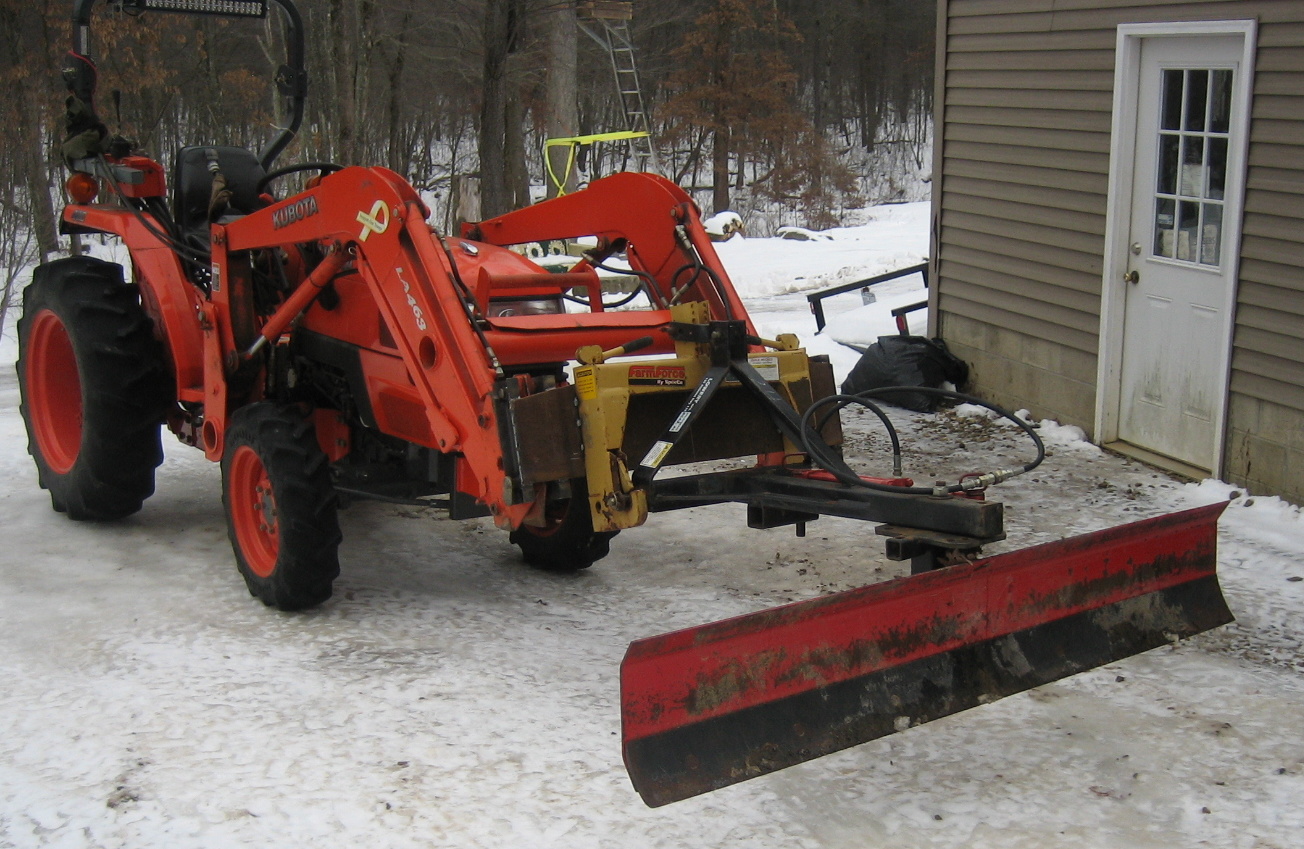

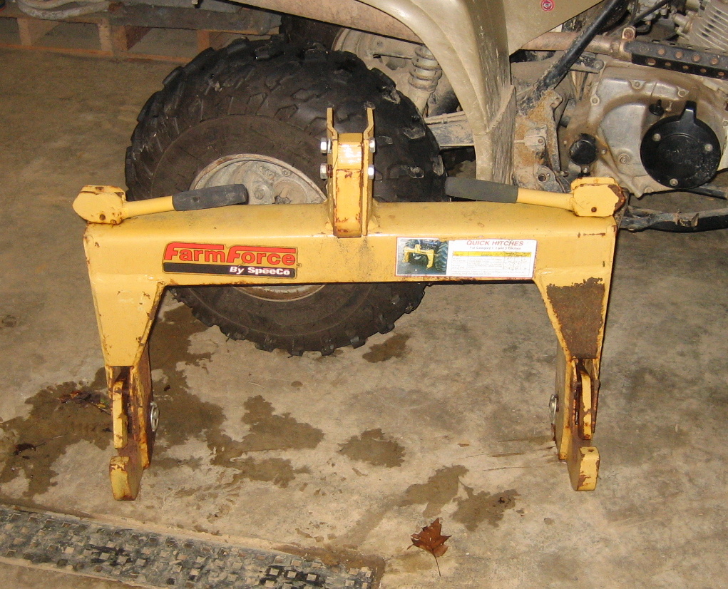

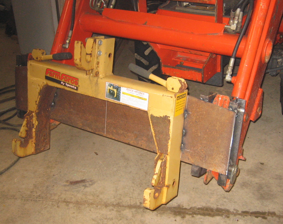

I had a Speedco quick hitch laying around collecting rust. A few beverages in the shop on a rainy night got the creative energy going.
I mounted it on to a steel plate and fitted it to mount on my pin type quick attach.
I use it for pushing snow banks over / back from plowing. At ground level, cool. raise it up and I
can feel the leverage a bit. Works great for plowing small amounts of snow.
NO I do not have any obstructions to run into and only use it on my property
and use the box blade for counter weight.

Looks like you missed all of the past posts about adding extra rollback.
Other than not enough rollback angle it looks gooder-un. :thumbsup:
