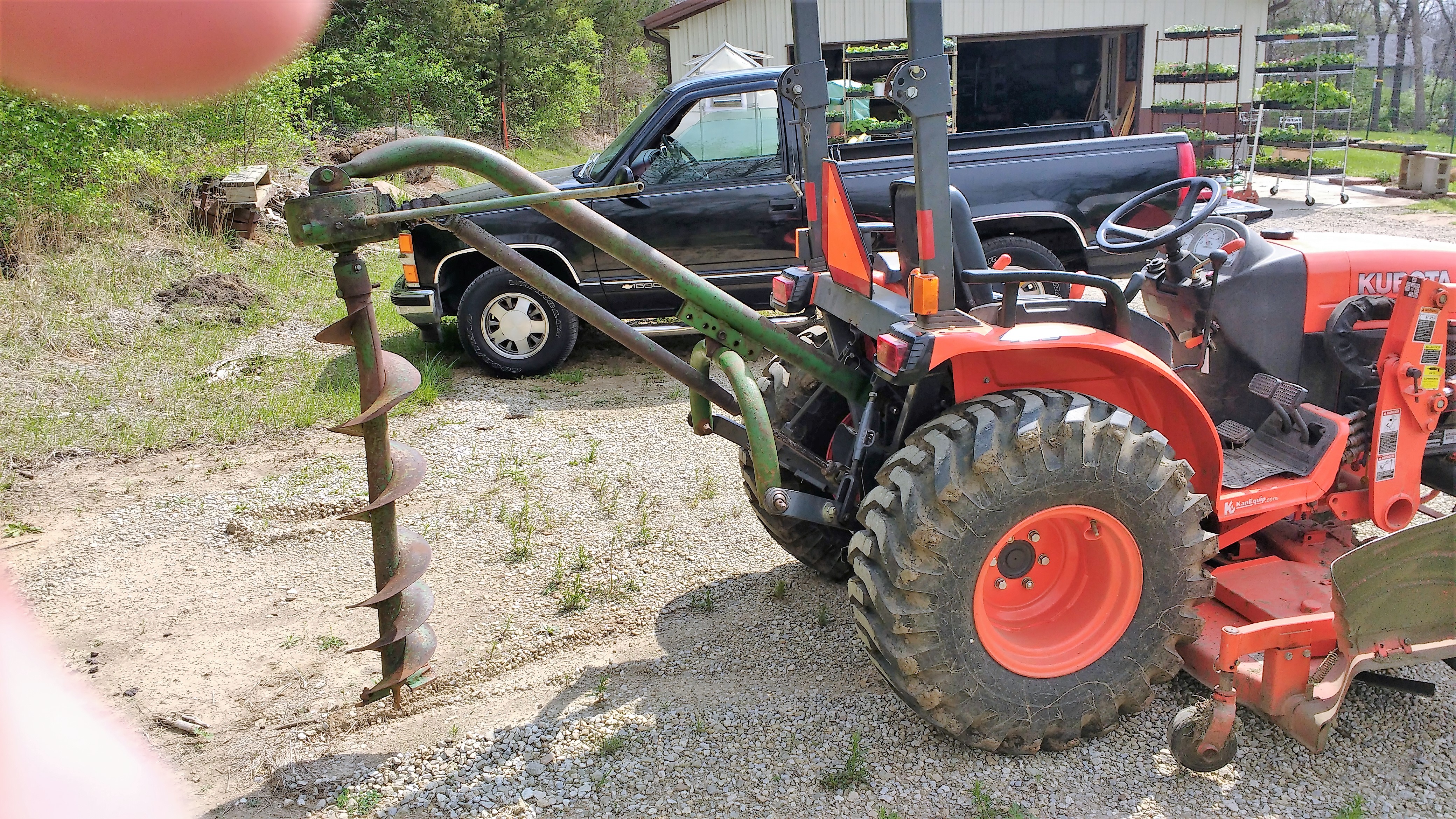

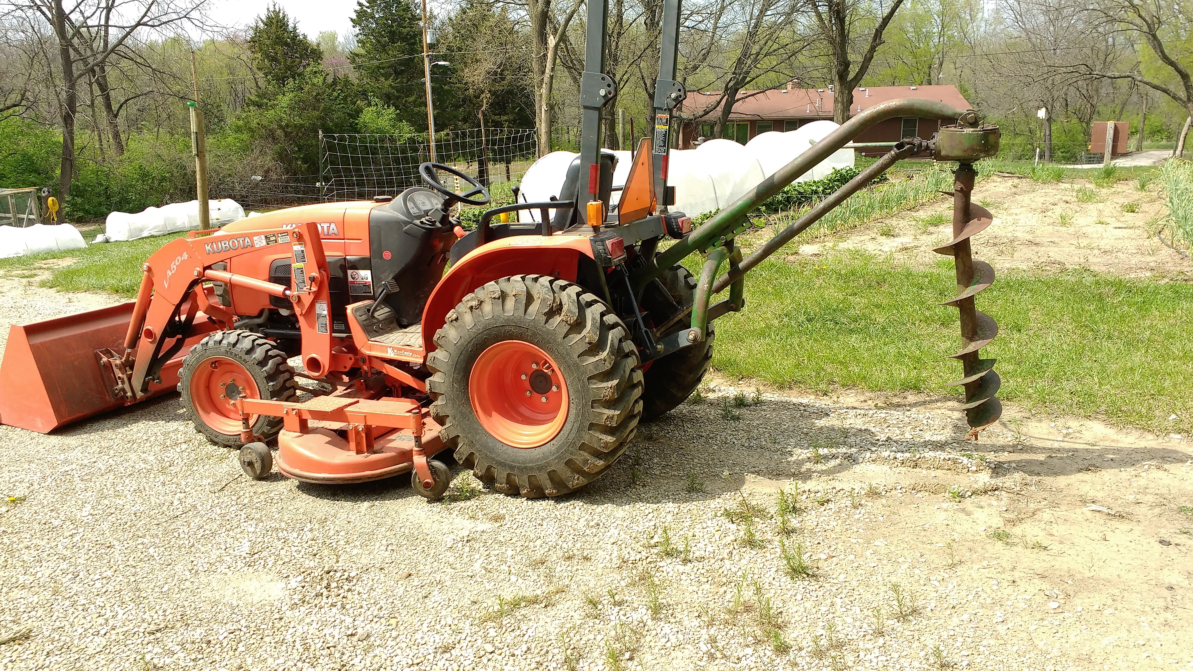

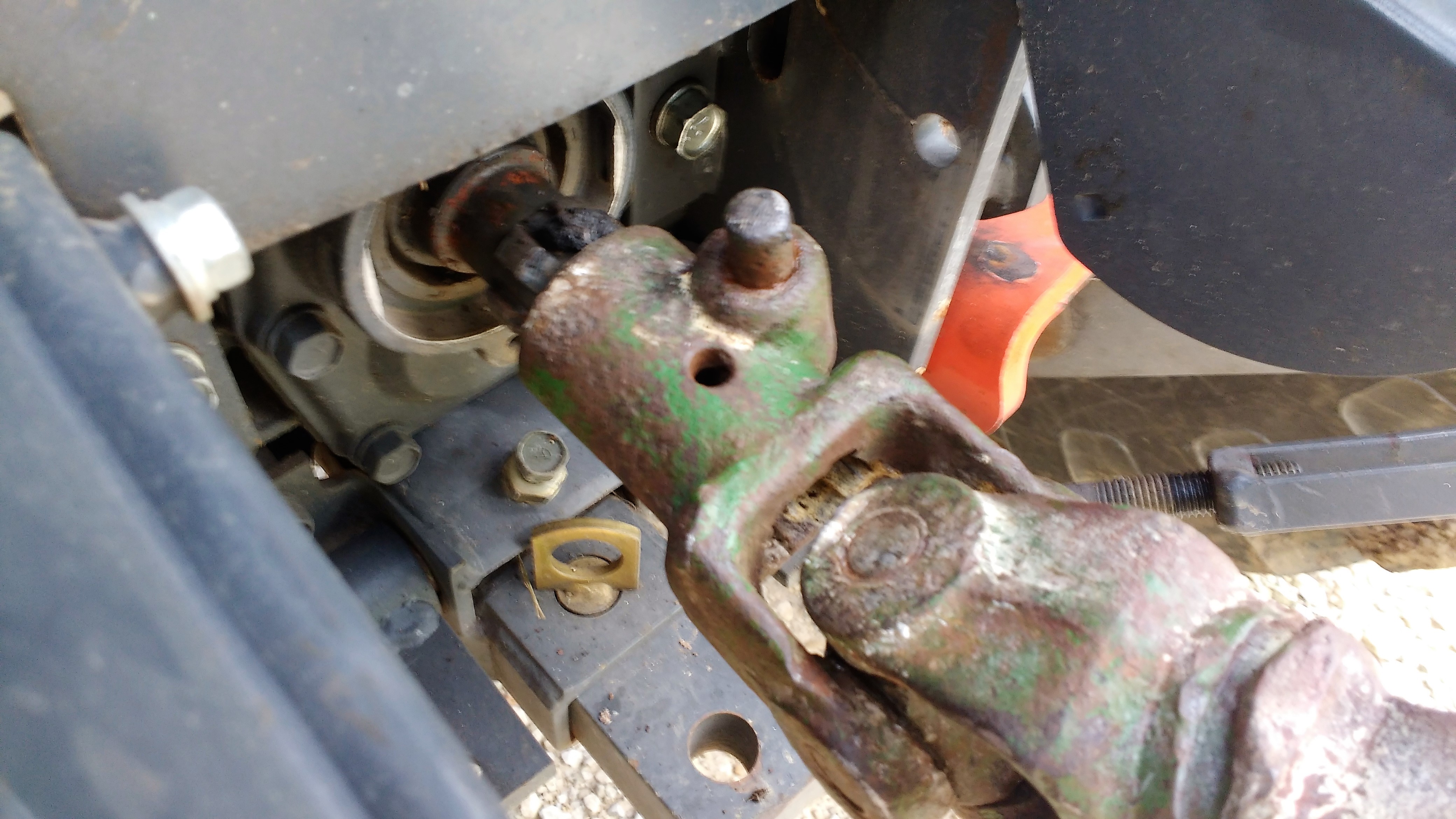

Thanks Fallon! Yeah, I have an old relic that I just bought cheap & it's (9") auger is bent & the PTO coupling will need replacing. Not sure if the auger can be straightened (some here thought it could be for around $50). TSC has an auger that fits (9"/$130). Ran across the Speeco & thought I'd offer $300-$350 at auction for PHD & both augers. I can easily sell the old one the way it sits. Any PHD I have won't see much action, so I hate to pour too much into one.
