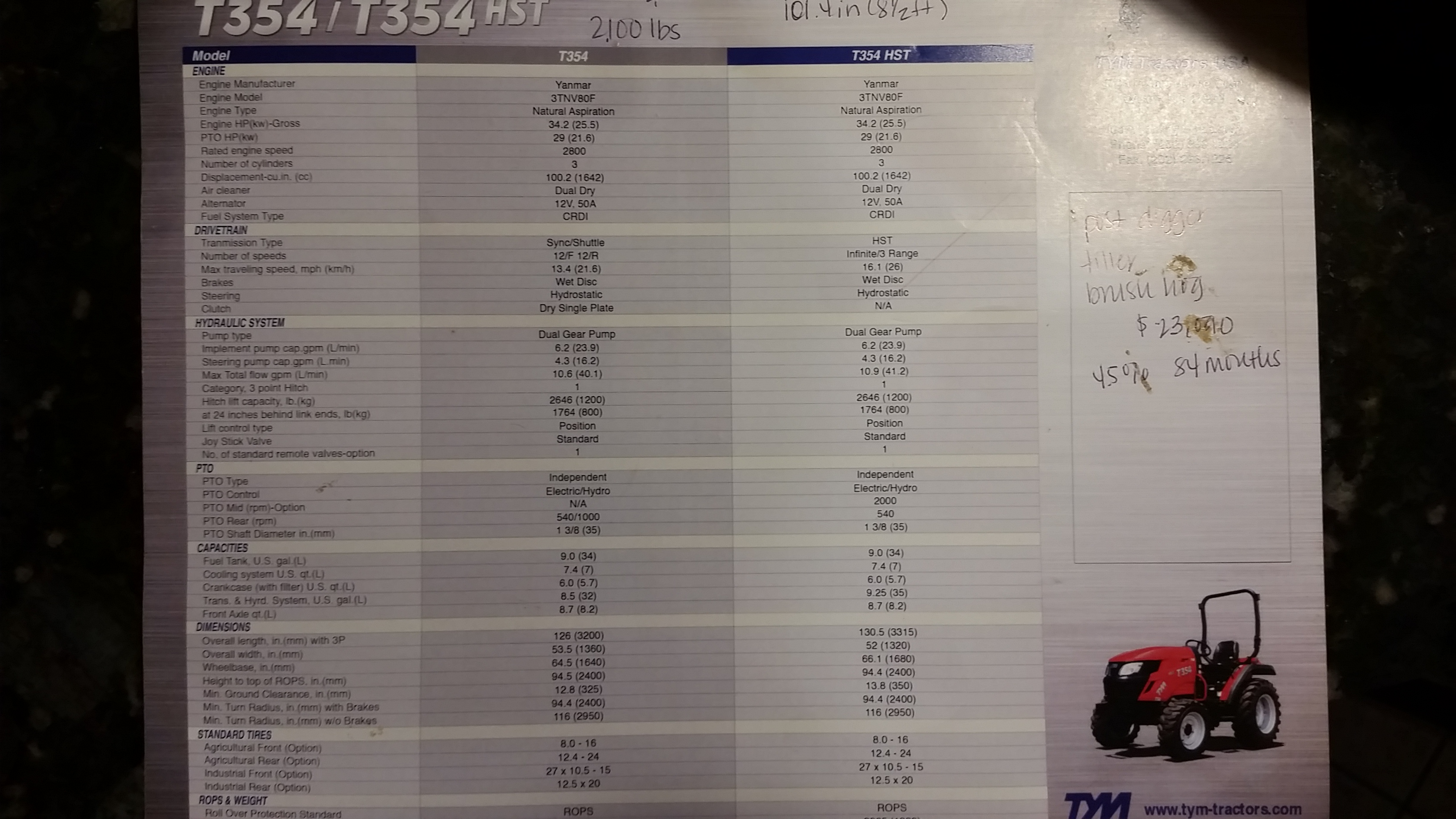

That's what I thought too but my brochure has two different categories by transmission. They both were rated at 29 pto hp and now even the manual transmission is rated less than 29 hp at the pto.

Yes they were both 29 and I have never seen a tractor with HST and shuttle transmissions have same PTO hp. I think they made a mistake. The shuttle is now rate 28.1 hp. Seems they rounded it up or things have changed.

The metric ratings have always been included. Go to the website and look at the power specs they have listed now. They're different from this brochure that is only a few months old.

As far as European ratings go, are they quoting 550 ft-lbs/sec HP or Metric HP, or P.S., C.V., kW, or what? Most Europeans like to claim they have a central metric system, but the last time I bought Italian Test Equipment in the late 1990s, the air flow was quoted in Normal Liters, not cc/sec or m^3/min, or anything lese standard in the normal metric system.
I'd suspect they are using different units rather than changing the HP rating.
30 SAE HP is 30.4 cv or ps or metric HP, but is only 22.37 kW. Many times Europeans give power in kW. I personally don't care as long as they tell me the units.
