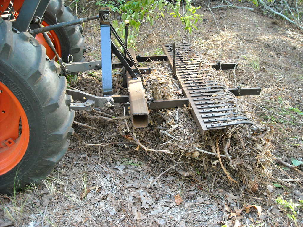

You can tear up anything if you try real hard. :D Since I built my 5' rake a few weeks ago, you can quickly see how they work. If I drag it over a small stump, a couple of the tines will pop over it. If I get it caught on a vine, it'll eventually break it or the vine pull through the space between the tines(mine is 1.25"). Even though I used 5" channel on mine, I guess my simple design would avoid bending the bar. With most of them that pivot in the middle there is a lot hanging out there. The one posted in the Ebay link looks plenty strong even though the tubing doesn't go all the way out, just a little unsupported angle.
Unless you wack it against a tree, or its 8' wide with little support, most ImO should be plenty strong.
I love my rake for doing just what you said.
Good Luck,
Rob

This is interesting to. When I first used mine it puts very little load on my tractor. On a hard surface I move the 3pt lever all the way down and it just rides along the ground. I thought the tines would catch and "pop" all the time, not so. If you have a lot of limbs, it doesn't take long to fill it up and stuff starts getting under the tractor, time to dump. I even hooked up with a couple 4" dead trees, no problem. I ran it in the garden to clean it out, the sand would pile up a little but quickly filter out if I raised it a little or got back on the grass.. Hard to believe they get that expensive.
