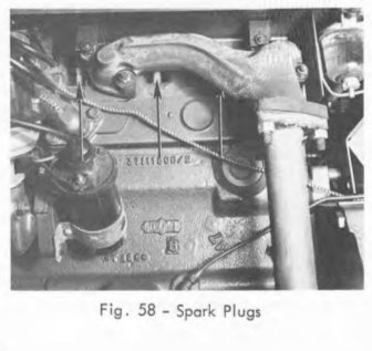

1974 Massey Ferguson 135, 3 cyl Perkins gas. A few days ago in the rain I need to put out some hay, but my tractor wouldn't start. I replaced the points and condenser as well as the coil a few months ago. Both are sparking. However, the plug wires are ancient and chewed up by mice, so I figure I should replace those along with the plugs. I see the location of the spark plugs on page 40 of my operator's manual (I couldn't see them by looking at my tractor). I can't figure out how to get to the plugs to replace them and the wires. Do I have to remove the gas tank? If so, what's involved in doing that?

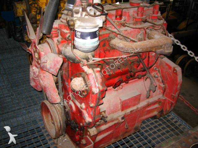

I photo of a removed perkins engine to see where the plugs are.

Thanks for the suggestion and photo. I think mine is different than yours. Mine has the same arrangement as the photo below which is taken from page 40 of my operator's manual.
There is a flat metal piece above the exhaust manifold--heat shield I'm guessing. It's super cramped and I can't see how to get to the plugs and wires. I thought maybe someone out there has dealt with this before and would know what the best method of access is.

That looks like a Perkins diesel. Note the fuel lines and no plugs or wires.

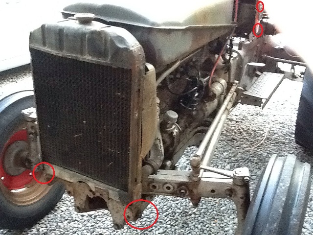

The Perkins both gas and diesel open on opposite sides (hood) if the plugs are behind the side logo you have have to partially remove the sheet metal in one piece and tilt it forward to access the plugs. Never done a Perkins gas. But if the plugs are mounted higher than the Continental then that would be the easiest access. Just a few bolts with the hood shut. The entire front hood, sides and front will tilt forward by removing four bolts (two on each side) and loosening the two in the front.fronthoodremoval.JPG frontoftractorboltpoints.jpg
Mind you one of the pictures is from a 135 Special with a Continintal engine. I would thing the sheet metal mounting points are the same.

The Perkins both gas and diesel open on opposite sides (hood) if the plugs are behind the side logo you have have to partially remove the sheet metal in one piece and tilt it forward to access the plugs. Never done a Perkins gas. But if the plugs are mounted higher than the Continental then that would be the easiest access. Just a few bolts with the hood shut. The entire front hood, sides and front will tilt forward by removing four bolts (two on each side) and loosening the two in the front.View attachment 449424 View attachment 449425
They all mount the same way.

One more thing I forgot to mention if one decides to remove the sheet metal in one piece. Be sure to unplug your headlights wiring and unbolt the hood prop from the fuel tank before you try if so equipped.

I didn't know that whole sheet metal assembly hinged forward like that. After taking another look at mine, it appears that's what I'll have to do. I wouldn't have figured that out on my own. Thanks. It looks like it'll still be tight maneuvering even if I get that out of the way, but it'll help a lot. The spark plugs are on the "driver's" side where the hood opens up, nestled inconveniently between the gas tank above and the heat shield below.
Thanks, again, also for the tip about disconnecting the headlights and hood prop!
