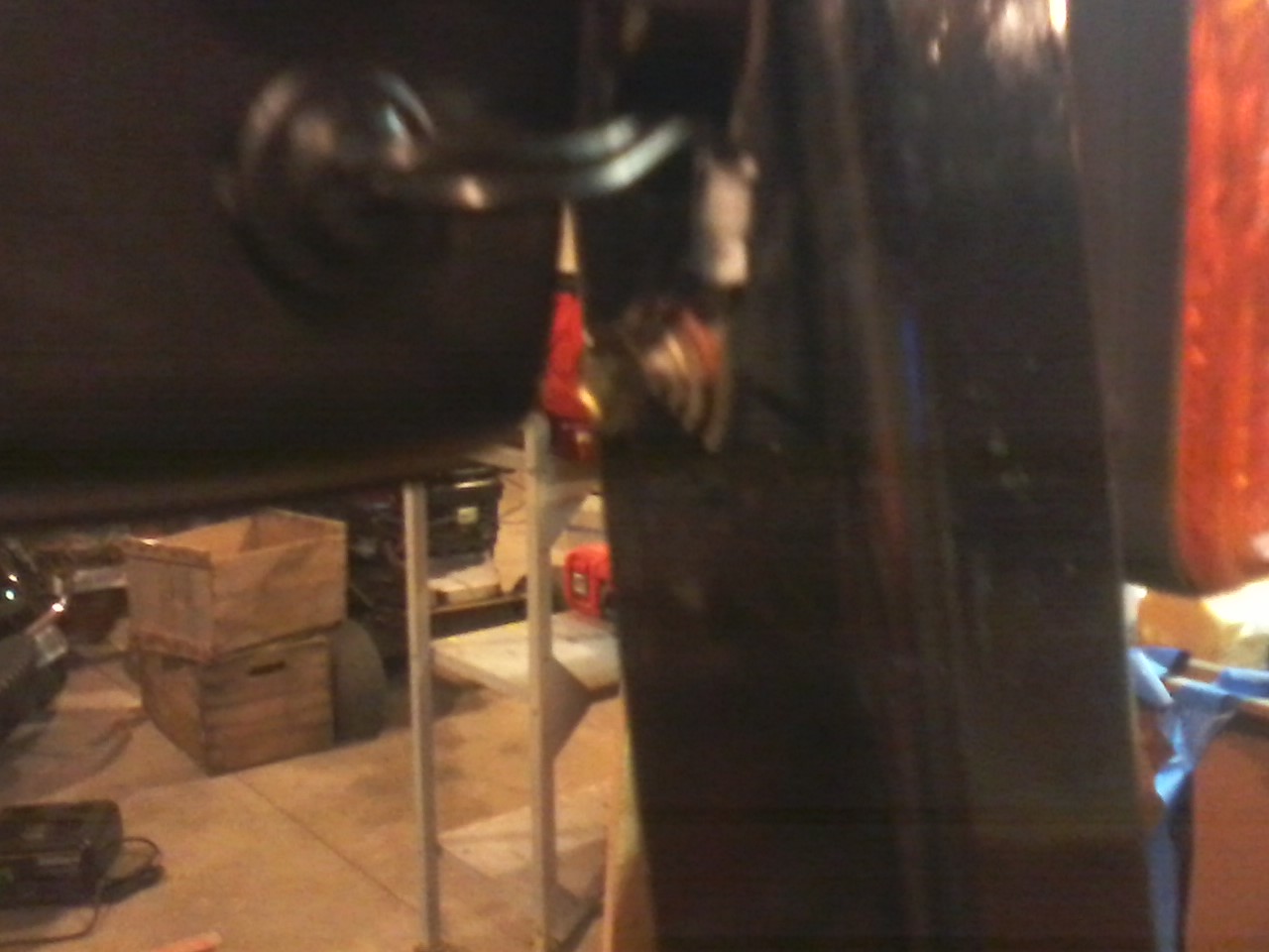

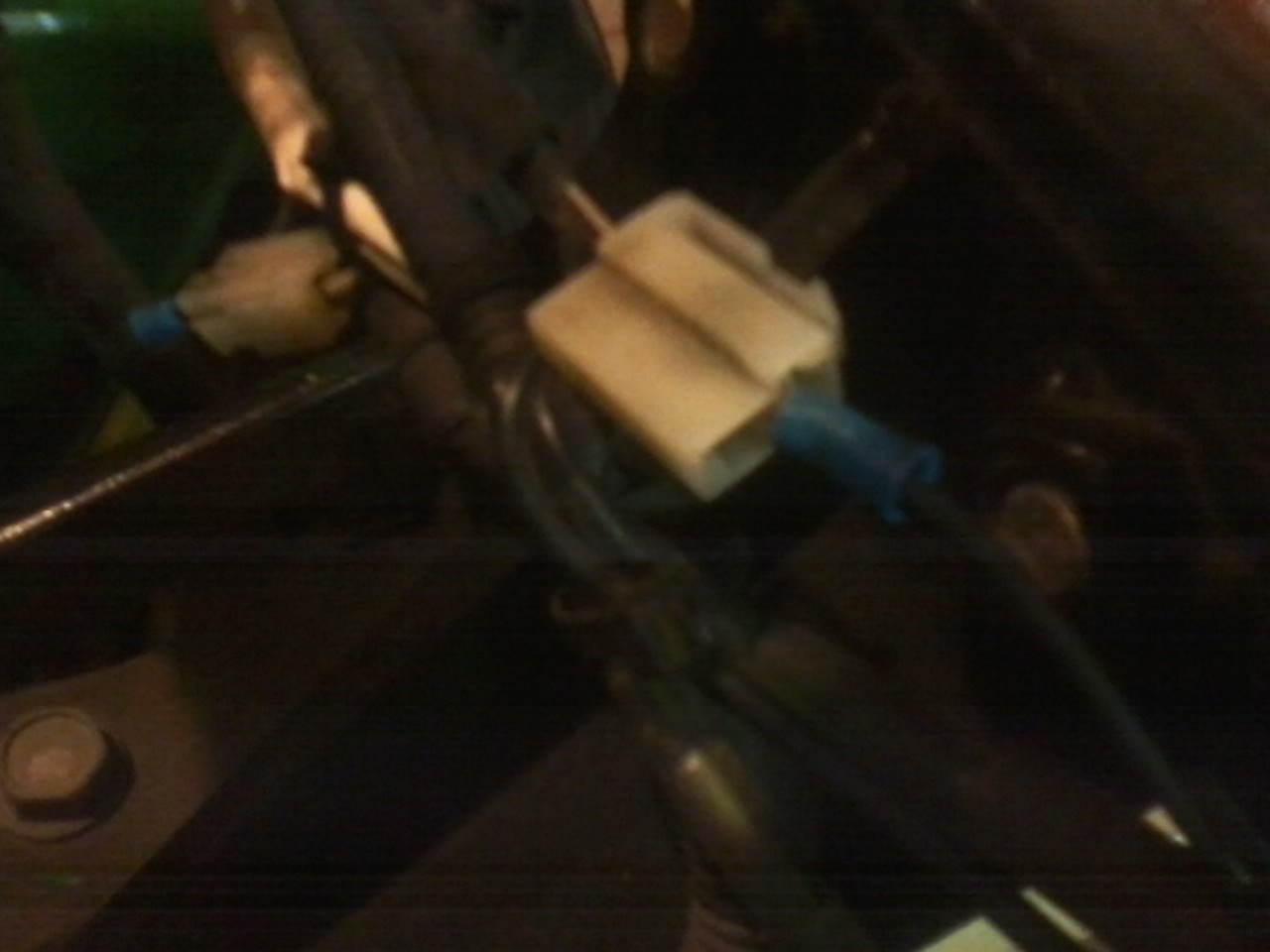

Anyone know what these are for? They are electrical plugs/connectors. I found 2. For extra lights? Thx

On my Yanmar built Deere there are 2 two bladed plugs that are live with the lights on position. (for xtra lights)
Do you have a multimeter DC voltage to test for switched current?
   / Spare plugs in back of yanmar ex2900
Yes, I will test tomorrow. I would like to get some of these plugs for wiring up led lights. Are they common or a dealer item?
   / Spare plugs in back of yanmar ex2900 #4
Personally I just used the female half of a 16 ga (blue) insulated crimp on spade connecter to tap the hot blade. The lights themselves are grounded to the ROPS frame with a short piece of wire and ring terminal. Been like that for 15 years now but I'm sure matching plug connectors can be found somewhere if that what you want.
