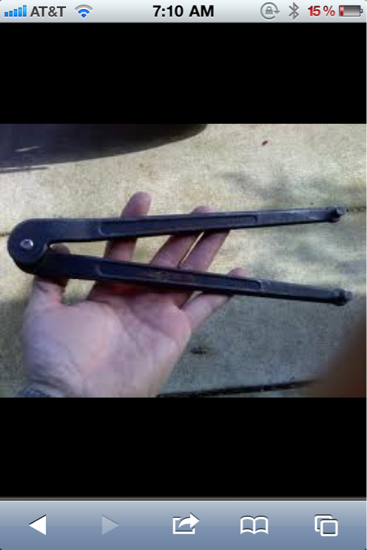

This is a snap on spanner wrench

If you can, find out what SPECIFICALLY he plans on using this spanner for.
Massey Ferguson, being deeply rooted in the UK at one point, refers to common open end wrenches as "spanners". There is even one particular spanner, known as a "plow spanner" that is somewhat collectible. (I've got a few of 'em) It's an open end wrench with graduated inch marks on its length. It's used to make adjustments to a Ferguson/Massey Ferguson plow, as well as to measure plowing depth.
Another spanner that comes to mind is used to pre-load the draft control spring lock nuts. It does have "square" teeth which the spanner engages.

Maybe you're looking for a Hook Spanner..??....used for the external lock ring on some cyls..??
MSC Item Detail

A round pin will fit in a square hole. If its a good fit and the nut isn't super tight it should work.
