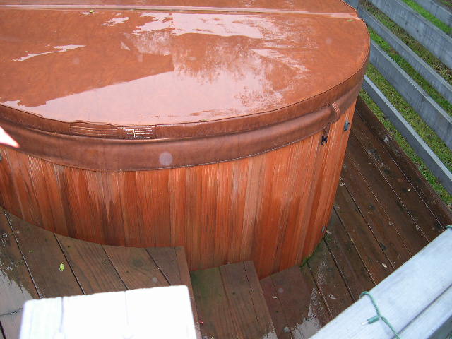

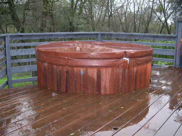

   / Spa Deck Requirements #7
I will add more description of what we did. Our spa is round. We had it 1/2 inset to the existing deck. Part of the deck railing was removed, and a second deck, which the spa actually sit on was added. There are two steps down to that lower portion, and it has room to walk around the spa; the maintenance panel is on that side of the spa. Railing was added to match the existing deck.
Hopefully the pictures are worth a 1000 words /forums/images/graemlins/grin.gif
   / Spa Deck Requirements #8
This kind of shows the steps and lower deck. Note lower deck is still a couple feet off the ground. It also goes under the existing deck, and has structural suppot tied to the main deck.

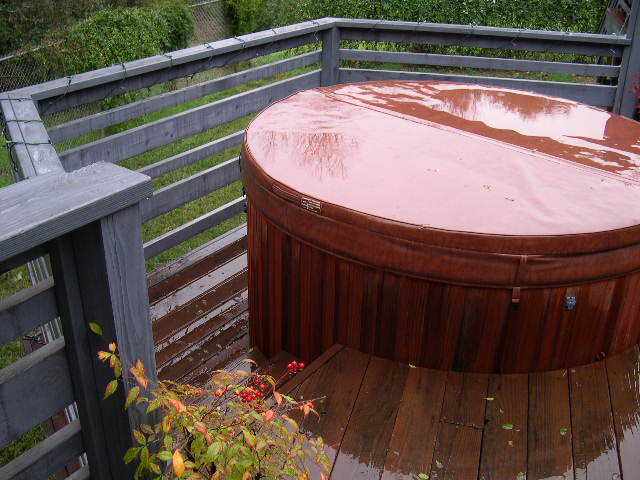

   / Spa Deck Requirements #10
Here's a picture of our spa mounted on the ground but extending through the deck. The platform behind the deck allows us to slide the cover off without having to lift it up.
