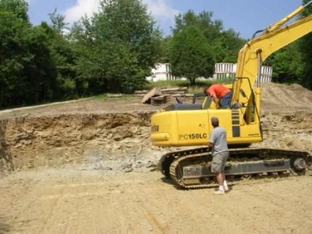

We've started our concrete home. Well, the basement has been dug. It took quite some effort since 5 feet of the 8 feet hole was sand stone. The foot print is 54' x 70' for the main house. The house is two stories on a basement. It will have a flat concrete roof. The walls are 8" concrete core ICFs. The fun has begun.
