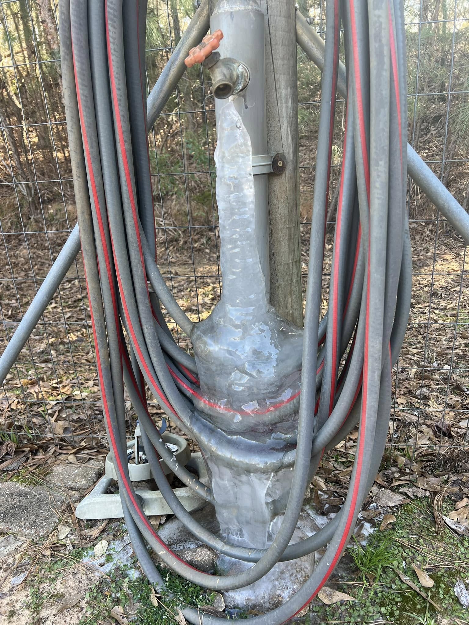

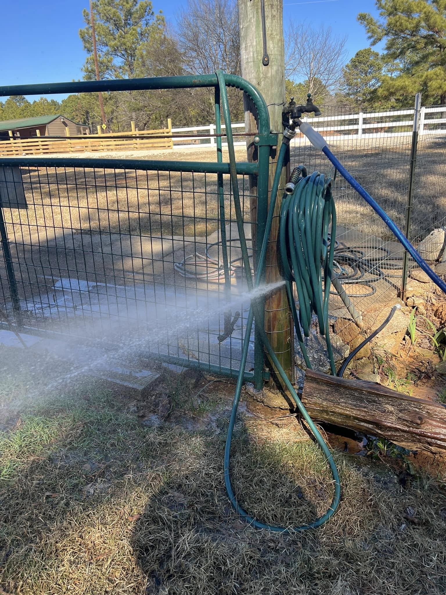

I think it's odd, and maybe a bit funny, that here in Tyler Texas, we are too far North to get any snow!!!!
Unfortunately, we did get the cold and some of my older water lines in my yard failed from the 14 degree temps that we woke up to. I'm replacing the PVC and the Copper with PEX. That seems to be the only thing that can handle our cold snaps when they happen.

Sorry about the (bad) breaks. I insulated all the outdoor PVC with 1.5" foam starting underground and going up, but I doubt that it would handle 14F, and even if it could, the hydrants aren't self draining freeze proof types. So when we have sustained cold forecast, I have to drain my outside lines.
I would point out that PEX cannot handle UV exposure, so it will need something around it to protect it. Here, it is flat out forbidden to use it outside due to the UV risk.
Black polyethylene tubing might be a better choice for outside water lines.

Thanks. What's sort of interesting to me is that these lines survived the big freeze that we had a few years ago when temps got down to -8 and never got into the 20's for a full week. I had other lines break on me, but not these two.
The one with Ice has been there for at least a dozen years. It's Schedule 40 PVC wrapped in foam insulation, inside a 2 inch PVC pipe that I used as a sleeve. I sort of thought I had it figured out with that combination, but I was wrong.
The other line is Type L Copper, which is what I used in several other outdoor spickets without issue, that also survived the big freeze a few years ago.
I have two spickets that are blue colored PEX that come out of the ground, and up a wood fence post that seem to be fine. I like the idea of protecting them, but I haven't thought of a good way to do that. I'll have to think about that.
For the two that failed, I'll dig down to the supply lines, install a PEX fitting, and run PEX back up the wood posts.
I wonder if snow insulated them when we had the big freeze? We had about six inches of snow when that happened.

Snow is pretty good insulation in the grand scheme of things.
PVC is also such that it can get stressed and have cracks without complete failure, and then on a subsequent flex, or cold snap, it fails. So, I think that if these two survivors made it through the last few cold snaps, that they were probably on borrowed time.
I also have valves that enable me to depressurize the lines that are at risk both to allow draining, but also to minimize water loss in case of failure. The valves get closed when we are at risk of freezing.
FWIW: I have taken to running pipe up out of the ground, insulating it, and then dropping a large diameter pipe over the whole lot and spraying urethane foam in the top to keep out water/bugs/rodents. Our horses and cows don't seem to gnaw on a chunk of pipe the way that they do on foam covered in pipe wrap. If I need a 90 at the top, I drop the guard pipe on before I put the 90 on. Here, anything that is PVC and above ground has threads and unions for rapid repairs. Yes, I know that it costs more upfront, but not overall if my time is factored in.
