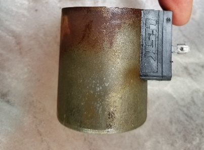

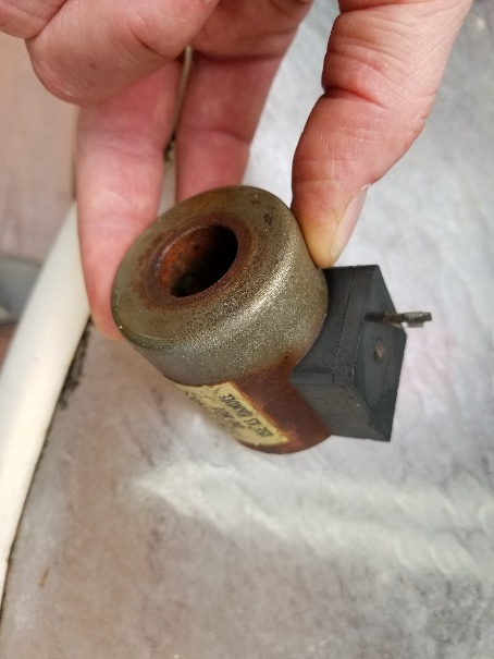

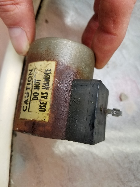

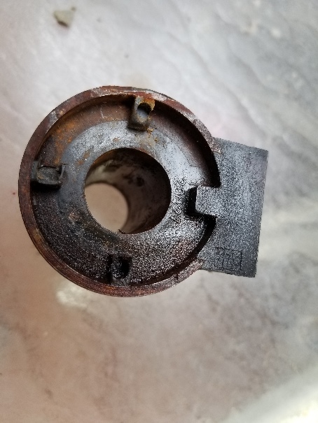

I am looking for a source to get a new solenoid coil for my dump trailer. The down direction won't work. It says Lisk and has a number on it, 20427. From my googling it looks like it's an SPX/Fenner 2001405.
It is 2.125" long, has a .750" hole in the center, and a single spade terminal.
I have found a few places that may have it, but are very expensive or the site seems a bit shady. Just wondering if anyone else can suggest a place to look for it.

SPX Fenner is still in business based in Rockford, IL. I believe they have distributors in all of the USA. You could also use a dual spade coil, just connect the other spade to ground.
