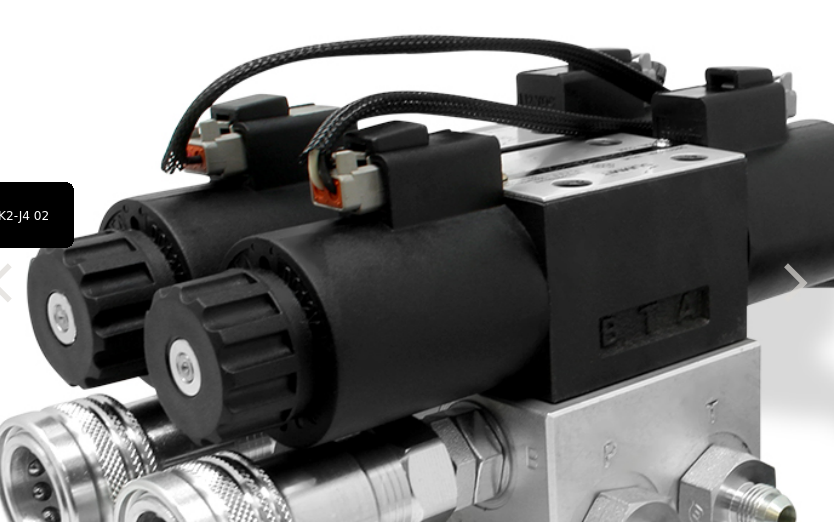

I need a D03 manifold & valves with slightly lower height. The common style with "DIN" connectors is typically about 6.5" tall - slightly too tall to fit where I'd prefer to mount it.
The best option I've found would be these, with "Deutsch Connectors". The lower total heigh, around 5.5", would fit fine.
I can't find a source. Summit sells them but only as part of a full kit which I don't need and is 2x the price. For stand-alone D03 manifolds & valves, they only sell the DIN connector style, and won't substitute.
For reference here's the (taller) "din" style
Specifically I need a 3-valve series manifold, all hyvair 2c flow (Tandem Center), if that matters. I've chosen industrial (Dxx) valves over a monblock or cartridge or here because
  • I don't want the unpressurized cylinder return flow to dump-to-tank (need it all flowing out the "power beyond"port - all monoblock valves i can find do support PB, but only route the cylinder 'exhaust' to atmospheric]tank port),
  • the Dxx valves have significantly lower pressure loss / waste heat than say cartridge valves when in center position. (and I can't find an easy source off-the-shelf for series-plumbed cartridge valve manifolds - seems the market is all custom applications?)
  • a totally different style (wiring out the end of the solenoid?) would be great, too, i am just not seeing anything
Thanks!

Have you already purchased the DIN valves? If not Eaton - Vickers, Parker, Rexroth all have Deutsch connector options.

Thanks, that's at least the right model, and for sale with a price! FWIW, I had searched bailey's and grainger and surpluscenter (plenty of valves, no Deutsch as best i can tell). Also, Hyvair has a sku for these, D03sds (vs the typical D03s; and they also have a bare-lead version D03L which would be even better) - but I can't find them for sale, at least not through my online search.
I understand places like Summit can likely get very good prices by either going abroad, and/or just selling a decent number of a limited set of skus ... but at 3x$225 + ~$200 for a manifold; that's roughly the same price as Summit sells the whole kit (brackets, fittings, harness, switch); Hoses are probably throw-away for me, but much of the rest is usable.
How's the quality of Summit parts? Any suggestions on cheaper options for what I'm doing?
