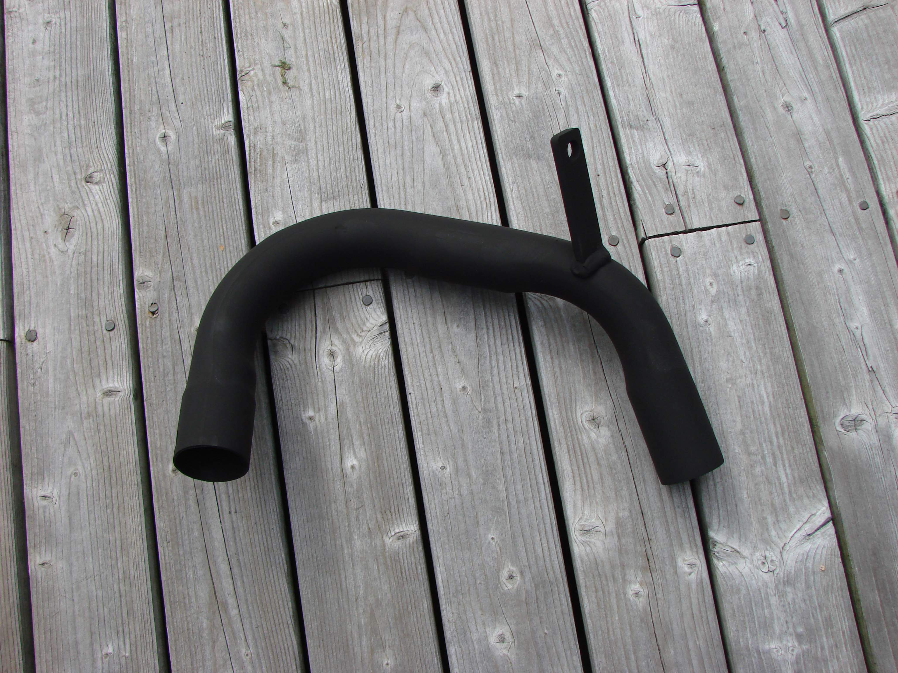

It's been bugging me since I bought the tractor last year. :mad:Every time I start the thing up the soot blows all over the FEL. Every time I use It I have to get the Spray Nine out and then clean it up.:mad: Some times it's hard to even get off so I needed to do something about it.:confused:

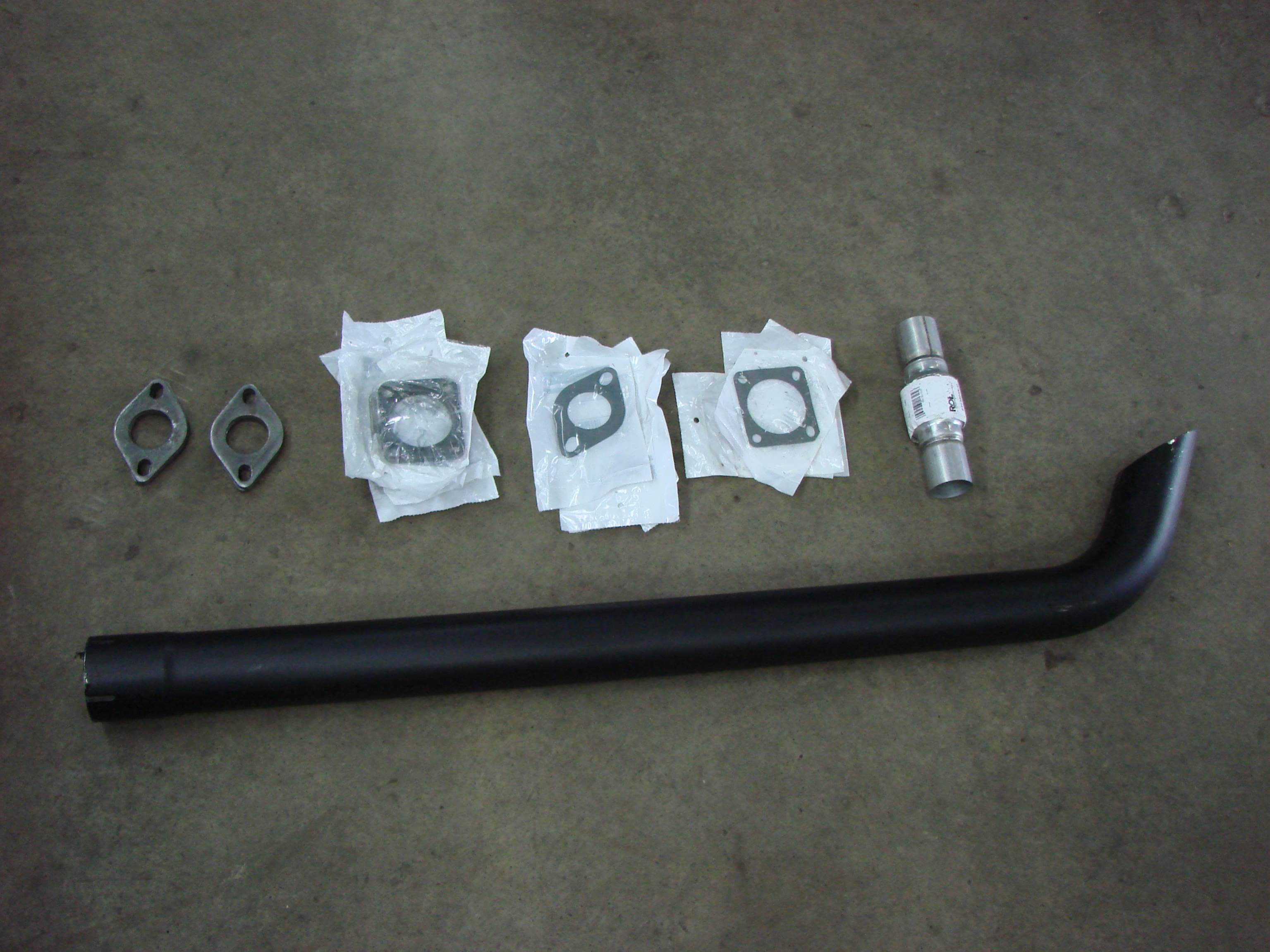

I had planned on installing a stack. I purchased all the parts. Did the machining on them and thought that maybe it could be a little overkill on applying all of this so I decided to take the simple approach first. The main goal is to keep the soot off the FEL. My tractor is a cab model and it takes the fresh air from the top rear portion of the roof so I got some pipe and bent it back under the tractor pointing a little down so it's not on the ground or pointing towards the bottom of the tractor.
During start ups it's great. I don't smell any fumes and there's no soot on the FEL. Snow will soon be here so It will get the real test then and if I find a problem I'll go back to my first idea of installing a stack. I don't think this would work on a tractor with out the cab because you may end up smelling the fumes. Here's how it looks.

I put an angled extension on the B7610 I had before partly to keep the exhaust off the loader arm but also because I was using it a lot as a wheel barrow, loading the bucket with pavers and retaining wall blocks for landscaping I was doing. I would have to shut the engine off, even if I wanted it to warm up, while I was loading because it would blow exhaust in my face. The exhaust on the B 3030 is turned down more but does still get soot on the loader arm. The exhaust is a different size so the adaptor I had for the B7610 doesn't fit. It might not work anyway given the different angle.
Your adaptor looks good, since it has its own support it should be okay in the snow. Nice bender, by the way. Makes it easier to turn ideas into reality.

I got a little over 20 hours on the tractor this past week plowing snow and I'm very pleased with the extension. No fumes in the cab and no soot on the FEL. I just got tired of cleaning the black soot off this tractor. I'm a happy camper now.:D

Nice work 4shorts!- I've been reading up on all your projects and you sure do great work.;)- I wish you lived close to me.( like next door or something):D
Had the thought crossed your mind of running the exhaust up the top and using stainless exhaust ?
Your tractor looks great!;)
Thanks Low Bucket. Glad you like my work. In my business that's what counts. Right now I'm restoring a 1969 Honda Z50 Mini Trail. I'm actually painting the tank right now and waiting between coats. I thought about many different types of exhaust systems and like I said at the beginning of the thread, Sometimes simple is best and so far this is working out very well for me. Good idea you had as well. Thanks!
