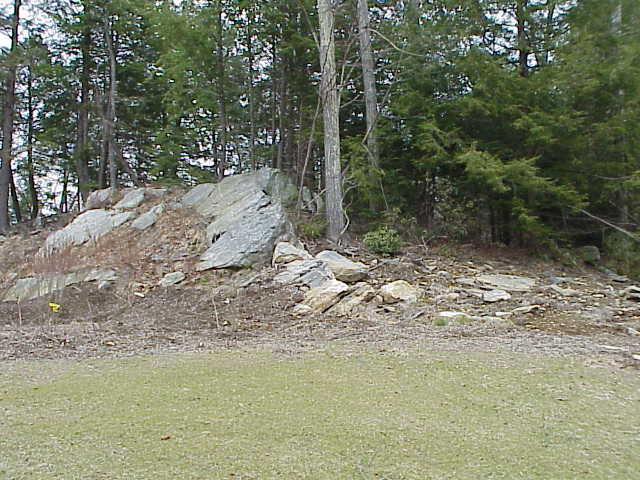

Bird.... Once he said that he has good digging soil, I feel that the BX will do it. I used to live in NH and I know that they have rocks that are better described as boulders the size of Volkswagens and those are the rule, not the exception. When they dug the foundation for my home, the contractor used a D-11 and pushed some boulders out that were larger than the blade. When he got down 6', that was as far down he could go because the hard pan was so compacted, the blade just scratched across the surface and barely removed an inch of material. When it came to putting in the septic tank, they said that there was no way that they could get it below the level of the cellar floor. I asked that they try since it was located 25 feet behind the house and in that location, the digging was fine gravel as far down as they went. That is why my septic tank is so far down. The land around the foundation is raised to cover the foundation and the tank is buried deep so the waste line can go out under the cellar floor. If I had known how easy the digging would have been 25' away, I would have moved the house and saved a bundle of money on fill and other expenses. You never know what is under the ground until you dig. You can only guess based on what the surrounding area looks like. This is what my land looks like all around no matter where you look, except that this area has been landscaped and the rest is wooded.

Junkman, I never had to contend with rocks where we lived, either in Texas or when I was a kid in Oklahoma. Now to me, your place in that picture is very pretty, but it reminds me of a time when someone mentioned a picture of a mountain as being "pretty" to my old grandaddy and he said, "Well, what's pretty about that, you couldn't grow a crop there." To him, "pretty" meant flat plowed and fertile ground. /forums/images/graemlins/laugh.gif
