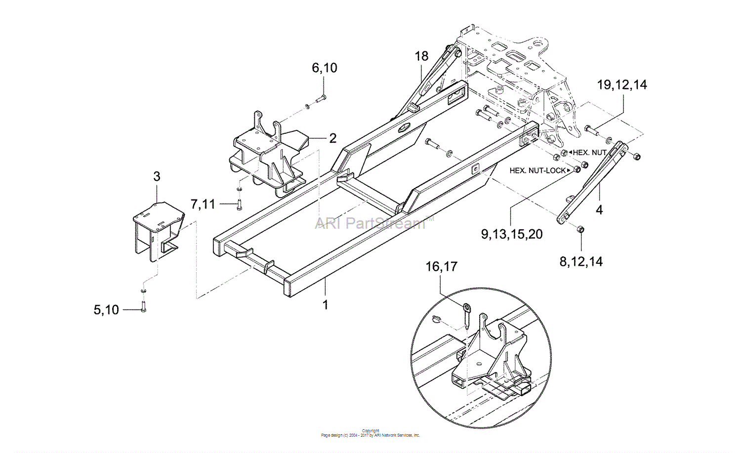

Chat with your Kioti dealer about a major issue with the backhoe, specifically the rear mounting bracket and the associated mounting hardware. Currently the rear main bracket is an "L" shape that mounts both to the underside of the rear axle housing as well as to the bolt bosses for the PTO shield. Kioti is having a problem with that bracket angle being welded obtuse to the mounting angle. It's not sitting flush to both plains leaving a gap between the pto boss surface and the bracket. The bolt package for the bracket is also wrong. The bolts are not long enough. Kioti didnt take into account the thickness of the bracket when sizing the length of the bolts in the mounting kit.

Are you suggesting that all new 2018 Kiotis have this issue with the back hoe mounting system?
Do you have any photos so I can understand this better?
