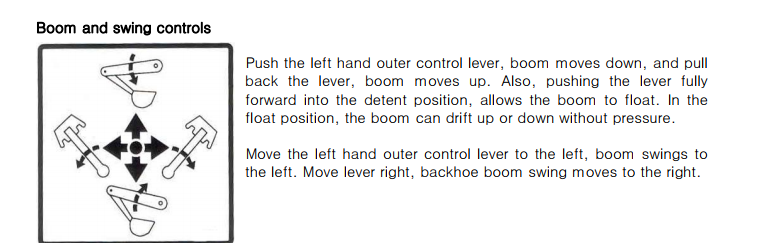

"tomplum", could you expand a little on the backhoe "float position". Never heard of that and which lever or position was that on. I'm brand new to the backhoe so I'm learning it now with my little tractor.
   / Something to watch for the backhoe owners #8
maybe this will help.
   / Something to watch for the backhoe owners #9
Thanks "jdom84" for pointing that out. I didn't read that carefully about the "backhoe" controls. While the loader "decal" illustrates the float it's not there on the label for the laft hand backhoe control. But reading the text for the operation of those controls it clearly talks about shoving all the way forward and initiating the boom float lock. I really apprecate you pointing that out. Thanks "tomplumb" for mentioning it too. Can't wait to try it in my practice today.
Lisa
   / Something to watch for the backhoe owners #10
Well, I guess the MT125 doesn't have a float feature on the boom of the backhoe. Just went out and tried it and it's not there. Although it's mentioned in operator's manual.* Just you gentlemen with the bigger machines got that option I guess.
Interesting idea though.
