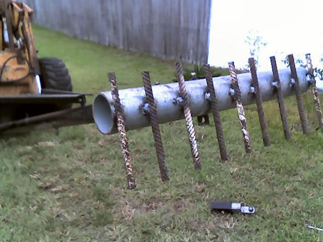

The first is a 30 inch wide rake for pulling small weeds and its reversable
here it is turned over

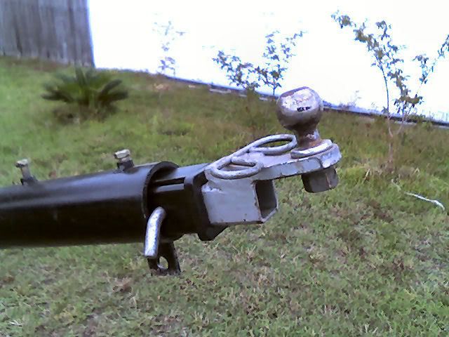

and a simple trailer mover

i give it 2 uses till the 1" rebar is bent mangled or otherwise ripped off the pipe :D
Yeah the way the rebar is Welded, it looks like a few twists and tweaks from the rebar coming in contact with rocks in the ground. And there will be some rebar left sticking in the ground, Waiting for an unsuspecting tire or mower blade to run over.
May want to add a gusset from the Pipe to Rebar.

Well, from reading your replies, ya don't like my 30 minute rake, thats how long it took me to make it. And picture how strong a tool like this would have to be to dig in beach sand. We live in Florida and its nothing but a big sandbar with houses on it. Digging here is a whizz, we have these little sand spur things that have sharp thorns all around them and they are smaller than a pea and they stick to everything. It works great on them. And its 5/8 HSS re-bar not 1" and they only hang down about 6 inches. So far so good. And with my other 10 foot extension it would make a good pond rake, J_J mentioned that when he stopped by.

If anyone wants to make something like the rake but make it a little more stout, why not drill holes in the pipe and run the rebar THROUGH the pipe then weld them to the pipe at the openings? It won't keep them from bending or breaking of course, but they won't likely break off cleanly, either.

Mr Jimi,
I like the rake. The welds look to be a bit short. Maybe, if it fails, you can toss in some weld around the top and bottom edges to make it stouter.
If you had a nice drill press, putting the rod into thru holes and then welding around the top would be nicely stout. But it would kill your 30 minute limit!

Thats a real good idea, I can do that if they come off and I'm sure they will, I just hope my tires don't find them first.
